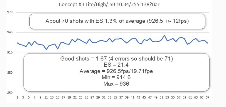

As for the piddly shot count of the Concept Lite.......
That's for a .177, but the fpe/cuin efficiency comes out around 1.04, and that was completely bone stock.
I was impressed with how many shots that little tube gets.
