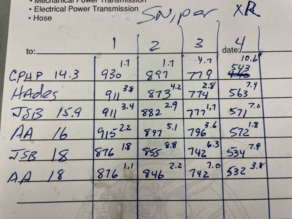

Here is data from my Sniper XR that I recorded today which should be similar to the commander. I only have 4 positions on my power adjuster. Large number shows the average velocity of 5 Shots. The small number is the SD.
What's your reg set at???
Mine came shooting quite a bit hotter than that...my reg is at 150 bar and pushing the 18.1s at 950!
Daystate Howlers 20.3 grain at 897 !!!
James from Michigan
Mine came set at 145 bar and was pushing 18s to 841 on hi. I raised reg to 150 and adjusted HS to get the 18s up to what they are now. Does yours have the magnum barrel? Mine is the shorter standard barrel. BTW, mine really likes the Air Arms pellets and shows it in the lower SD numbers. Does your barrel have a preference?
