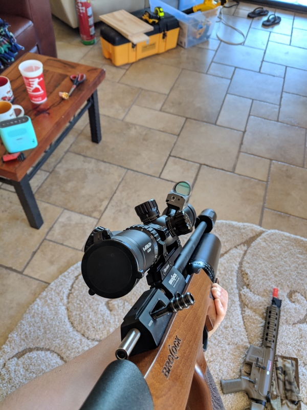

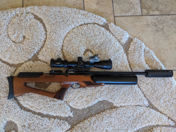

I bought a Brocock Bantam in .25 from AoA, and have put on an Athlon Ares 6-24 ffp scope, a DonnyFL Ronin, as well as Sig Romeo3 red dot sight offset mounted for the close up pack rat shots that are commonly available at night. I have a Harris 6-9 bipod with KMW pod-loc coming, as well as an Air Venturi Nomad compressor for refills.
My goal is to take this airgun out to 200+ yards. This will be a great tool for practicing the fundamentals and wind reading. I have taken my powder burners out to 2,200 yards with the goal of getting to 3,000 yards, so I love to push the ballistic limits.
With that said, are there any available mods or tunes to be done to the Brocock Bantam to make it a more capable long distance machine? Aftermarket regulator? Anything else worth considering? Or should I just be content and leave it at is?
