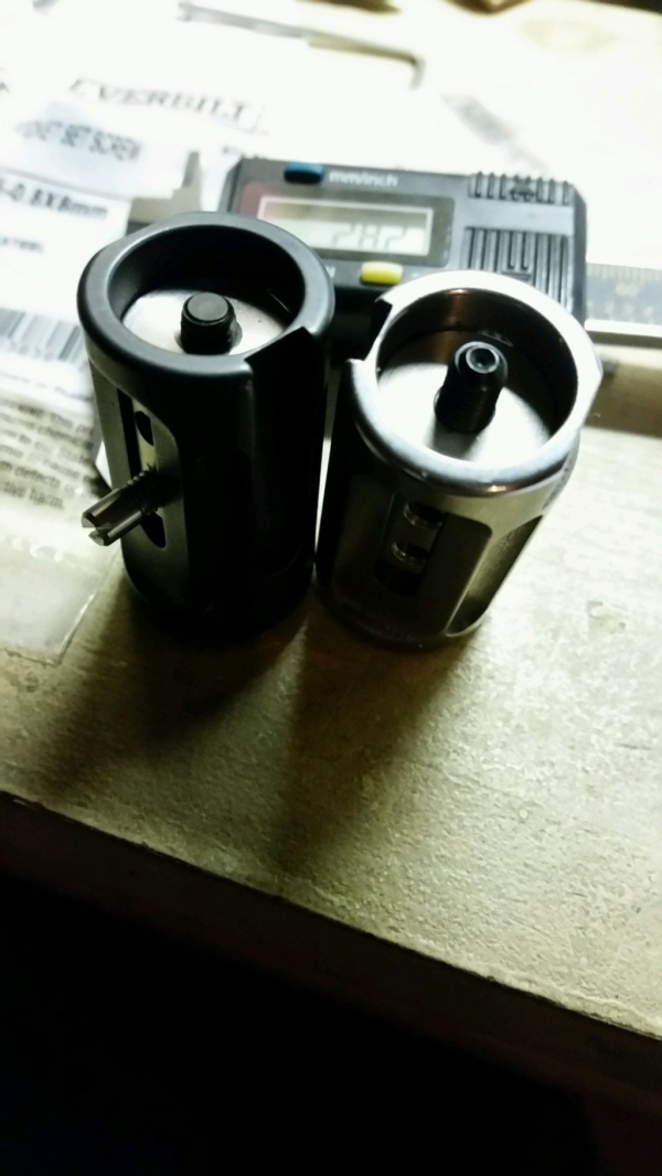

I have been so pleased with my Brocock Compattos after I tuned them, that I thought that I would try a used Bantam. I picked up a used 177 Bantam from another forum member, though I was hoping for a 22. Anyway, out of the box, I was getting a pretty poor efficiency for the 480 cc tank: 0.5 fpe/ci with the factory spring (lots of preload) and factory hammer set. It was doing 910 fps with JSB 10.3 at around 19 fpe for 20 to 30 shots at 3% variance. Not very efficient.
I opened up the action and started playing with the slingshot hammer. It seemed as if there was no "slingshot" in it - the hammer screw was all the way out and the hammer was resting on the valve pin. I could not back off the hammer screw far enough (or so I thought), so I replaced it with a shorter screw. When I re-installed with what I though to be some "bounce" I could only get around 550 fps with 10.3gr. I tried a much heavier spring - still 550 fps or so. So, I started adjusting the hammer screw out further and further and even backed off to a weaker hammer spring. I got the efficiency up to about 1.33 fpe/ci - roughly 808 fps with JSB 13.4 at 19.5 fpe for 30 shots from 185 to 170 bar. Note that I messed with the springs, a space and the hammer screw quite a bit. In the end, I found if I removed the credit card spacer 10 mil or so, I changed the velocity around 40 fps - so there is more tuning yet to come.
I was pretty happy with the original setup, so I shot some longer strings - indoors 10M: 110 shots at 1.09 fpe/ci at 19 fpe with JSB 13.4 from 200 to 135 bar, I had quite a few errors with this string, due to the offhand shooting
