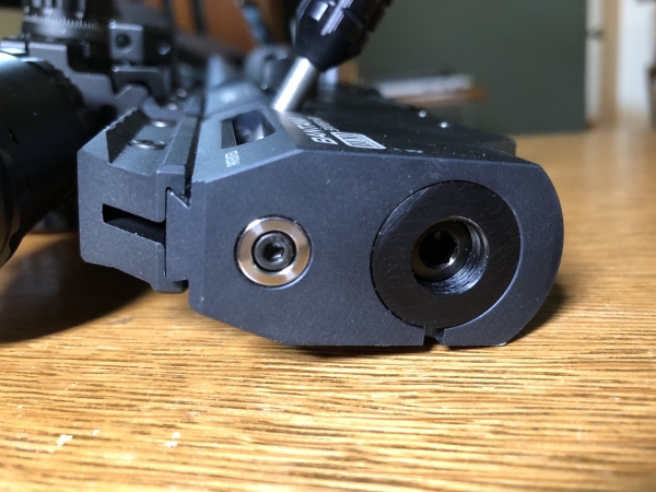

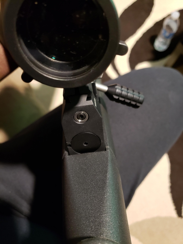

So I just got off phone with AOA, they have recieved my email and said that it's the incorrect set up. I will need to return the it and swap it for a new gun or replace the parts. I asked if they could just send me the part and I'll do it myself, they said it was not a easily done. The rifle will need to be replaced or machined to work. It seems like a fairly simple swap to me but I could be wrong. Well gents I urge you to check your rifle incase yours is incorrect.
This is what the hammer spring area of my rifle looks like.
I don't understand why AoA won't just send you the parts, really simple to replace. I could replace those parts in about three minutes, but while I had apart I would make sure hammer weight was clean and bore where hammer weight slides was clean. It's nice being able to adjust hammer tension on the Sniper, Regulator pressure hand hammer tension go hand in hand.
