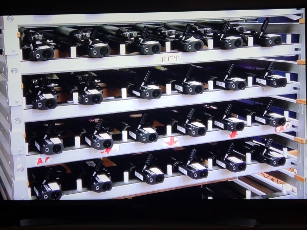

So I was watching the "Airgun Show" on YouTube and they showed a clip of the Brocock Bantam sniper production. It looks like my gun is straight from England in unmodified condition. I will definitely have to have a talk with AOA about getting this sorted out. I'm a bit disappointed considering they had delayed my gun for shipment to fix a problem. I'm not sure how they missed this.
Here is a picture from the show, as you can see they all look like mine.
Rico... would you please send a link to that YouTube video?
