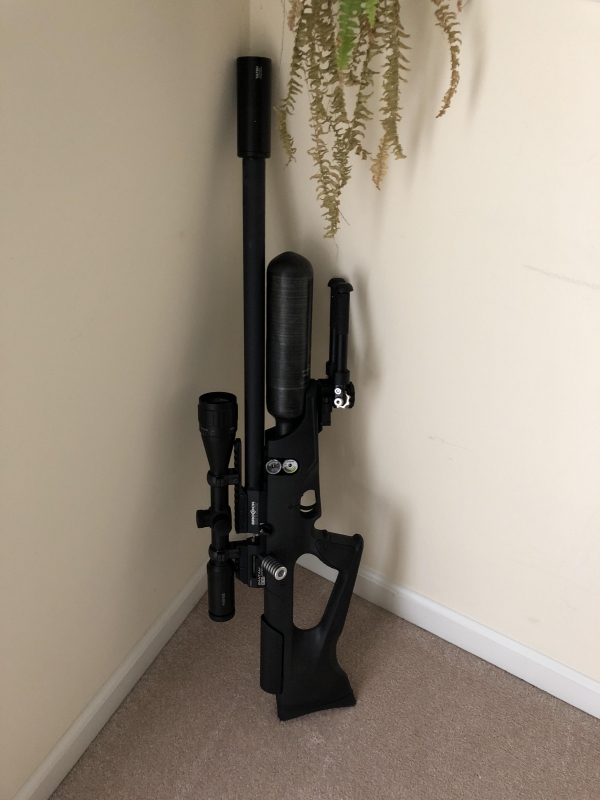

Here is my Sniper, I also have an Aztec Emerald on the way. Added a bipod as well.
Think you all are helping me decide on what .25 to put next to my other .25 after all you can’t have just one hahaha plus it will give me a excuse to try out a Aztec FFP scope, have two Aztec SFP scopes already and like them both but unfortunately I will have to wait untill I have my heart surgery or get my new pacemaker to see how much money I’ll have left over, I find out Oct 30th what the Heart Surgin wants or is going to do to me.
