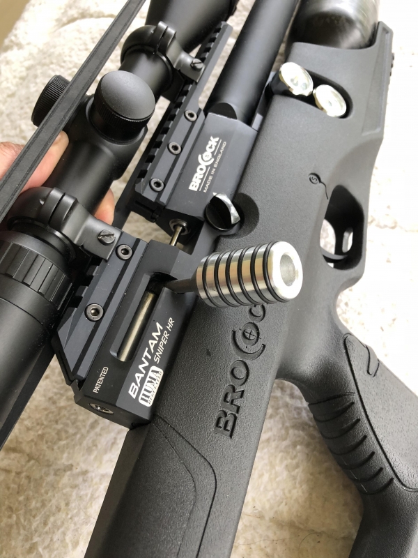

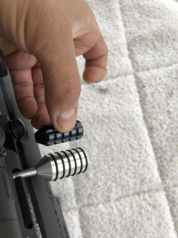

I have owned several regulated and non regulated PCP's over the last 20+ years, My Theoben MFR .20 is adjusted in a similar manner, MFR is regulated , however regulator must be removed from action and set using regulator test tool, I purchased from Dr Bob. It's not that difficult if you know what you are doing, you can hear the shot report change as you adjust reg and hammer tension. Actually gets quieter with more power as you dial in and shot to shot velocity spread tightens up. Sounds muddy and wastes air if out of adjustment. Bolt will cycle easier as gun breaks in, just give it a little time. You can easily adjust trigger with a allen key, my Sniper came to me at almost three pound trigger, I have set to just under one pound. I also added a DonnyFL Tatsu and this really quieted shot report significantly. To make cocking a little easier as you increase hammer tension I made a larger bolt handle and this really helped. A side lever would have been nice but for $1299 the Sniper is alot of gun for the money.
