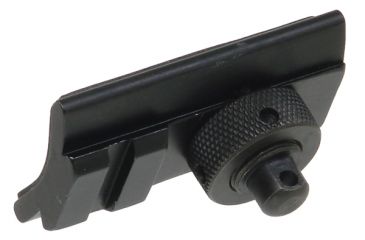

You can install swivel stud, or small section of weaver rail in the front.
If you decide swivel stud, you can add bipod adapter
1522966586_7988517885ac6a03a945ee2.79466157_opplanet-leapers-swivel-stud-slot-adapter-tl-bpad1.jpg
than you can connect hamster to one of the old scope rings and mount it to the rail when you need.

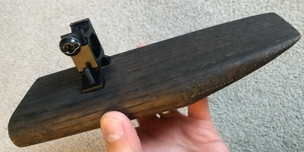

Good idea. I may be able to make something that will work. A cylindrical adaptor form the top MAC1 hamster to the scope ring might do the trick. Since I'm long wasted I need more height. I was planning to use one of the knee rests from MAC1 Airguns. Here is his picture of one from his website. Pyramyd Air has swivel stud with a bipod adaptor. I'll look into it. Thanks again.
http://www.mac1airgunshop.com/adjustable-kneerest-kit-us-ft-gen-ii-p/m1adjkneerest.htm
