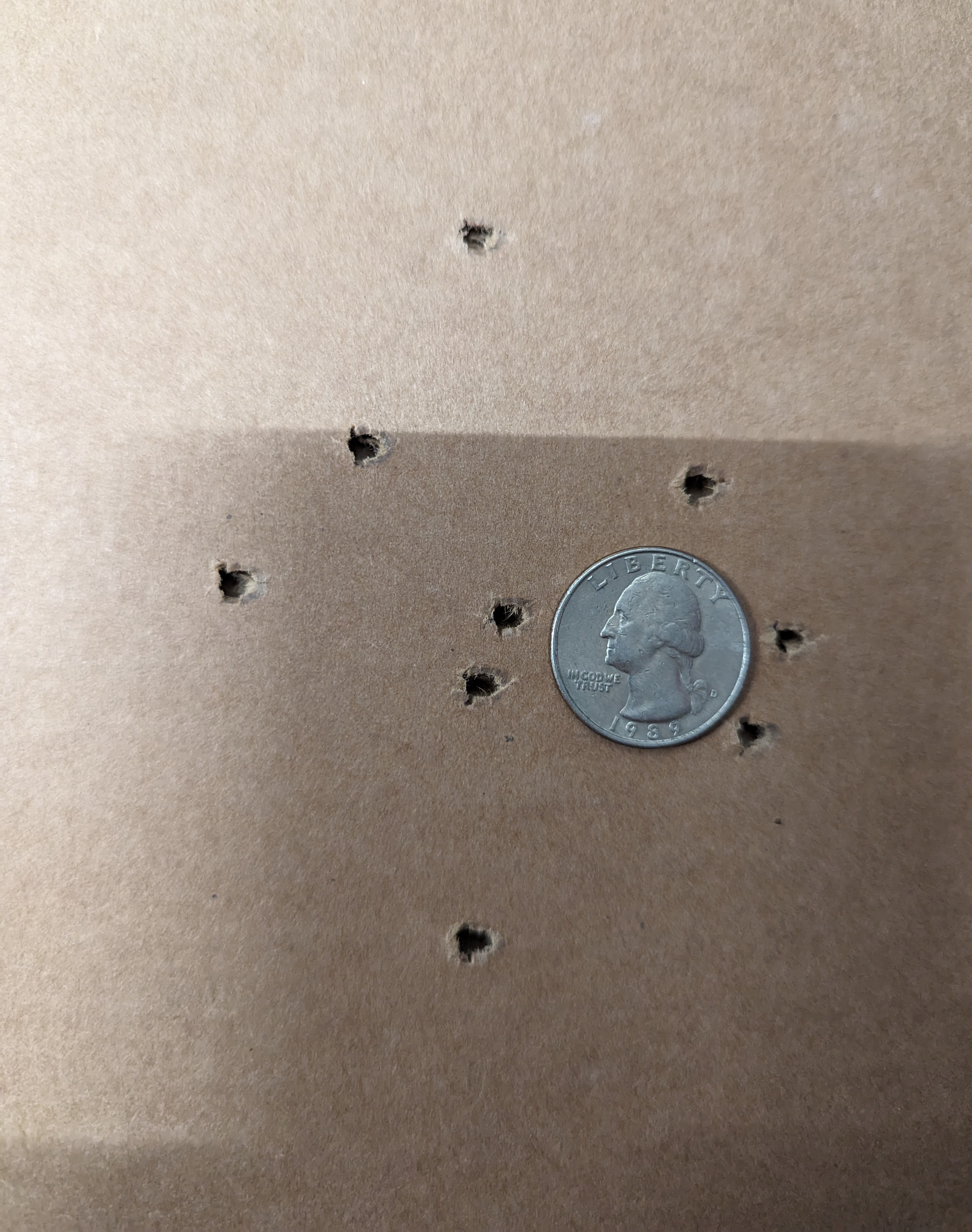

Pushed it out to 174 this evening with the .20 slugs...
Need to work on the target situation to really be able to accurately represent what it'll do but this is a cherry picked 9/10.....bout 2.75" wide and 3.25" tall.
Was shooting through some woven wire fence with 2"x4" squares and lots of the shots were hitting the wire and getting deflected right before the cardboard. Too many over, under, and through fences with how I was doing it this evening. I'll revisit it the next chance I get.
If it'll shoot 3 to 3.5inch, 10 shot groups at 174 yards I'll be pretty impressed. Over the last year I've taken lots of shots from the Ghost on pests this far (many of them successful) but this is the first serious attempt at getting groups on paper this far out.
I'm excited to learn from my target placement mishaps this evening and give it a better attempt the next chance I get.

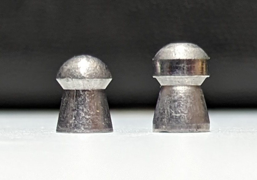

Credit to @Motorhead, but a couple years ago I did this experiment: https://www.airgunnation.com/threads/20-jsb-exact-jumbo-heavies-resized-from-22.1094891/
Essentially, a .22/18.13gr JSB sized down to .20 to make a .20/18.13gr pellet.

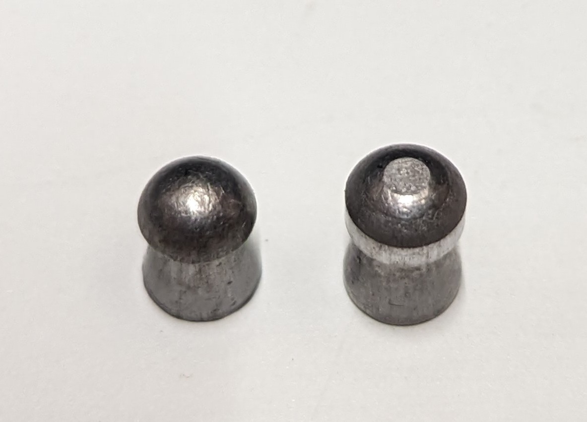

Here's what they look like....left is a unmolested JSB .20/15.89 and right is a sized down .22/18.13 to .20/18.13...
Yes it makes a rather large bearing surface. My process is also giving it a small meplat.
When I did this test with a different gun/barrel a few years ago the fastest I pushed them was 880ish, which produced a BC of 0.042....in a perfect world BC wouldn't change with speed, but in reality, it often does. So I've wondered what faster would do for accuracy and the BC for awhile now.....
So I made up a fresh batch of .20/18.13 and just ran some over the chrono in the garage, from the Ghost. Was hoping for more like 915-920fps but I took 8 shots and they were 894-902 (max hammer spring and same 128reg pressure I've been working with for so long). Just a shade under 33fpe.
They're at least a bit faster than the previous test with different gun. I'm sure I could get more speed with other changes but don't want to fiddle with the tune that much. So I'm going to try them out of the Ghost @ average of 898-900 to see how accurate they are, and hopefully capture a downrange speed for a bc on them at this speed.

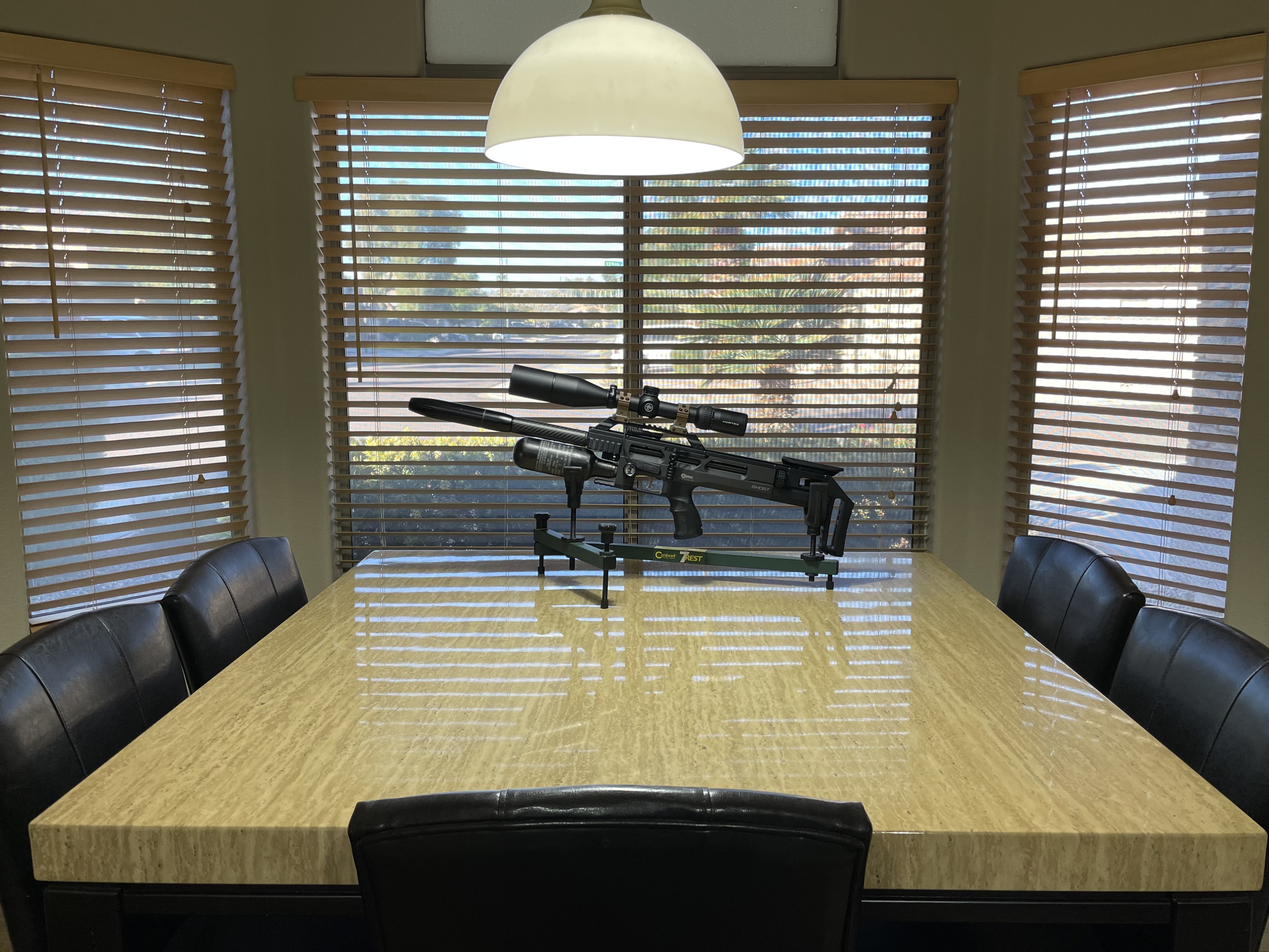

Oh, here’s a photo of some cool kid’s Carbine to keep you excited while waiting for yours to arrive 😉😉
