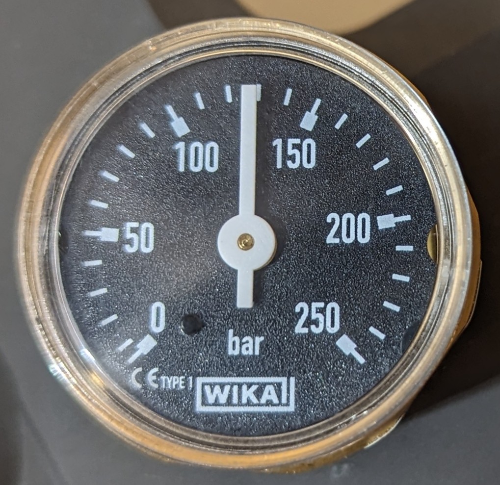

Haven't shot the Ghost since that last FT match 3 weeks ago. Probably the longest I've gone without shooting in 14 months. I've just been busy with other airgun projects and work and life.
But did get curious while I was in the gunroom today....."wonder if the reg pressure has changed at all?"
Nope, right at 128 bar, just like it was the last time I shot it, and for months prior to that.

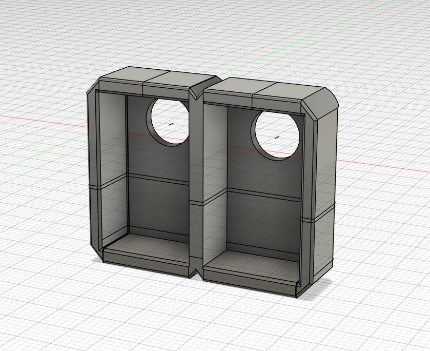

So I did a little CAD designing today, and look what came about!
A little Christmas present for you guys... 🎄🎅🦌
It's a shortened BRK Ghost cocking handle, so you can extend your trigger finger and/or operate the safety without the handle being in the way...:)
The look and feel is nearly identical to Daystate's original that is used on the BRK, I only made it a little shorter.
There are two sizes, one for regular trigger fingers, and one for regular and sausage fingers!
Print with PLA+ (or PETG or ABS or a carbon reinforced filament) and use 3mm wall thickness so there is enough strength and flesh to tap an M4 thread into the vertical hole. Then use original hexscrew to fix it to the sidelever.
