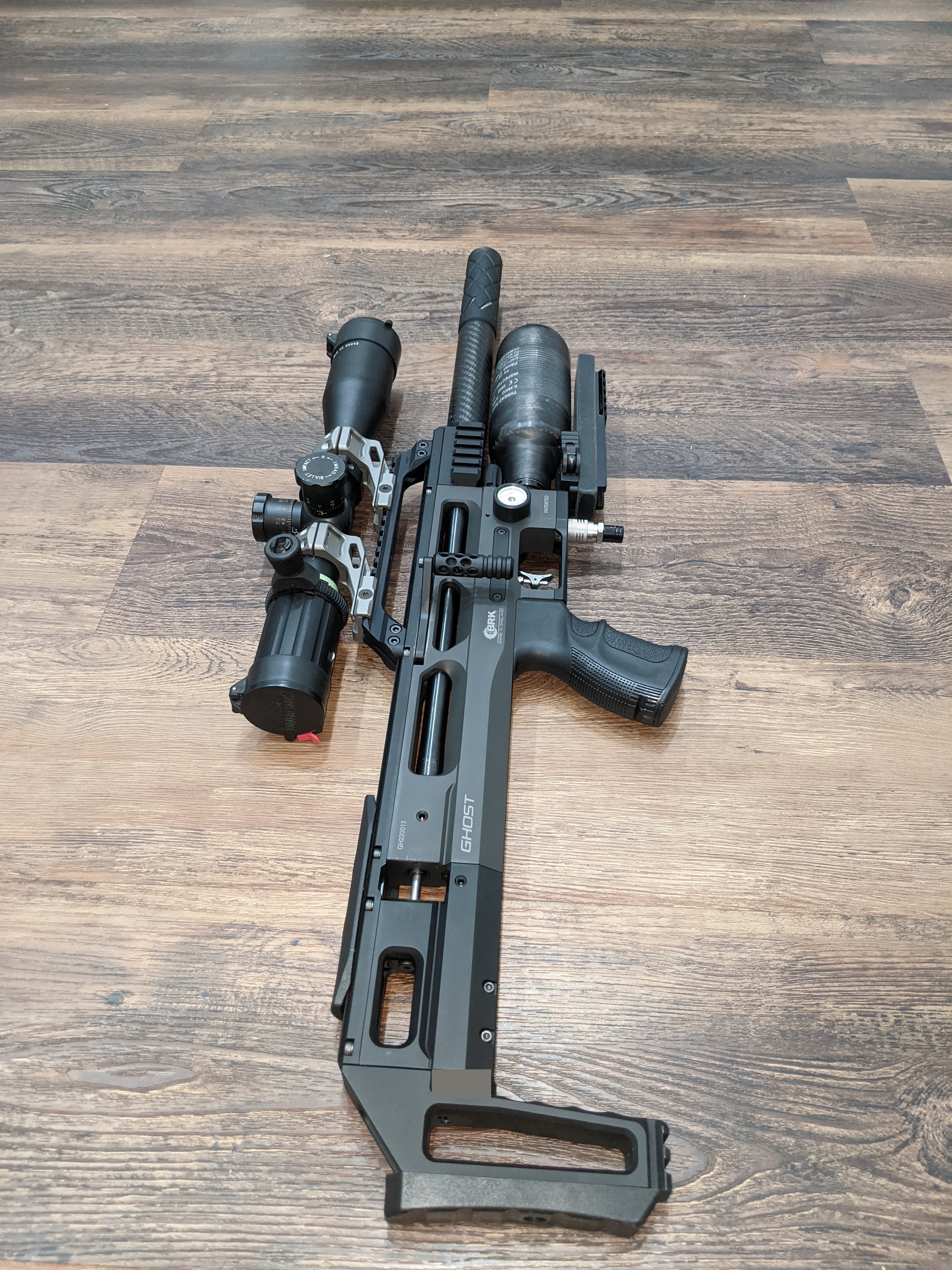

From Michael's comment about BRK releasing a: "Ghost HP, Plus and Carbine" I would suspect this review gun config is the "Carbine". It sure is a short, cute little thing.
MSRP versus actual versus sales pricing muddies the waters a bit, but I was told by my BRK rep that they're considering pricing this short barreled .177 with the small bottle a bit less than the $1995 that they're talking about for the versions with longer barrels, bigger bottles, and higher fpe output.

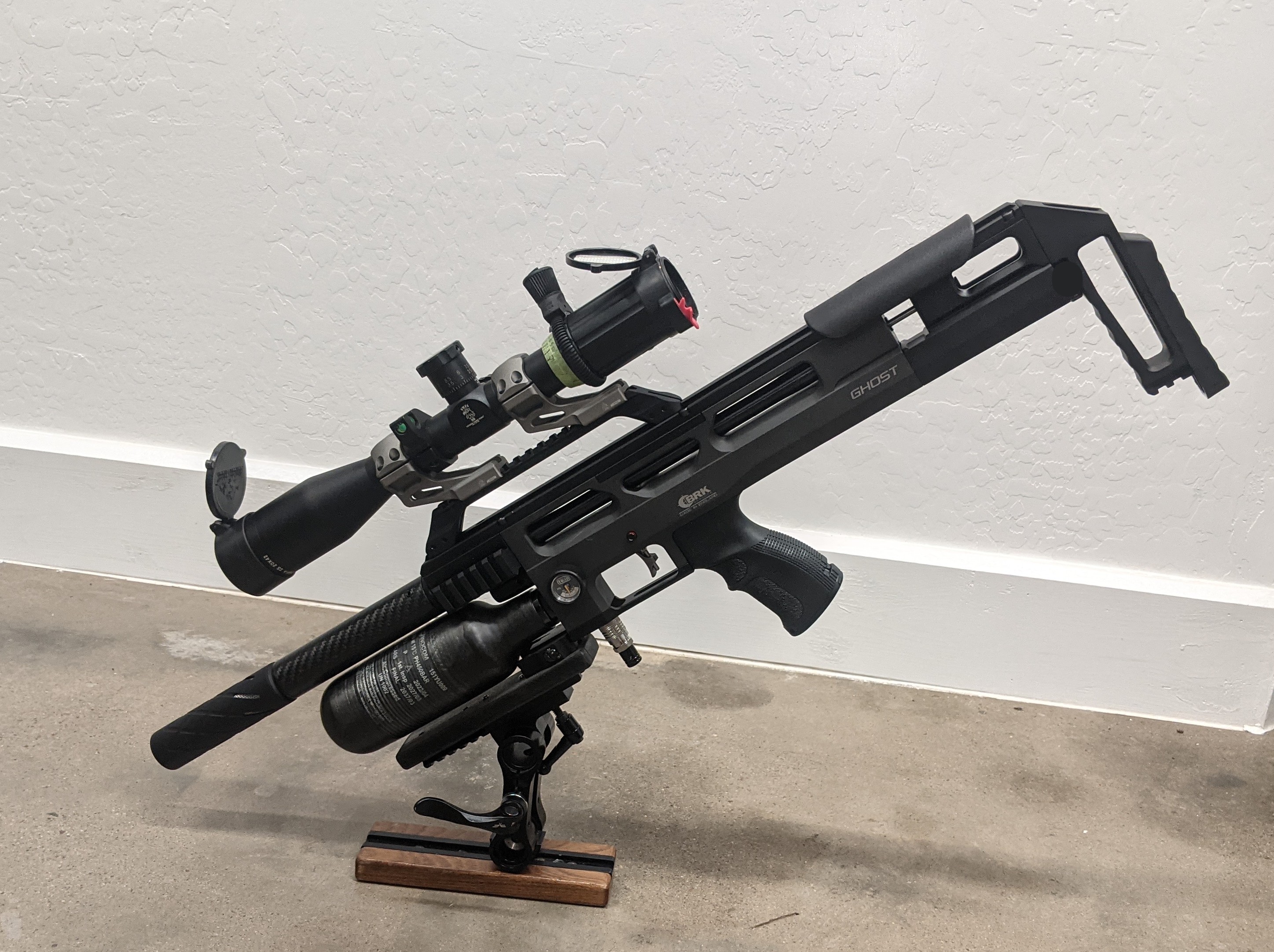

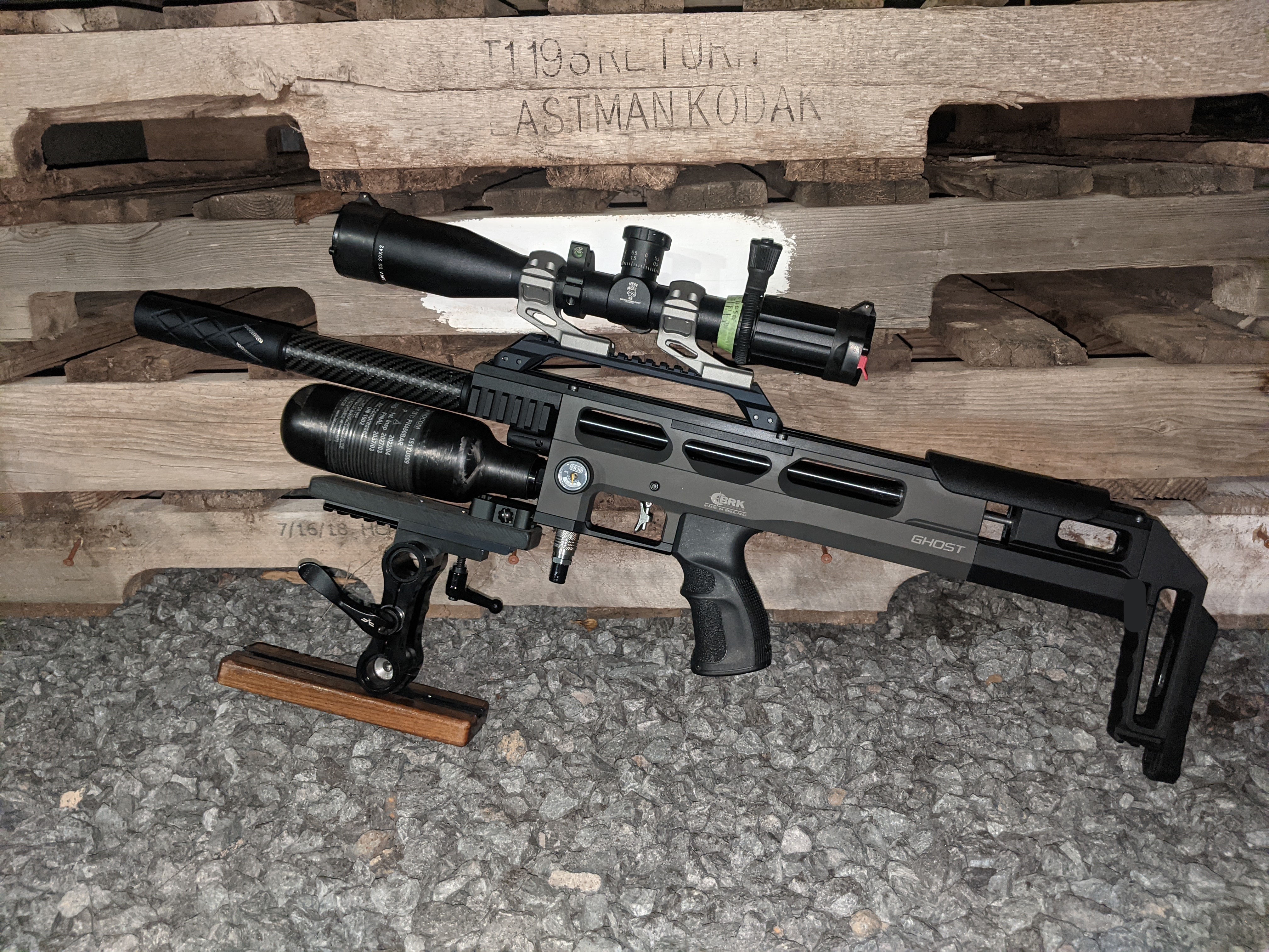

Here's some photos with the knee riser I fitted.

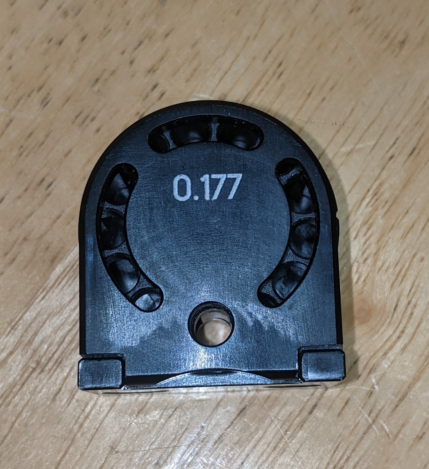

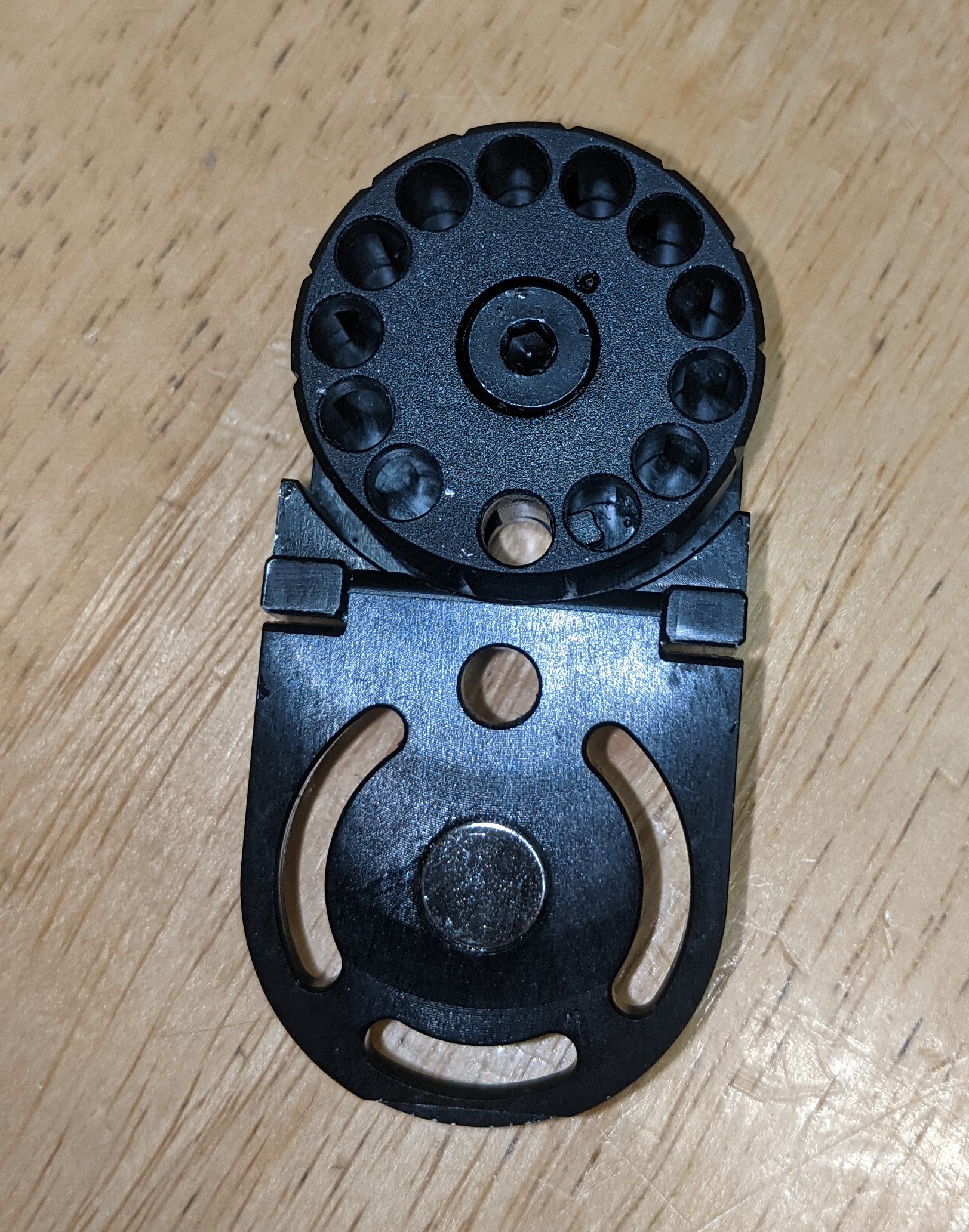

On your small mag concerns....
They'll hold 13 shots. If doubled up with the Daystate/BRK magnetic mag system, that'd be 26 shots without a complete magazine change (just bump em over after the first 13.).

It looks like you would need to do a little Dremel work on the cheek riser to use the push thru magazines.
Thx
Dan
Depending on how you're built and the eye relief of the scope that has been mounted, yes. If you need the cheekpiece about where I have it, then the doubled up push through magazine would be a problem. I've been either using only one magazine and loading/removing from the other side, or single feeding. The magazine gap is large enough to single feed without a tray.
The cheekpiece slides fore and aft for adjustments on the same rail as the scope riser.
