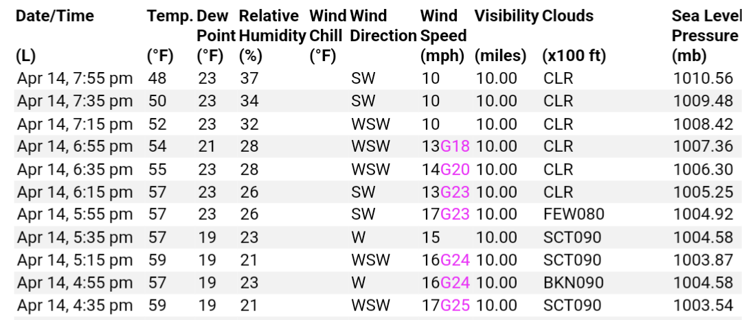

It was a bit windy but the 15.89gr .20 Heavy @ 915-920fps didn't care. Was shooting from about 530-630pm.

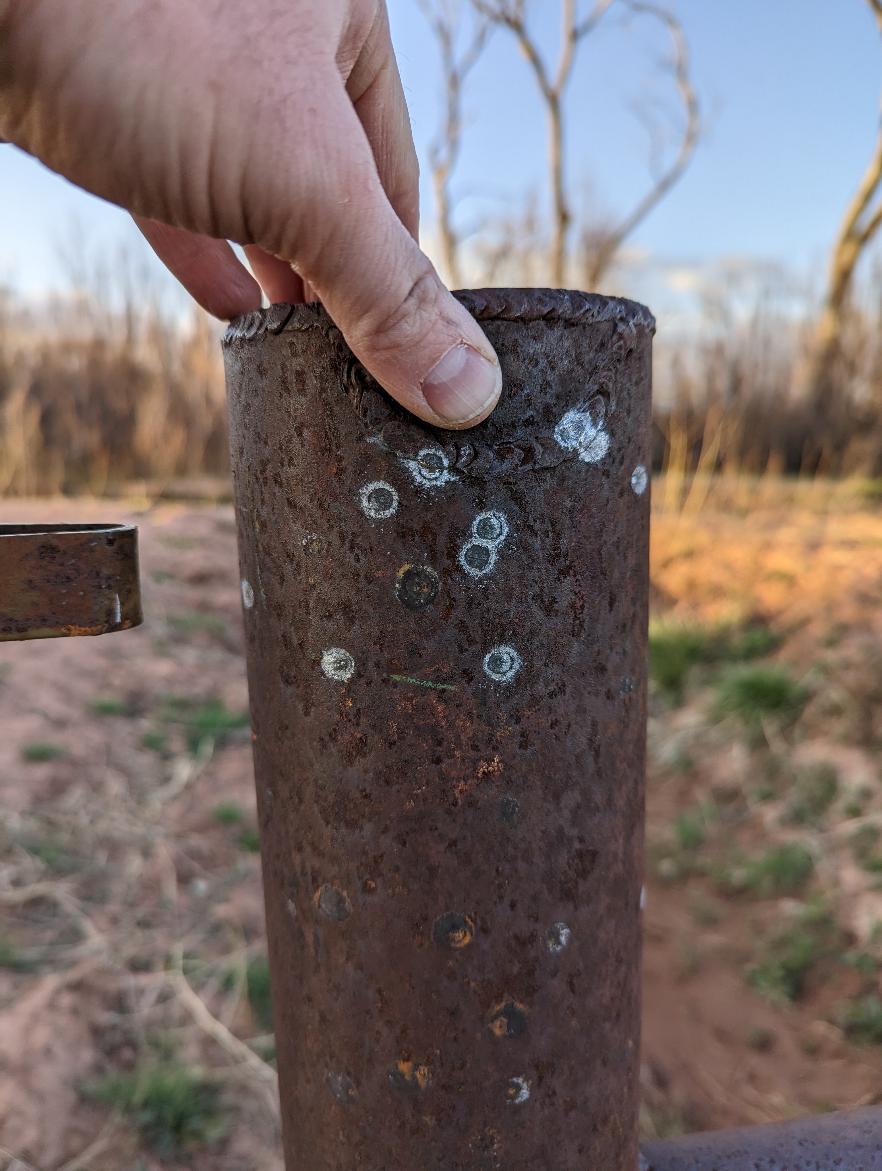

Here's ten shots at a steel post at 135 yards. 0.9mil hold off into the wind, with 5.2 mils of elevation dialed in.
Shiniest ten shots were from this evening.

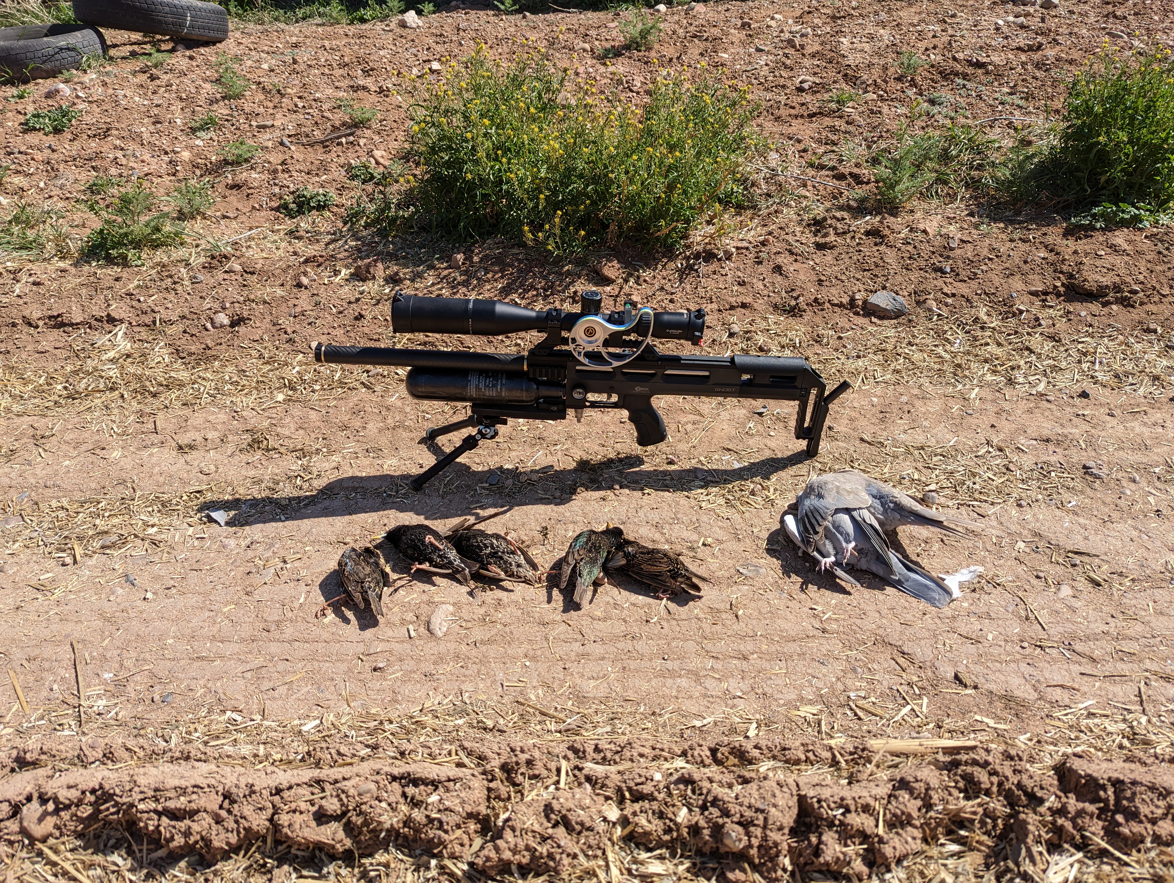

Just had a 15 min pesting session at my extended families feed lot/silage pits.
.20/13.73gr JSBs going 810fps are pretty potent medicine for small pests. Most shots were roughly scope zero of 25-45 yards. Closest was 23 yards and furthest was one of the Euros @ 66yards.
These were what I could recover.
Not pictured are a few more starlings and a ground squirrel. Really wish I could have recovered the squirrel but they're tough to anchor, even with solid vitals shots like he took. The laws of gravity are just different with ground squirrels, they always seem to "fall" into their nearest hole with their last tidbit of neural activity.
All in all, super fun mini pesting session.

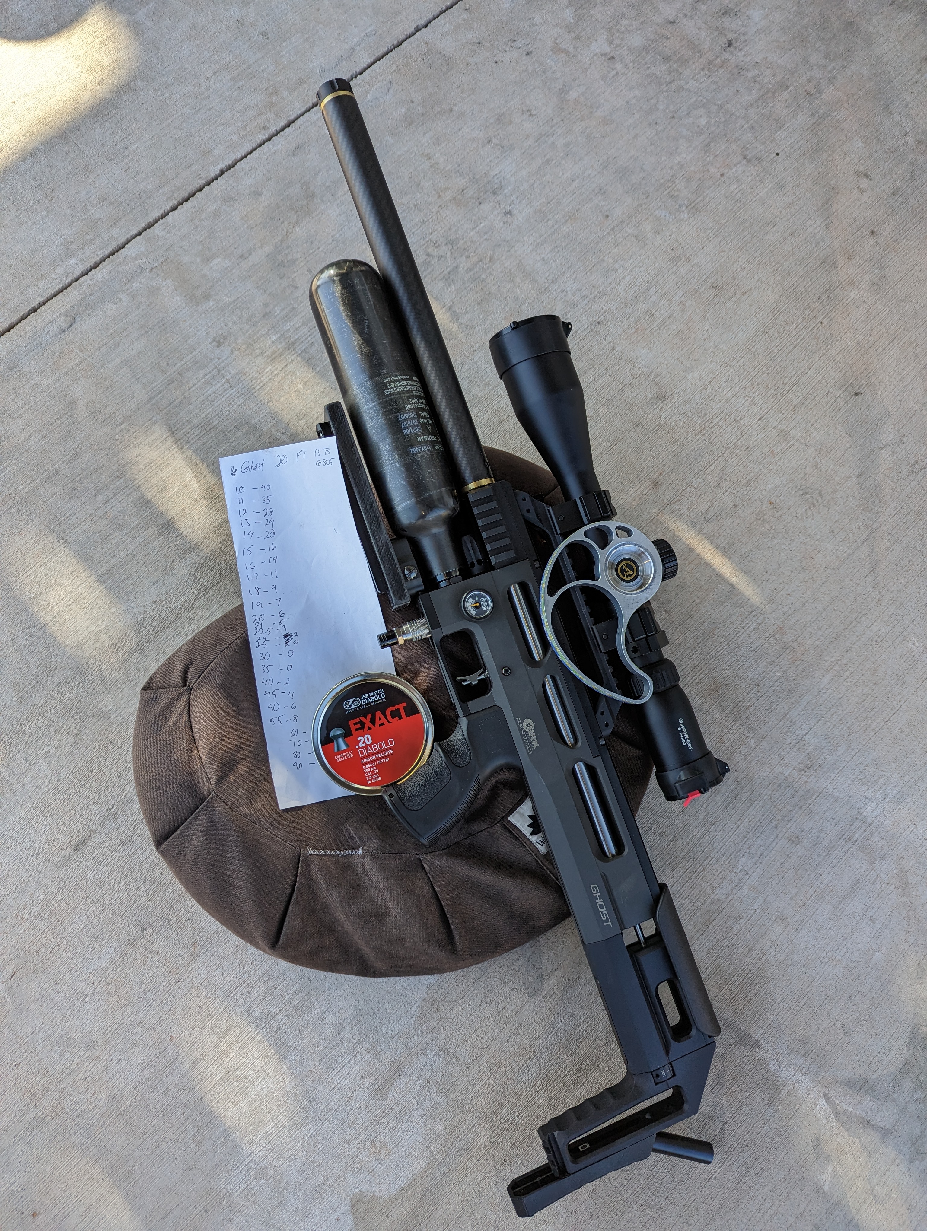

I shot 4 EBR cards at 95 yards this evening, with the .20/15.89gr going 915-920. Wind was pretty rough, 0.2-1.2 mil hold-offs, going both left to right, quite variable.
No sighters and no wind flags.
I shot them the way I typically do, 5 shots at each of the 6 bulls. So, 120 consecutive shots.
Worst was a 213 or a 215 (if I keep the worst of the 6 or the next to the worst of the 6).
Best was a 218 or a 220 (again, if I keep the worst of the 6 or the next to the worst of the 6).
Not too bad for the little .20.

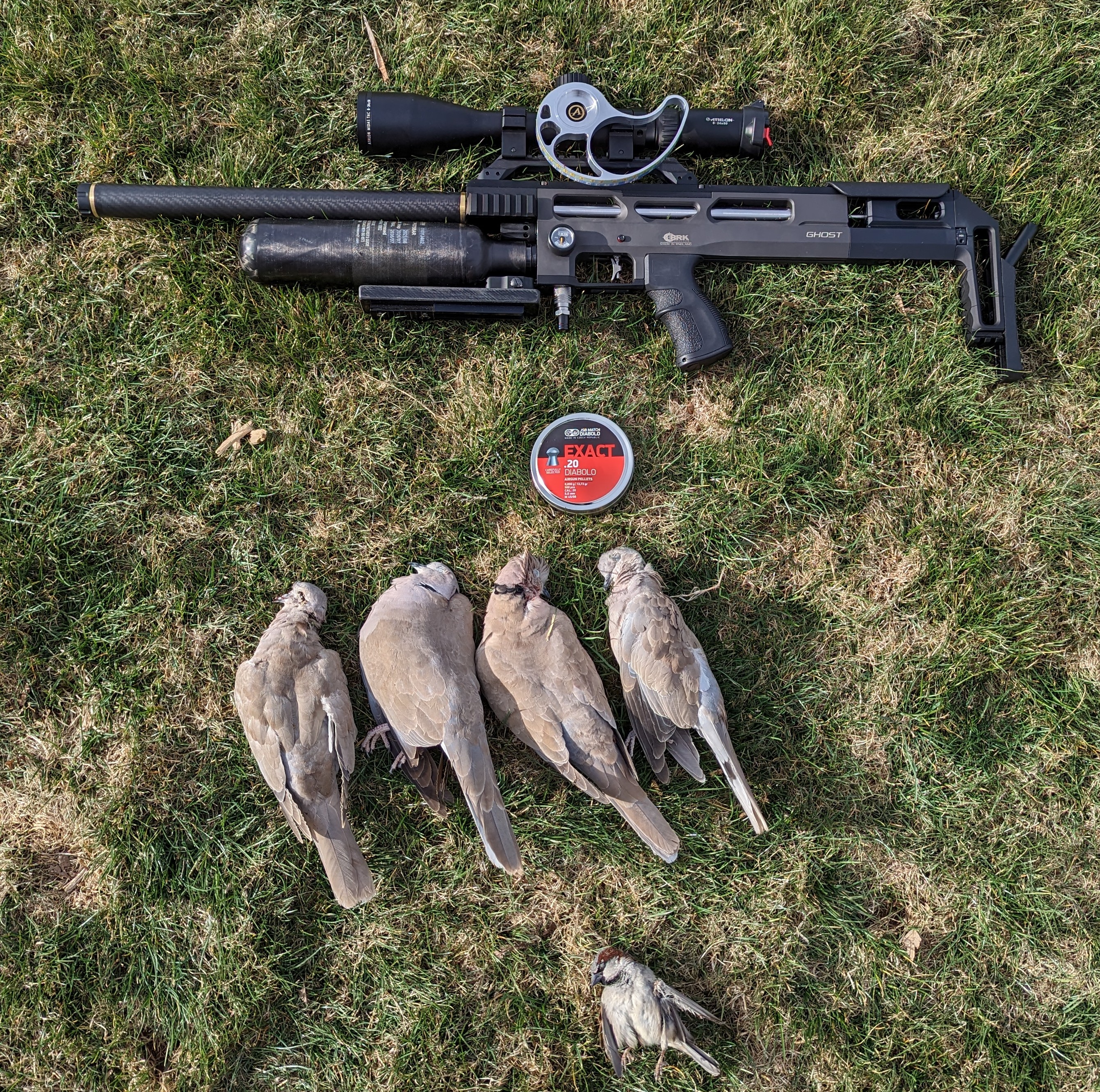

Just had another mini pesting session.
Two of the Euros were at 35 yards. The other two were at 68 and 71 yards. Quite a bit of hold off for them in the 30+ mph gusts today.
I was happiest about the little male English House Sparrow. 52 yards and about 0.9mils for the wind. Probably the most difficult shot of the day.
Fun stuff.

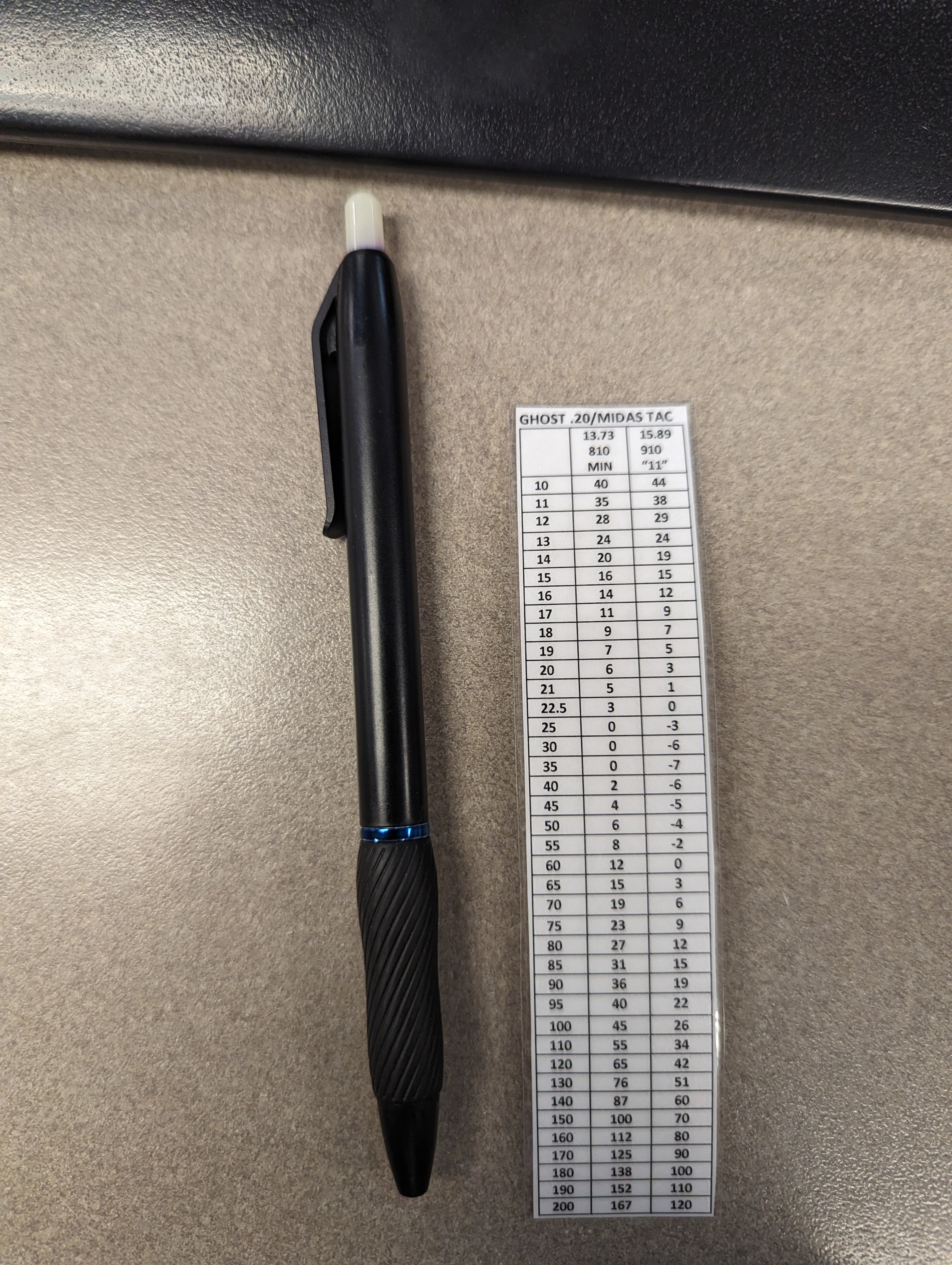

On that note, I just finished getting my permanent dope sheet ready. Gots my data for both pellets at both speeds, out to 200yds, and yes I'll shoot the Heavies that far (have been already). It'll likely get taped to the bottle, or perhaps somewhere else on the gun. (I don't love the holdunders for 25-55 yards for the Heavies, but it's a much better alternative than rezeroing).
