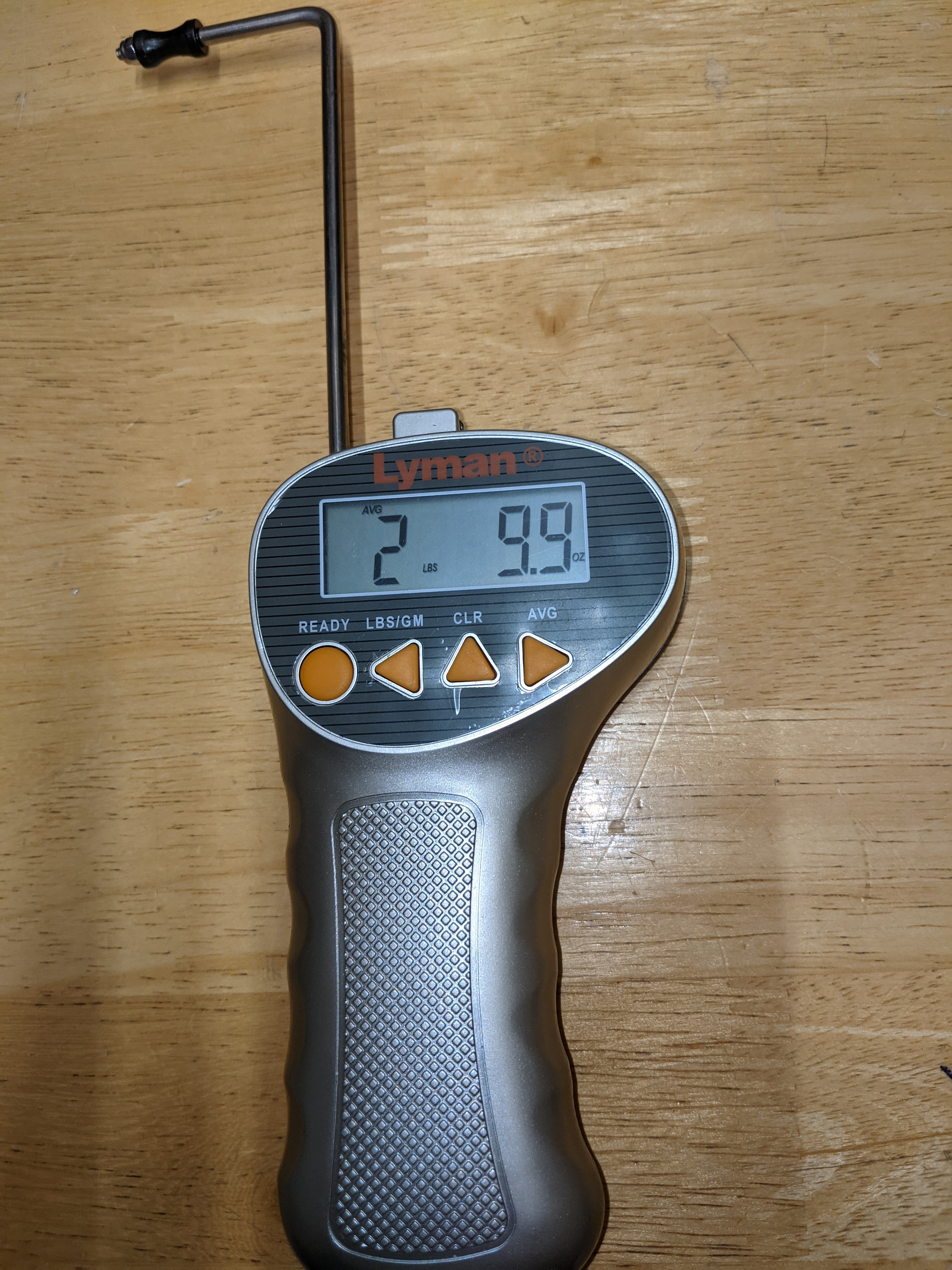

I spent a bit more time on the trigger and have a ten pull average of 6 ounces now. And it’s not just light, but actually crisp at the break. If I was to be real picky, I’d like the first stage to be a bit lighter but can’t see how that can be done and still have the trigger function reliably. Currently it is functioning properly and won’t go off with test bumps (heel of hand on various parts of the gun). Had a conversation with a shooting friend at the last field target match and he made a comment about a good trigger not being something that is noticed, well, I wasn’t noticing the trigger anymore when I got about 40 minutes to shoot it after dark last night. I like it!

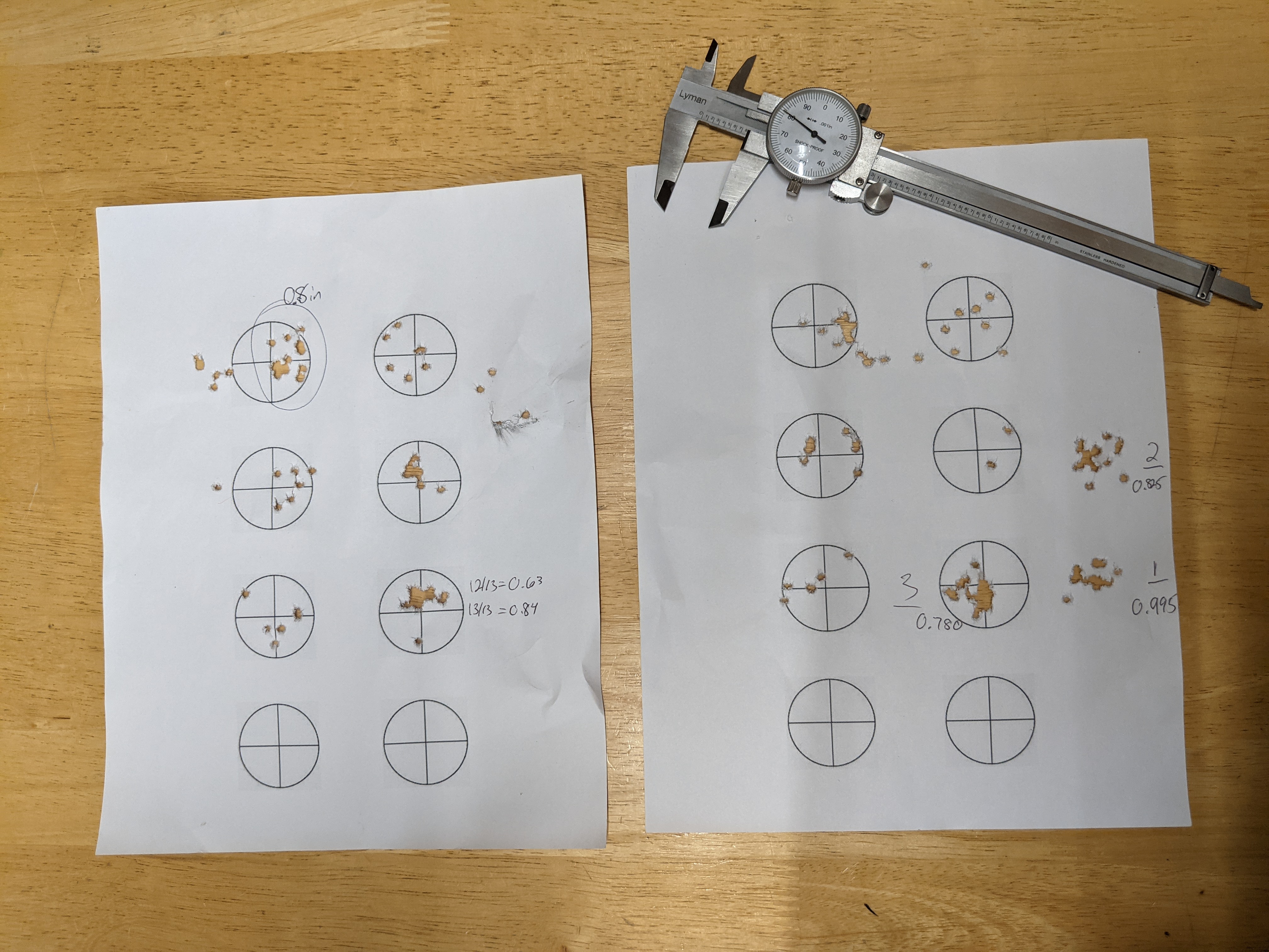

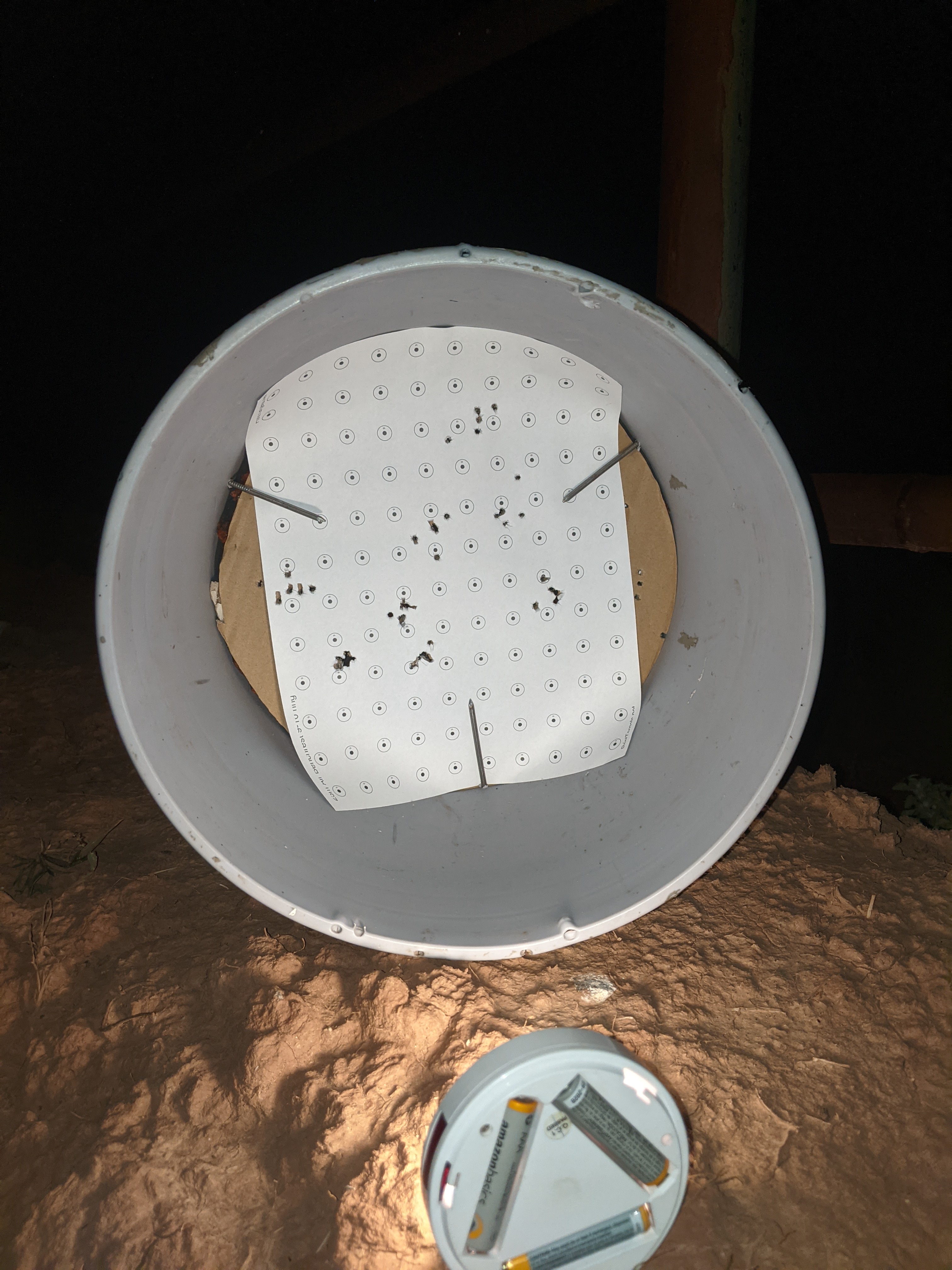

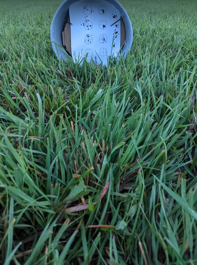

Here are the groups from last night’s shooting session, all at 55 yards and the grass was waving around in the bottom of my scope view so it wasn’t dead-calm…
Kinda busy targets there and doesn’t help that I was using the point where the crosshair terminates in the curve of the circle as an aim point in a couple places. And my lights cast shadow on the lowest targets so those are clean as a whistle.
The targets that I measured were all 13 shot groups. The groups I labeled, “3,” “2,” “1,” were the last three groups of the session, after I went back to the 10.34s @ 895.
The average 13 shot group size of the 10.34s @ 895 @ 55 yards seems to be around 0.7-0.9 inches, ctc.
There is one group in there were 12/13 measures 0.63inches with the 13th bumping it up to 0.84inches.

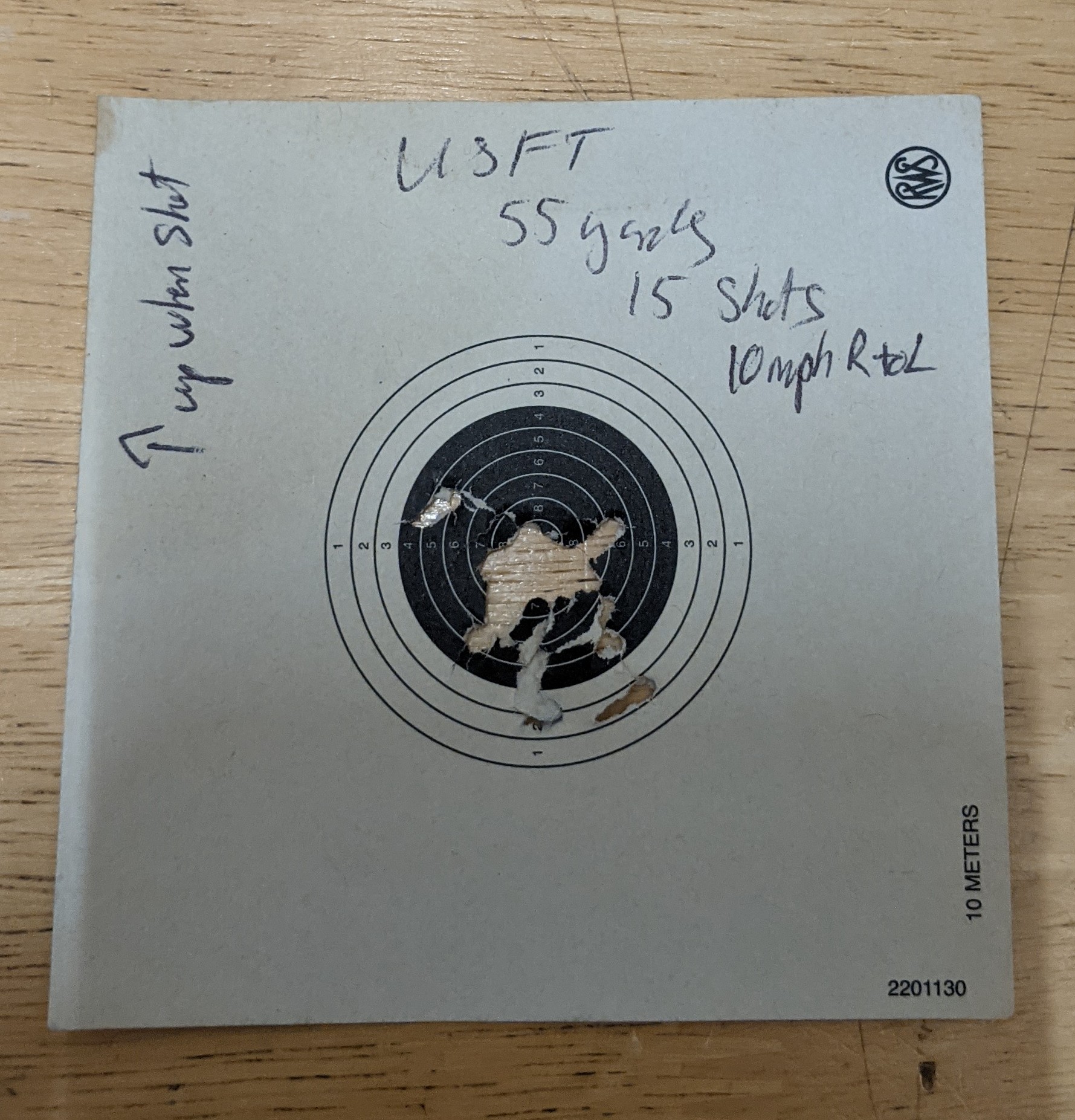

So I’m sitting there in the gun room after measuring and concluding the previous sentence here, thinking, “is this good, average, bad?” I thought, I should compare it to other 20fpe guns I’ve shot, as a sort of metric. I used to keep extensive 3 ring binders of all my paper targets, sectioned out by gun, but last winter, after multiple binders full I realized that was crazy and cleaned them all out and trashed most of it. I hung onto a few, what I considered “good” groups and one of them I kept was from my USFT, also at 55 yards. I remember at the time thinking how impressed I was with it…..it was a 15 shot group.
Here….
Per my notes on that USFT target, the wind was worse during shooting it than it was during my shooting session last night, BUT, as a point of comparison, the group was larger from the USFT than it was from the gun that is the focus of this series. That’s important because that USFT is a proven field target gun that has shot multiple clean (perfect) matches, as well as shot too many 1 miss matches (47/48, 55/56, etc) for me to remember them all. It’s simply way too soon in this process to say that this unnamed gun is as good as that USFT, but that overly simplified comparison gives me hope that good things are to come.

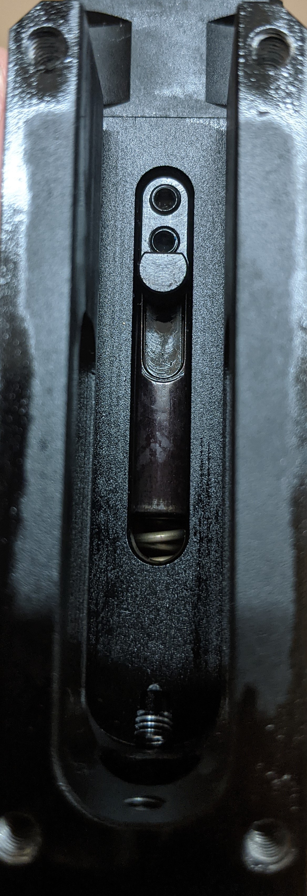

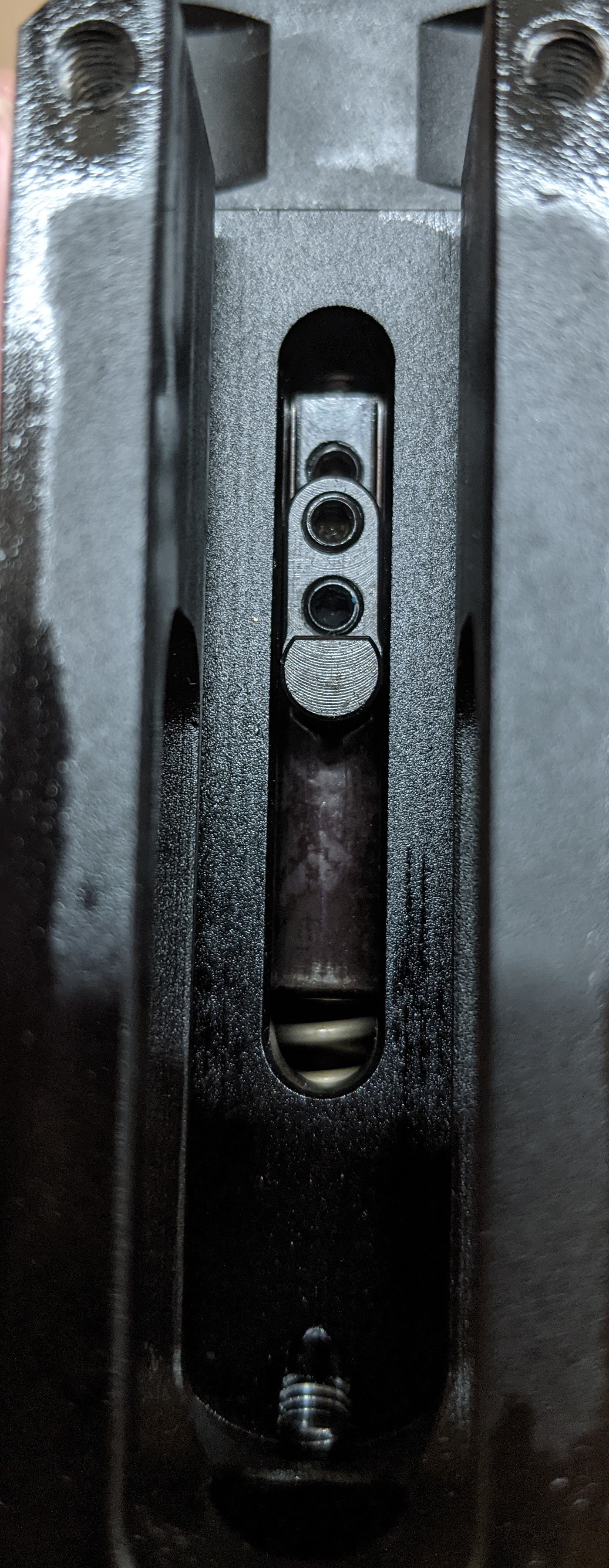

There's one more adjustment at play though, that I hadn't yet fiddled with: hammer stroke. Opened it up and found this (and also realized I would likely need higher reg pressure than 90 bar since it came to me set at max hammer travel and travel distance reduction means less energy imparted to poppet which means less fps).
Hammer stroke set at MAX and MIN travel...
Imagine an L shape, with it laying flat on the long side of the L, with the short end of the L pointing straight up and that's what you're seeing in those photos. The two grub screws go down through the long end of the L, and the short leg of the L (that's sticking straight up) is the 'knob' that catches on the final trigger sear when the gun is cocked. For further clarification, the short end of the L, that we're staring straight down on, would be round if not for the flat taken out of it. That flat is the contact face with the trigger's final sear. A couple coils of hammer spring can be seen towards the bottom of these photos. The hammer spring is supported at both ends: on this end by a hollow cylinder in the hammer itself (spring rests inside that cylinder), and on the other end (previous photos) there is a spring guide that nests inside of the hammer spring.
The gun was delivered to me with the hammer stroke set at maximum travel, and everything I have commented about up to this point had it at that OEM setting. But I now loosened the grub screws, took photos of MAX and MIN travel distances, and retightened the grub screws with the stroke length roughly in the middle of its total travel. Arbitrary starting point. At half travel there is still hammer free flight present, just less of it.

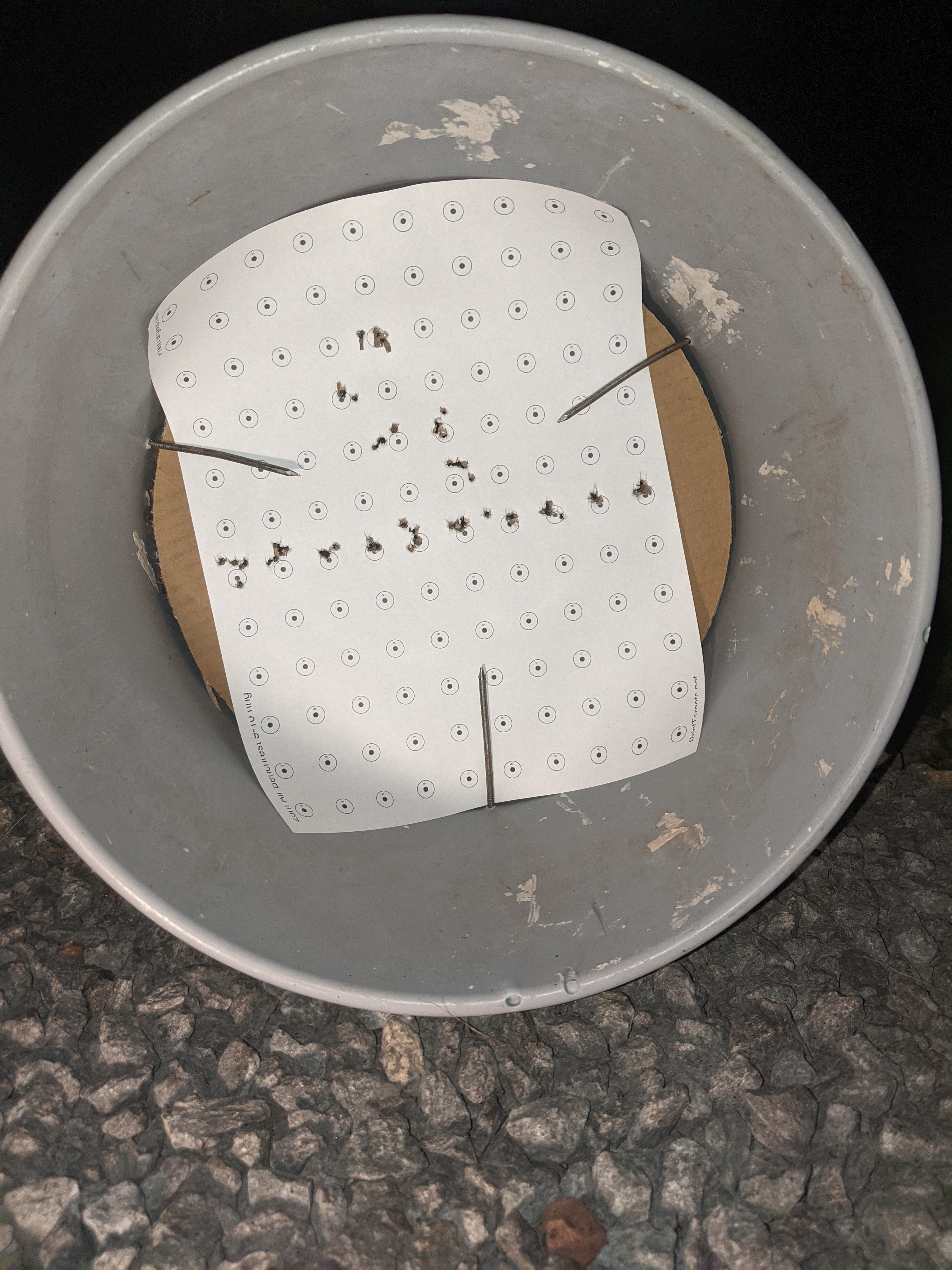

This was from the brief shooting session this evening.
Wind was nearly non-existent. Shooting from a bench/bipod with a rear bag.
Left column was me taking little 3 or 5 or 10 shot group at various hold points as I adjusted the__________________and the scope turrets.
Right column (of printed targets) was when I beared down and really focused on shooting tight groups. Bottom group in that right column (of printed targets) was shooting through some blades of grass that were at roughly 35 yards, and another little tuft of grass right in front of the target, you can see the fine little pieces of grass that splattered onto the paper.
Right side was just me throwing lead and enjoying the heck out of it. While I’ve shot demo LCS semi-autos or easy to cycle mid cocking guns, it’s been a while since I had one on hand to spend a bunch of time with. So I was taking full advantage of that front cocking lever and cranking shots off pretty quickly. I was surprised to see how accurate it can be, even when just shooting for speed/fun.
Everything I shot this evening is on that paper shared above. I’m counting around 125-130 shots. Started with a fill of 245 bar, and shot it down to 105 bar. At the end I compared both gauges to see that the reg and bottle pressure agreed at 105, with the respective needles right between the 100 and 110 graduations.

I’m still hoping to get up to Flagstaff for the last high elevation match of the year, which also happens to be the Founder’s Cup, and happens to be this coming Saturday. And I’m hoping to shoot the mystery gun. And I don’t have any dope. And I work the next couple of days. All of that means I’ll be shooting for dope gathering each night after work. That also means I needed to finally zero out my scope turrets and also start shooting from a bumbag. I was able to accomplish the scope zero and had my first bumbag session with the gun night before last.

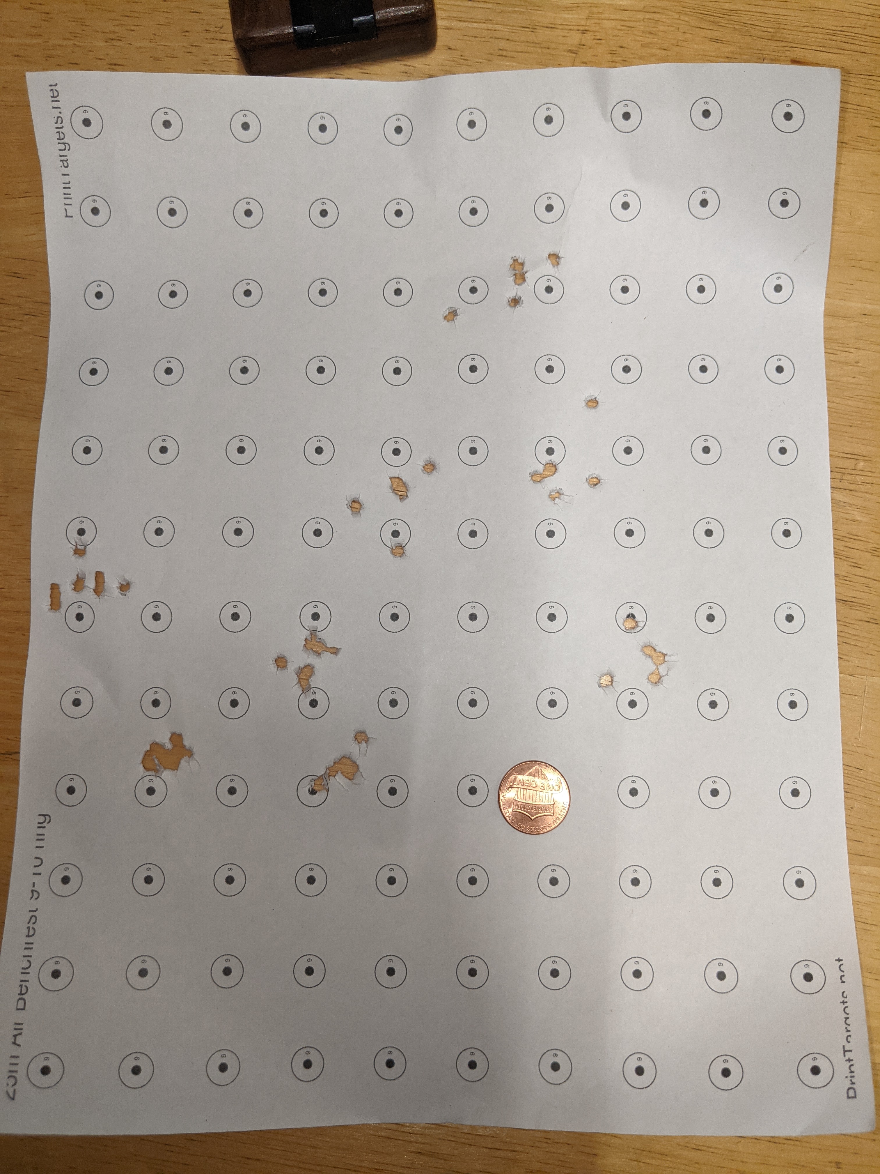

Here they are:
30 yards….
50 yards….
On the 30 yard target I was still zeroing my scope on the upper groups. Once I got it zeroed I started on that line of 5 shot groups that goes all the way across the paper. 10, 5 shot groups, 50 consecutive shots. A lot of that exercise was getting used to how it shoots from this position. It’s a bit front heavy, and mostly because of the contraption I slapped on the front under-rail and the heavy knee riser. It also became quite evident that this is a lightweight bullpup, and lightweight bullpups are a bit of a challenge to shoot from field target position. Even with those qualifiers, I’m quite pleased with how it went. Those circles are 5/16 of an inch. Yes a couple shots got away from me, but pellets were tracking as they should and the “flyers” correlated with my inputs (pulled shots). It’s really frustrating when a gun throws flyers that aren’t shooter-induced. It seems I’ve got the gun at a point where that is not an issue, which is perfect for field target.
I had a bit more of a challenge shooting decent groups at 50 yards, downsides of a short and light gun. I was bouncing around quite a bit in the order of groups, but the last 3 five shot groups I took were the bottom/left most groups on this page. Again, pretty pleased with what it can do when I’m doing a good job as the operator.
Here’s the same groups again, but with a penny for size reference.
