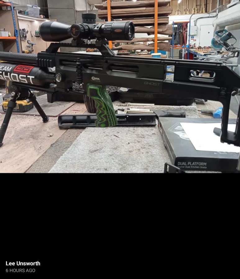

Lee Unsworth just posted on the BRK Facebook page that he's been working with "Form Rifle Stocks" to produce laminate grips that fit the Ghost. I'd never heard of this company before but did a quick search and found where they already make grips for the Impact. They don't have any photos for the Ghost grips on their website yet, but this link shows what they make for the M3 and I can only assume their Ghost grips will be similar.
Man I love the look of laminate. I had zero plans to replace the grip on the Ghost review gun, but if they come up with a black and yellow lam pattern....I'll have a heck of a hard time resisting submitting an order!

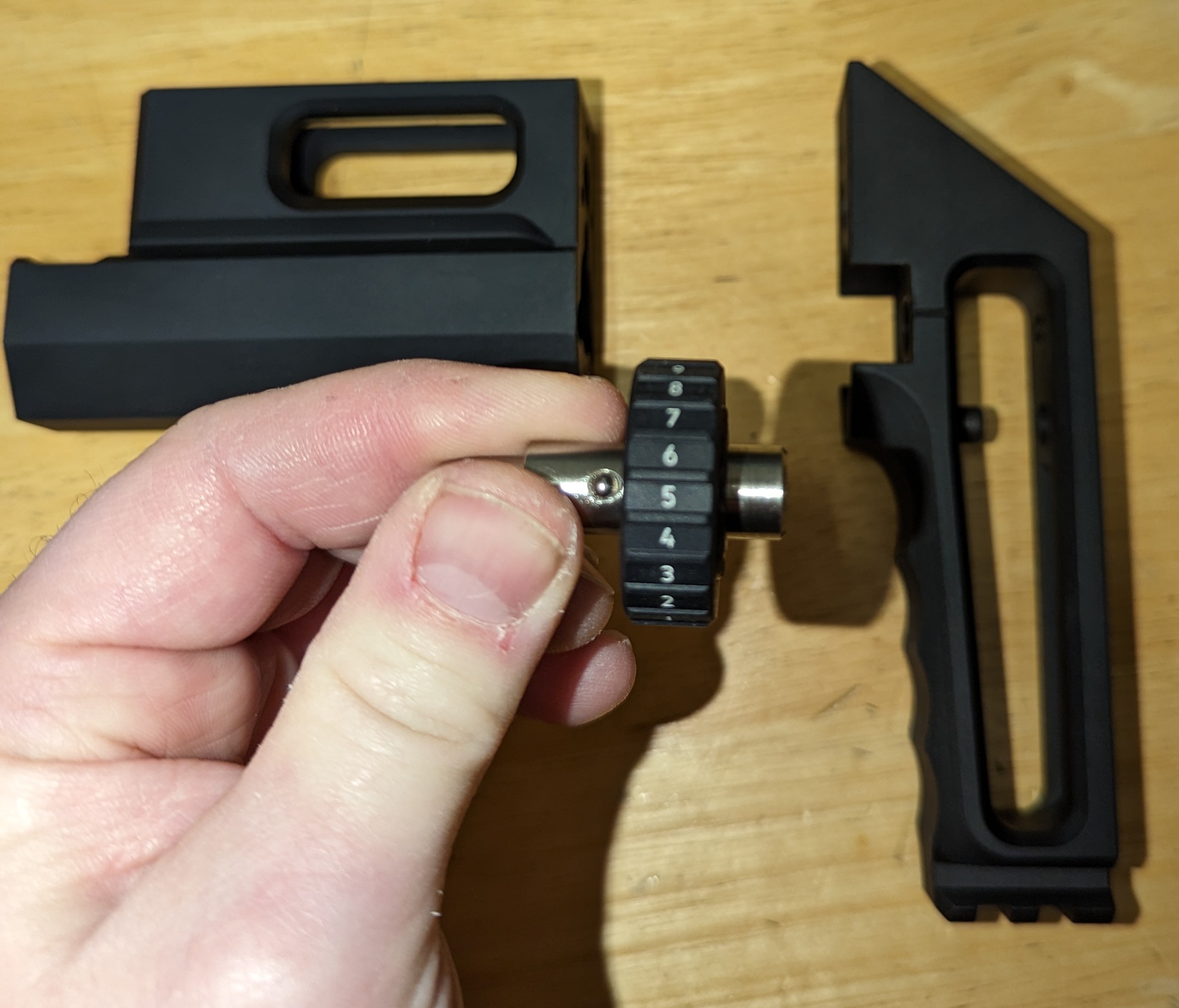

For anybody joining in, there was an updated hammer spring tension adjustment (power wheel) released shortly after the Ghost was launched. The review Ghost has had the original design the entire time that I've had it. Until this evening.

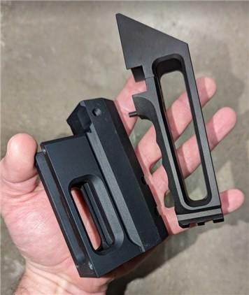

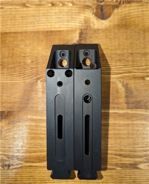

Quality machined and anodized parts just make me smile. BEEFY.

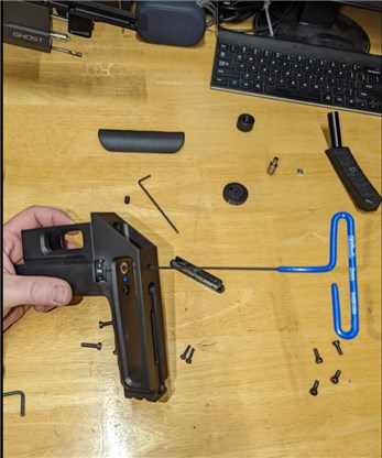

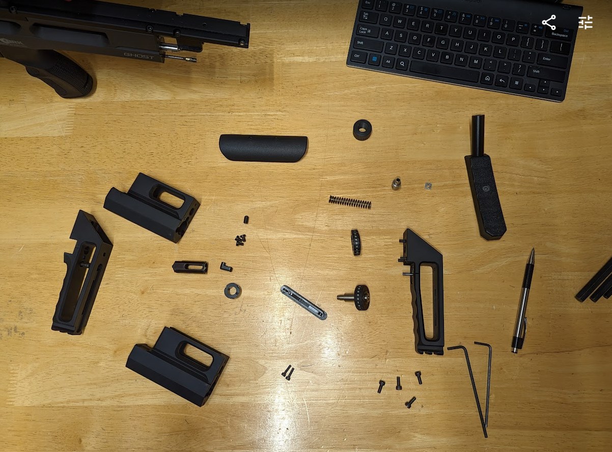

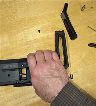

The new parts required that I swap over the hammer and hammer spring and re-use the fasteners. This photo makes it look worse than it was.

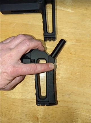

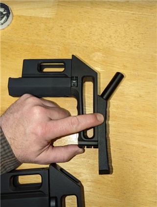

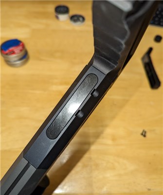

The first difference I noted (and was excited about) was that the buttpad can be adjusted up and down more with the new design. Buttpad rides in this slot, new on the right, old on the left. This was sorely needed and a VERY welcome change.

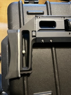

Here's the difference, max and min travel with the old one:

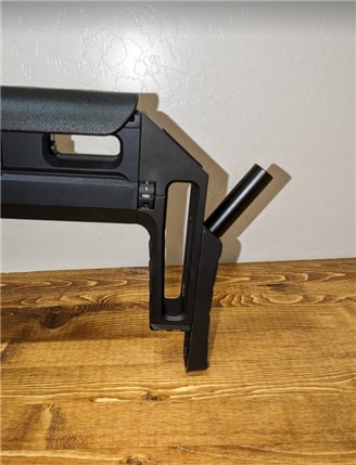

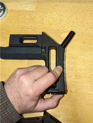

Max and min travel with the new one:

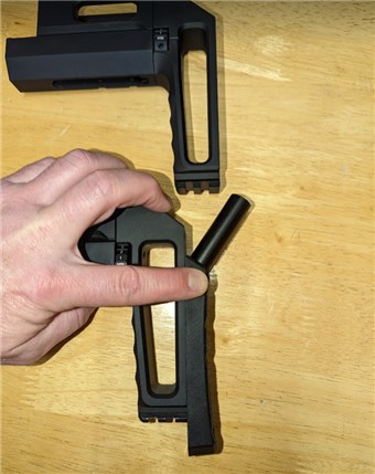

In the photo above, that shows the slot for the buttpad travel adjustment, you'll also notice a new hole in the upper portion of the slot. That's an additional bolt to hold the aluminum drop down (that the buttpad attaches to) to the rear sub assembly. That makes a total of 4 bolts holding the new one on, while the original version only had 3 bolts. The fourth/new bolt is also larger than the other three and placed lower (the original three were clustered near the top). Having 4, and placing one lower, results in a more solid connection than the original design. Also, the metal drop down can now be removed from the rear sub assembly without requiring complete removal of the buttpad (previous design required complete removal of buttpad).
BRK retained the tapered cone for the integral spring guide.

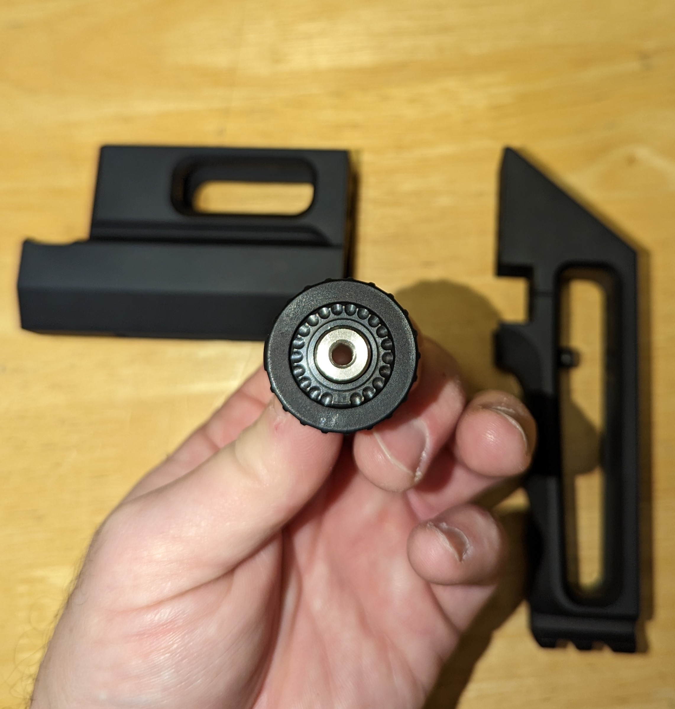

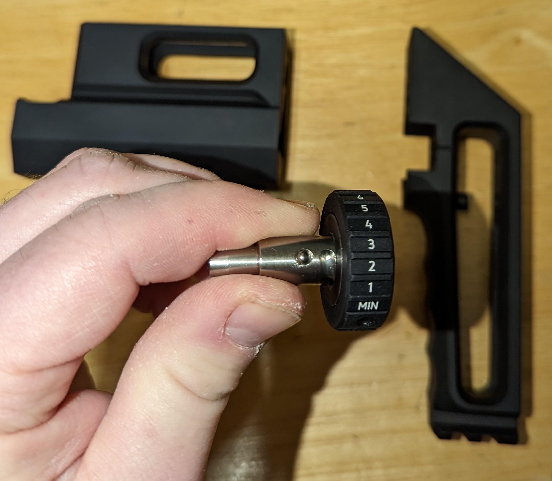

The new and old wheel both have MIN, 1=18, and then MAX markings. The surface of the new wheel that contains the anodized marks for the settings is just shy of twice as wide as the old one.
As I grabbed it here to flip the gun over to get the trigger cassette back in, I instantly noticed how I could grip it here without accidentally adjusting the wheel. The previous design left the wheel much more exposed and it sometimes be a couple clicks from where I wanted it to be, having been inadvertently moved.
The process to convert over to the new hammer spring tension was relatively straight forward. I was impressed with how the old parts and new parts mated together so well. One of the last steps is dropping the trigger cassette into the new rear sub-assembly. And while I say "dropping" the tolerances are tight enough that its a snug fit. Nothing needs forced or tapped in, but just carefully aligned. When it slipped into its home, the word "snick" came to mind. Really small gaps all the way around that trigger cassette!

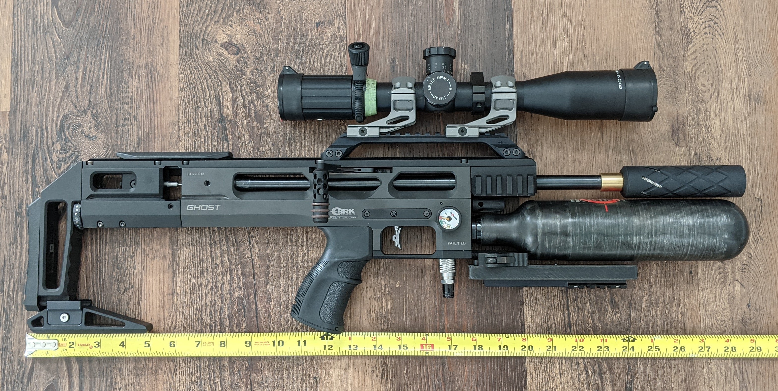

And the final product (with the buttpad adjusted all the way down!!!)

Thoughts on the length: Ghost HP with the 23 inch shrouded .22 barrel and 110C ODB moderator measured 37 and 7/8inches. Ghost Carbine with the Hogan Decimeater moderator (sans shroud) and 17 inch .177 barrel measures 30.5inches. It's crazy how much shorter a gun feels when it loses only a couple inches. And it's downright eye-brow raising to "feel" how compact a gun seems when it loses about 7 inches. It wasn't even that long as a HP, but man o man does it feel short as a Carbine!
