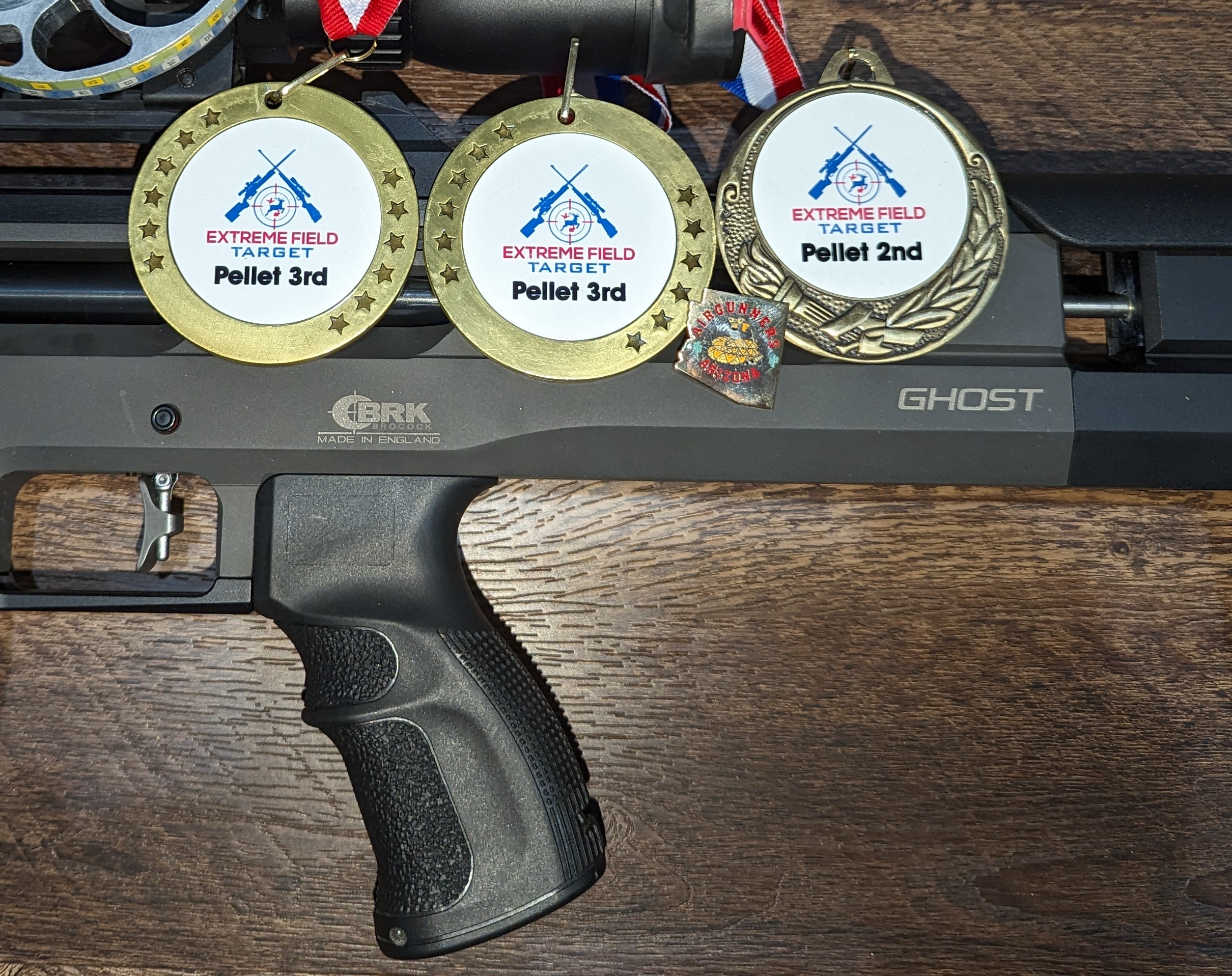

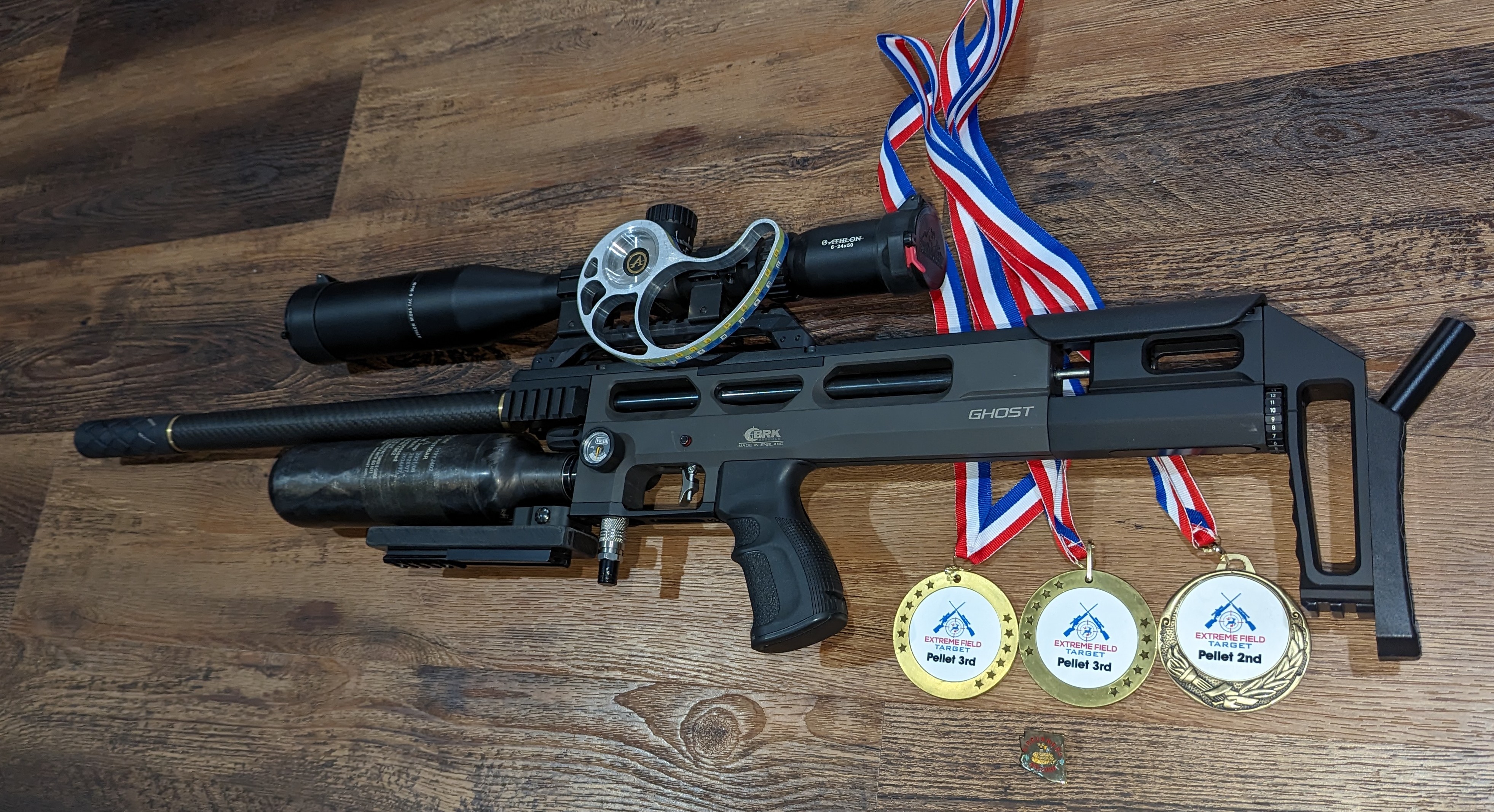

Ghost was good for 3rd place this month, somehow medaling with what I thought was a pretty poor performance on my part. During the match I felt like I was doing horribly but turned out most of the competitors were also struggling to get reads on the wind. I was quite surprised to come out with a third place finish. Despite the wind being so strong, I think I was overcompensating and actually holding too much for the wind. I say that based on greatly reducing my hold off on my last lane and going 4/4 on that lane. I'd started out well, having a streak of hits that was something like 11 in a row there at the beginning but gradually started increasing my hold off and my hit ratio went down as I held further and further for the far targets. Eventually resulting in my frustration with that gameplan on the last lane and reducing holdoff to minimal and having a "clean" lane. That miss free run in the beginning is what got me the 3rd place medal though, as there was a 3 way tie for third and we did the standard default of using that to break the tie. I don't remember ever missing the faceplate though, at least drawing steel on all my shots, so none were too far from that kill zone. The trend of the Ghost doing well in the offhand lane continued, as I went 3/4 this month. Of the 15 competitors, 5 shot 75% on the offhand lane. Ghost was 100% on offhand lane at the Jan XFT match and 75% at the November XFT match. So in the offhand lane, more of the same this month, Ghost ergonomics lending well to being shot offhand, and holding it's own on the forced offhand lanes.
Ghost was still in HP configuration, shooting the .22/25.4gr Monster RDs at a very consistent 935-940fps for just under 50fpe. I've not done any tinkering or adjusting since the November match so we're going on a little over 3 months and it's been stable/reliable/dependable in poi/fps/accuracy throughout that timeframe. I was squadded with Wes (high pellet score competitor) and in conversation during the match told him that I personally just don't have any patience for a gun that can't be trusted in all of those regards.

So, the Ghost has "medaled" in 4 of the 5 matches that I've campaigned it in. Generally speaking, the Ghost continues to show that it can hold it's own in competition against the industry's most well respected platforms.
