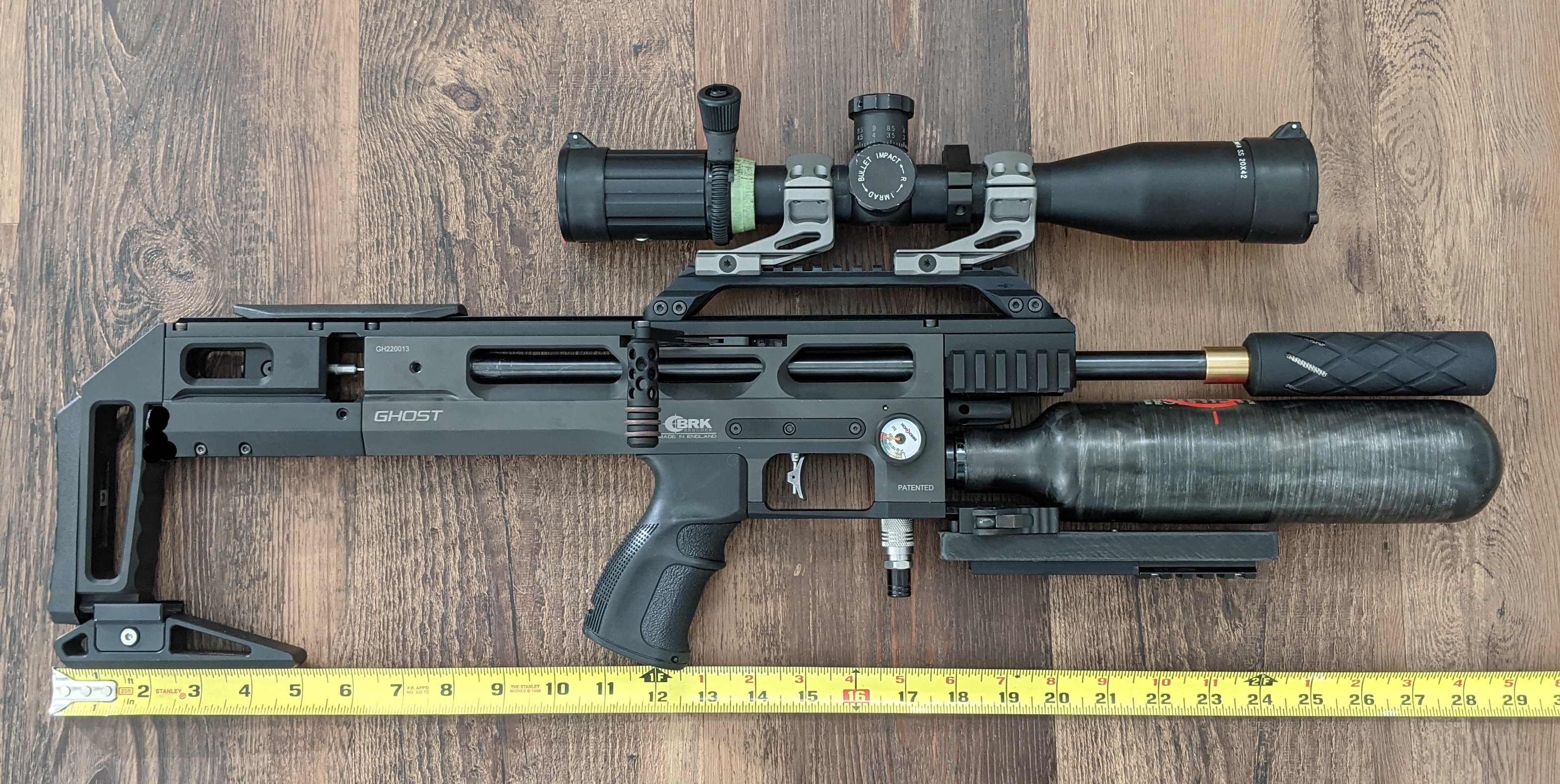

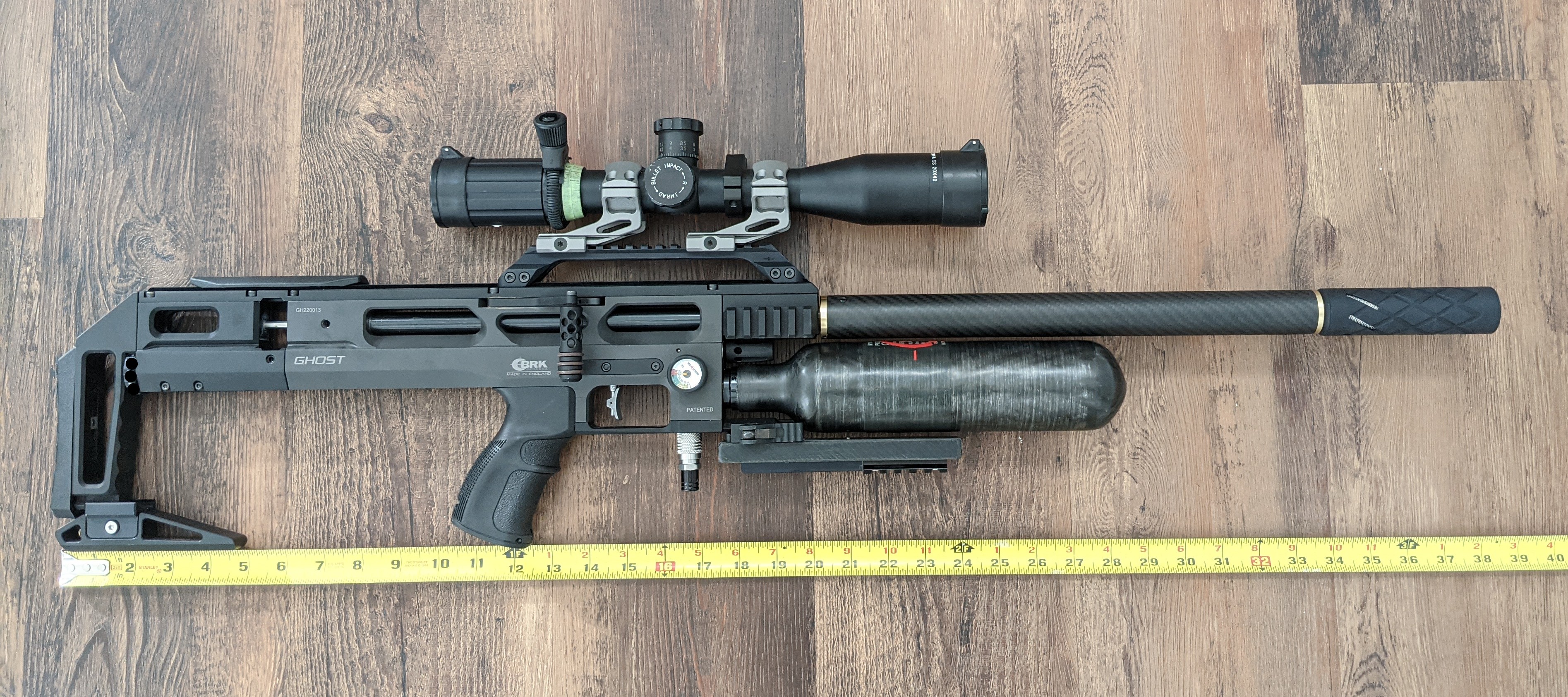

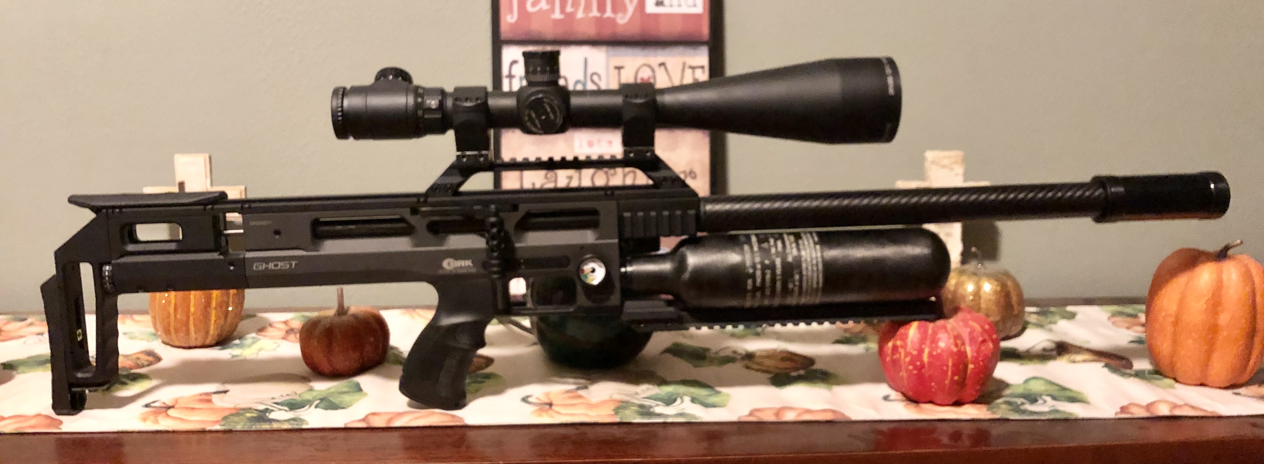

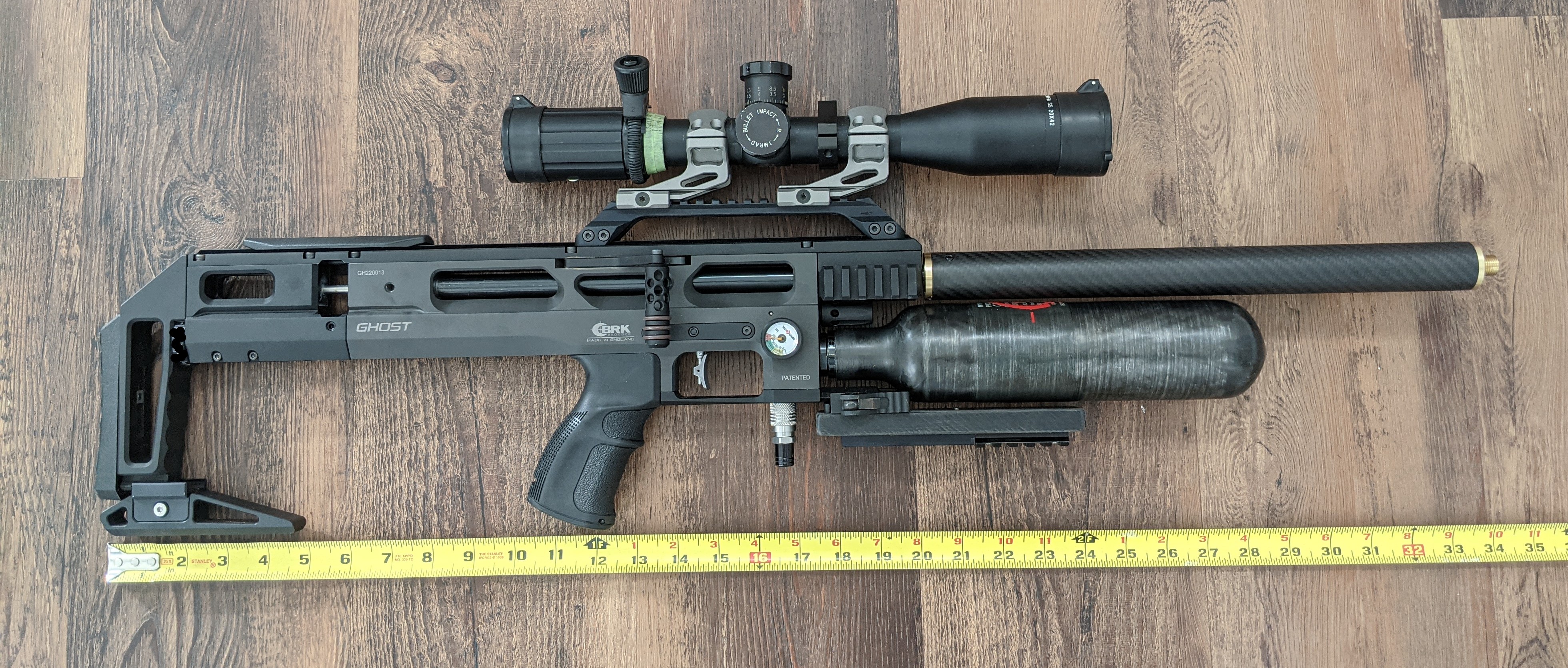

Received a package of goodies for the Ghost yesterday from an airgun buddy. He machined up a custom shroud for the longer .22 barrel and lent me a 480cc bottle. The changes make the conversion from Carbine to Ghost HP legitimate.
Pretty sweet!
OAL for the all-out HP config, WITH the 0DB = 38 inches.
Without the 0DB = about 33 inches.
And with just the shorter .177 Carbine barrel, thread adaptor, and 0DB = 28 inches.
I think this 480cc bottle is probably a happy medium for going back and forth between .177 Carbine and .22 HP. Any more length on the bottle than this and the bottle would stick out past the barrel. But as-is, they're the same length.
I'm excited about and very happy with the changes!

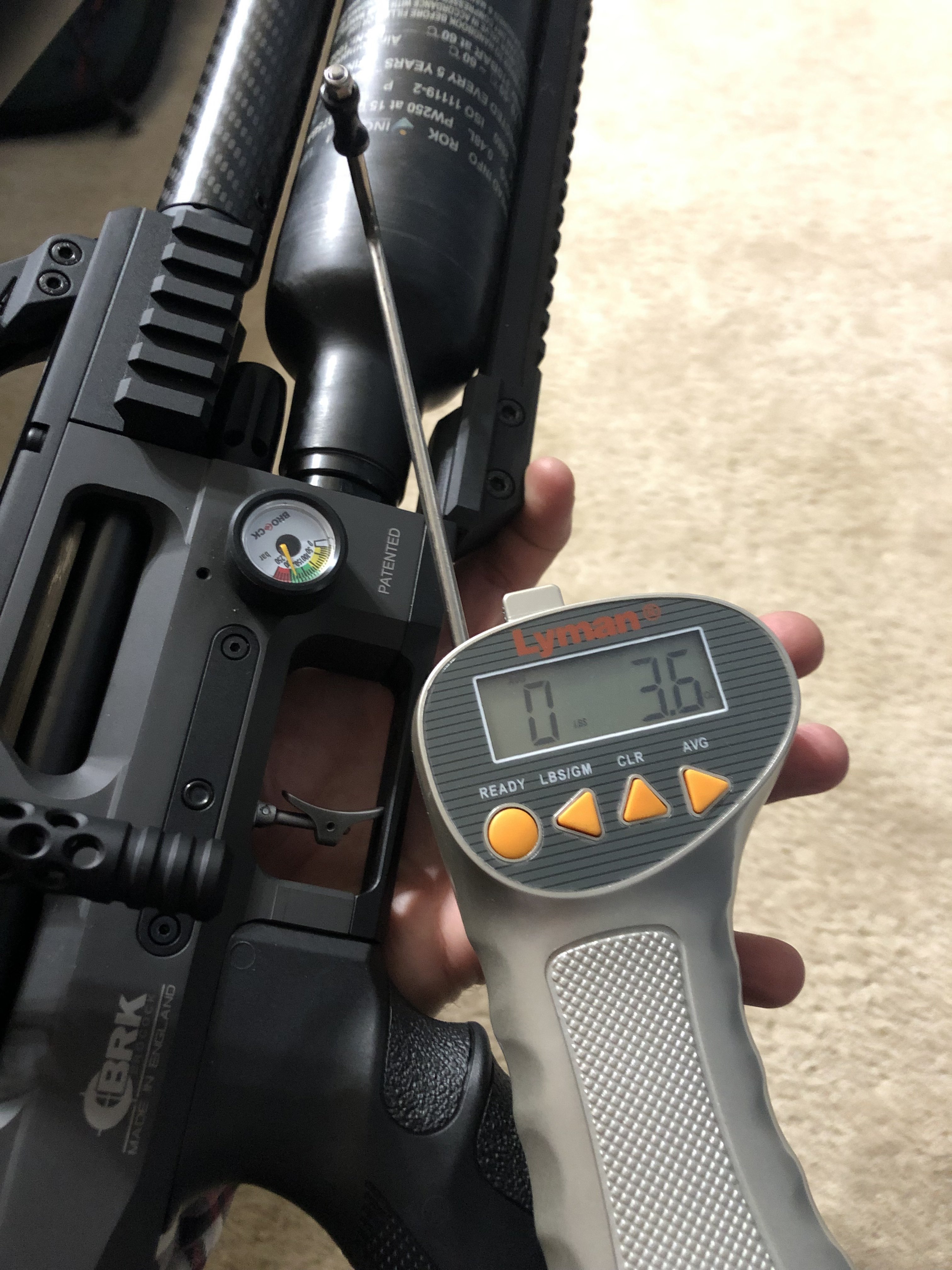

Tuned a .22 Ghost HP. It’s a great PCP. Trigger job came out to average a 3.6 ounce second stage crisp break. Set the reg at 150 bar. 25.39gr MRDs are shooting 970 fps on max. Dialed back hammer spring to setting 16 produced an average of 955 fps and it seems to like this speed best.

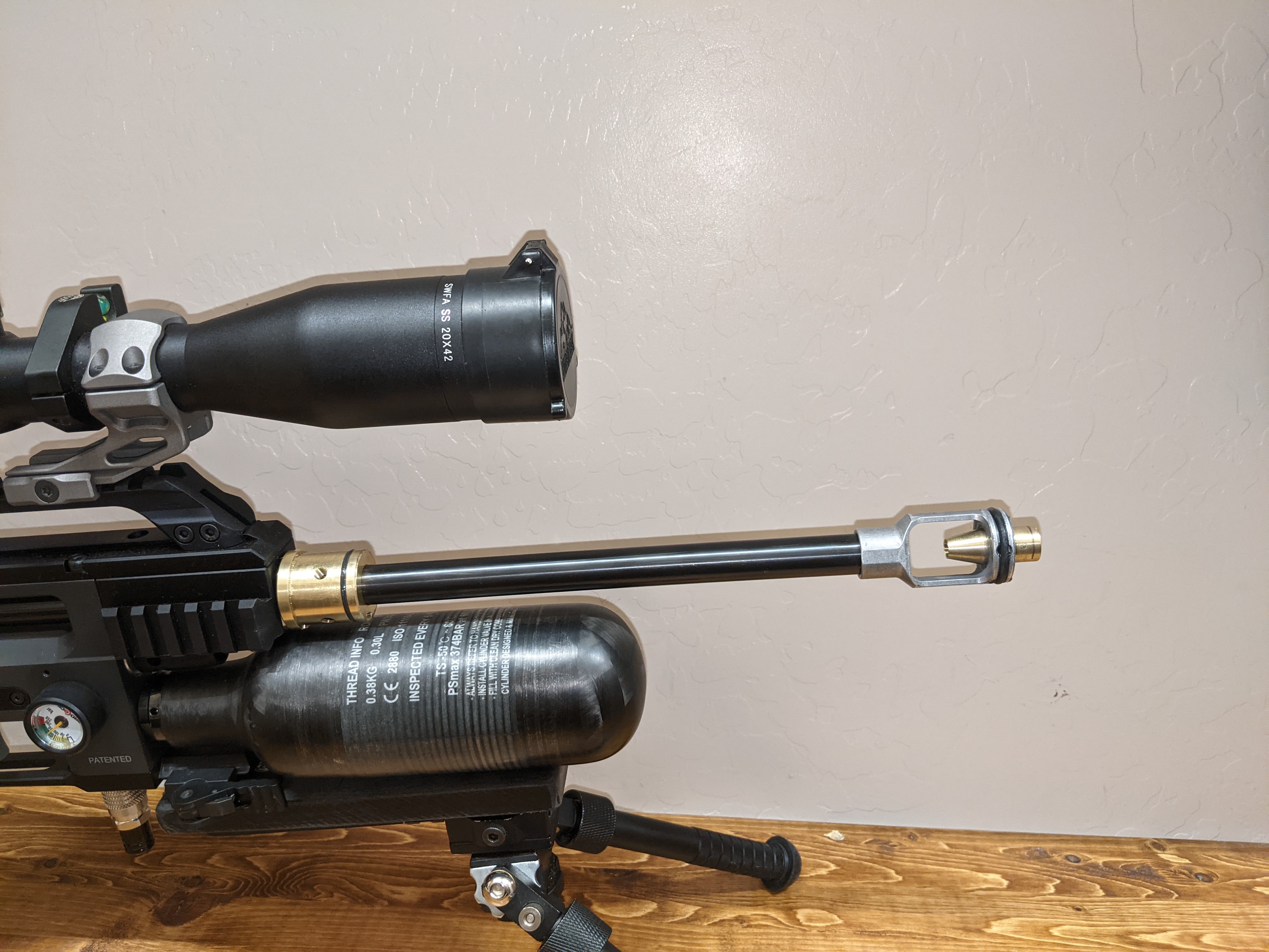

Over in the field target area, @Centercut was asking some questions about the custom shroud that was made for 23 inch .22 barrel. He was curious if it was tensioned and if there was a gap between shroud and frame....here's my response.

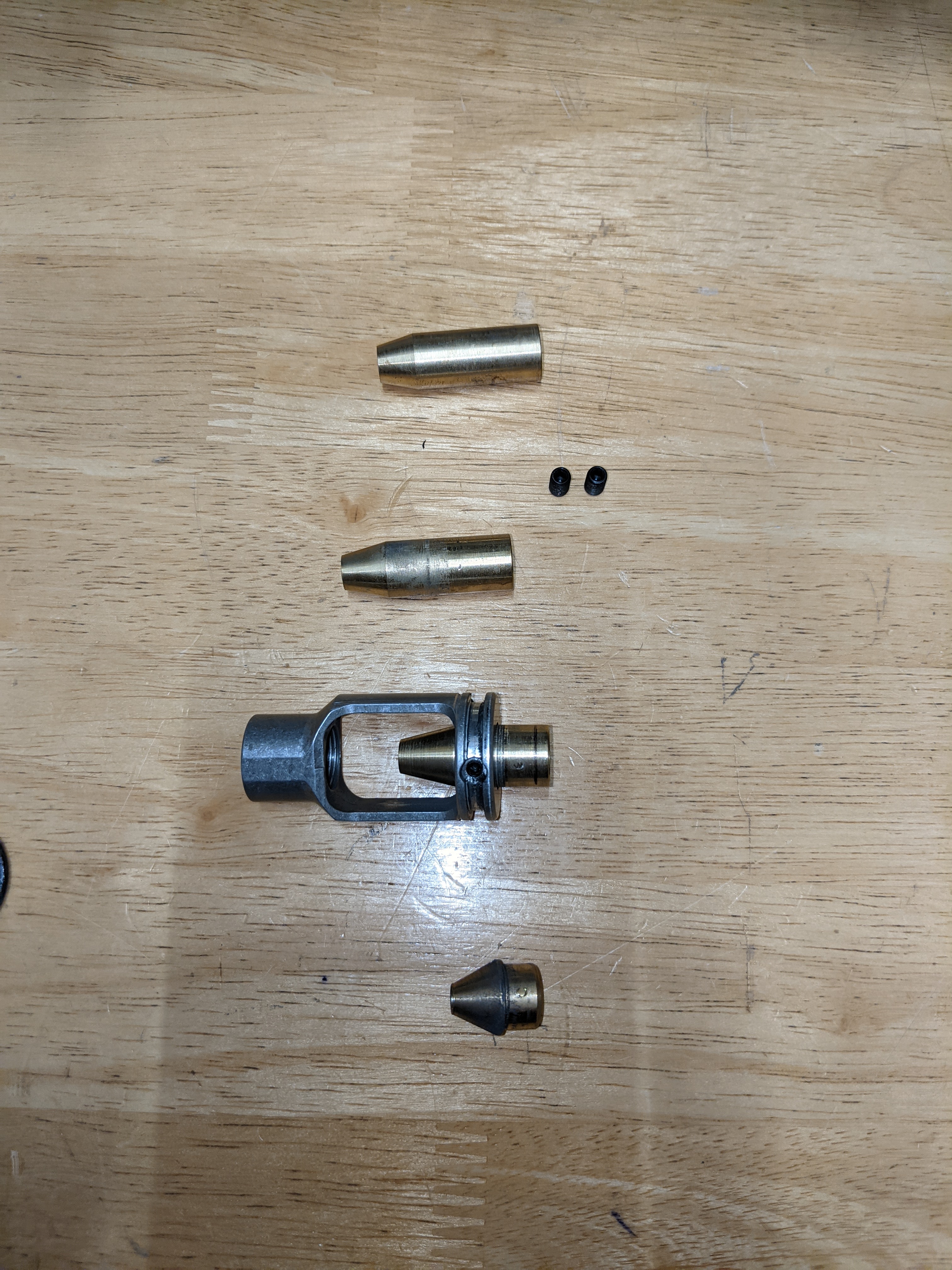

While aftermarket/custom, the shroud is nearly identical to an OEM shroud. It uses the same 4 grub screw configuration to hold everything together at the rear (2 to hold rear shroud collar to barrel, and two to hold carbon fiber shroud to the collar. It has the same channel (as OEM) down the length of the rear shroud collar to act as a rear vent for the air in the shroud. The interior shroud support that threads onto the barrel at the muzzle end is the same as OEM. As far as design and function, the only difference is that it's made out of brass instead of the blued steel like OEM.
A few photos to illustrate.....
As as long as we're talking about the shroud.......
After arriving at a consistent "tune" I worked through my various batches of .22 MRDs and settled on the batch that seemed to produce the most consistent accuracy, After that I searched for further accuracy gains. The first seemed to come from the internal air splitter inside the shroud.
I did some minimal testing with that air splitting cone with various settings. This is aftermarket as well, but had interesting results. As mentioned earlier. the shroud support that threads into the barrel allows for adjustment of the depth of the cone, effectively making an air splitter upstream of the moderator. Kinda unique and cool feature.
The shortest cone is the OEM one that came with the gun as a .177 Carbine set-up. I didn't measure the aperture on that one, but by the crude eye-balling it technique, it'd be too small for a .22, or at least it'd be a mighty tight fit. The longer cones have varying aperture sizes. I quickly settled on the smallest aperture of those 3 aftermarket cones but did further testing with it set to various depths. Accuracy was poor with it closest to the barrel, and accuracy was best with it furthest away from the barrel, like in the photo above. There is enough dead space between the internal shroud support and the distal end cap to allow this spacing, but the cone could not protrude that far from the internal shroud support if I was using the shorter shroud tube that came with the .177 Carbine. There simply wouldn't be enough clearance.

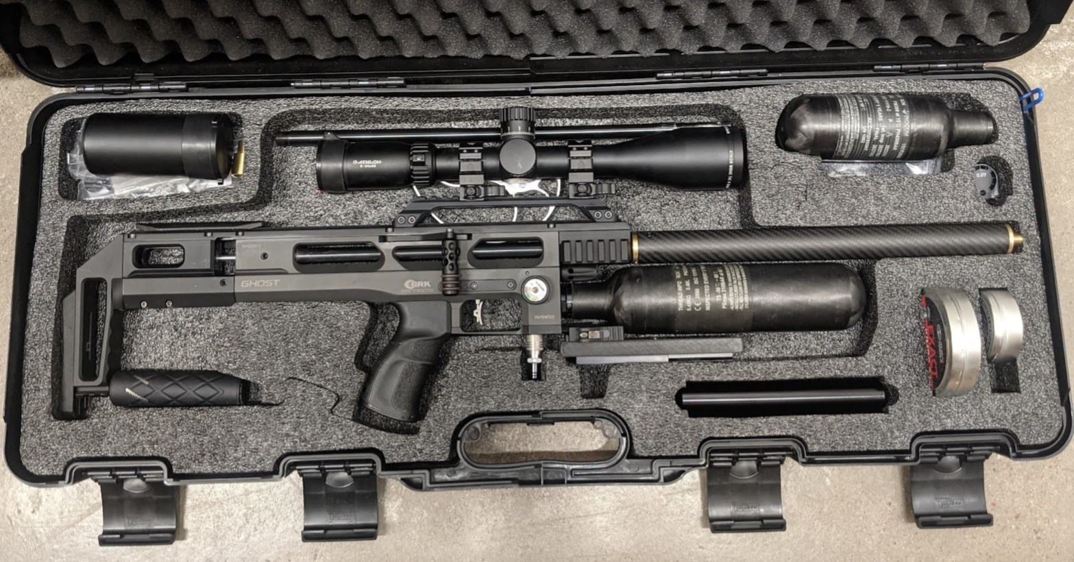

Minor modification of the case for dual set-up
Just a bit of an intro for the upcoming report on shooting in a low power and a high power field target match in the same day....
I made some modifications to the foam in the case to allow inclusion of everything necessary for both the sub20fpe .177 and the .22 high power configurations.
To break it down a bit
  • Upper left compartment has: the (brass) converter to go from barrel threads to 1/2x20, the .177 probe, and the scope sunshade. Sunshade has to be removed to fit in the case. Anybody following along will notice that I did some scope swapping and stole a Midas Tac off a personal gun, figured the Ghost had earned an upgrade in the glass department. You can also see the nautilus side wheel under the scope. I tested to make sure laying the gun/scope on the wheel like this wasn't creating any stress or torque on the wheel with it installed and placed in the case in this manner and it seems fine.
  • Upper right compartment has the 300 cc bottle that the Ghost came with as a .177 Carbine. The valved bottle system is awesome. I've got 780ccs of 250bar air in that case. Enough to shoot each match without any additional air or need for a fill.
    • This is the compartment that needed some foam modification for the bottle to fit.
  • Main compartment of course has the rifle, but also is JUST long enough at the top to allow the 17 inch .177 barrel to lay parallel with the scope.
  • 0db moderator in the main compartment with the gun, and also the longer moderator in the actual moderator compartment
    • The 0db is used with the pictured shroud in HP config and sound levels are acceptable. The combination of the short 0DB, all that volume in the long shroud, the air splitter and the vent at the rear shroud collar reduces report significantly. I shot the high power match with the pictured shroud + the 0db moderator
    • longer moderator (Hogan Decimeater) was used with the thread adaptor on the .177 barrel, no shroud. I tried the shorter 0DB on the barrel alone (again no shroud) and it was too loud for me, even in 20fpe/.177, so I used the Hogan for the sub 20fpe match.
  • The compartments for pellet tins fit large or small tins. Adding a longer-than-480 cc bottle looks like it would require cutting out some foam where the pellet tin compartments are.
  • There's also the long allen wrench on the right side of the case (blue handle). This is necessary for adjustments to the length of throw on the hammer.
I'm tickled to death with how everything fits in this case. Really neat to know that it's all there, no rummaging through cabinets and drawers in the gun room to try to find the various components for each configuration.
