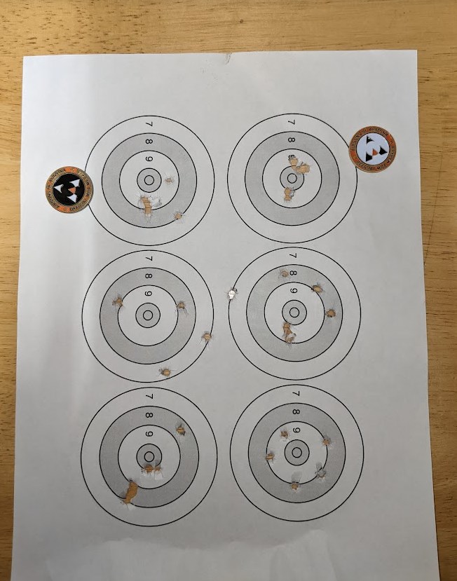

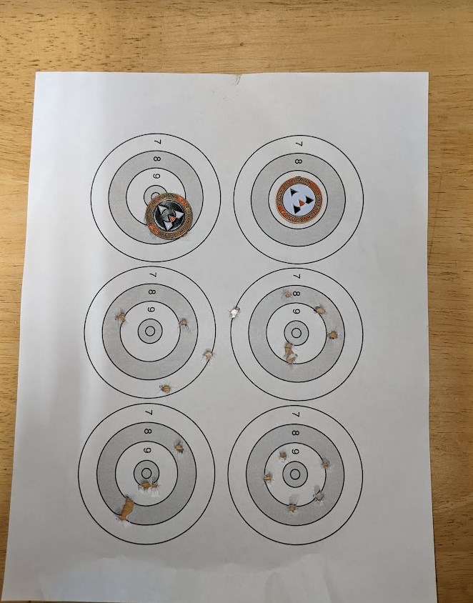

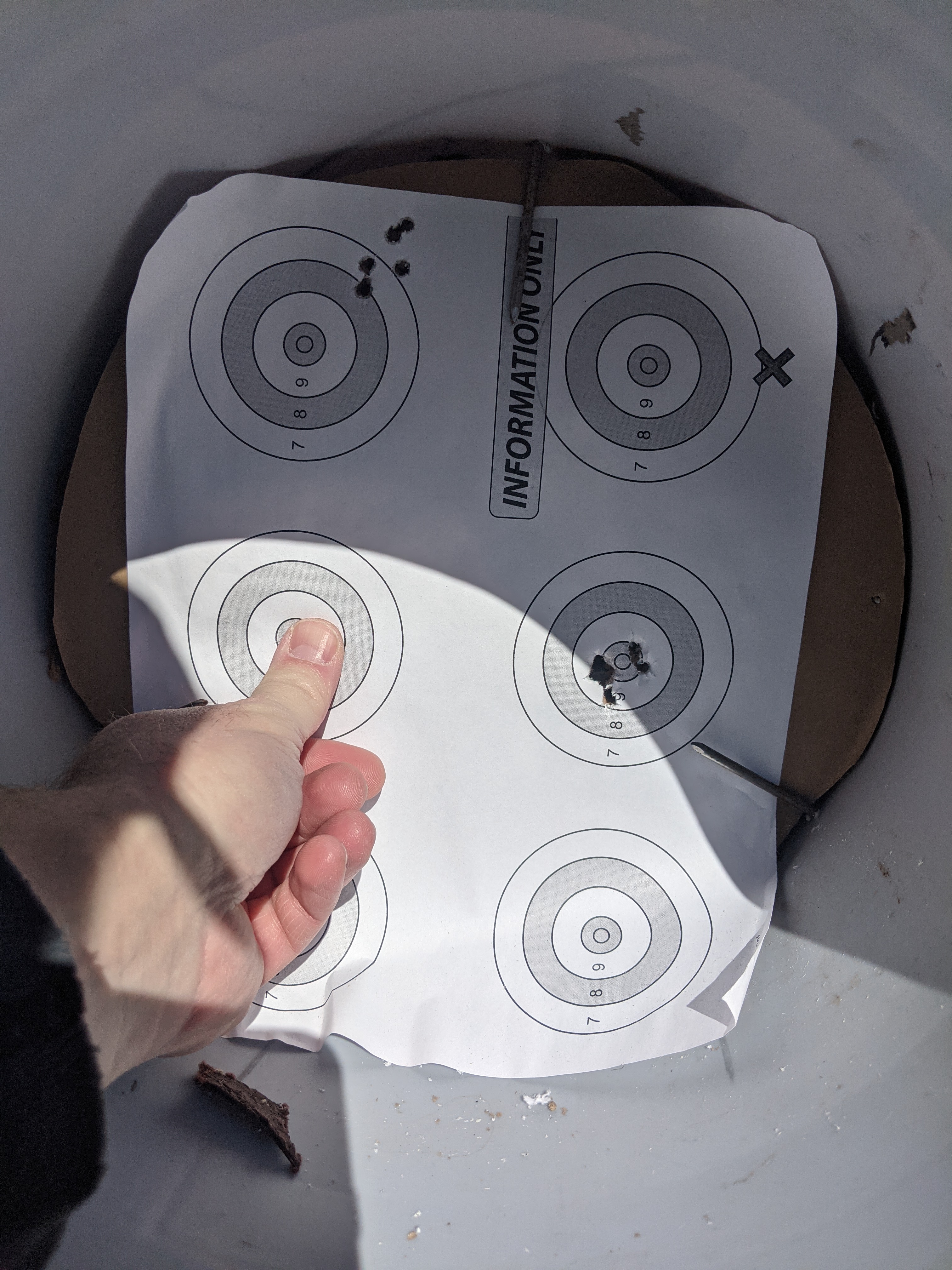

Welp, first 25ish shots on paper with the .22 barrel.
55 yards. .22 Monster RDs at about 48fpe.
Top five were initial five, then adjusted scope down to shoot the right group and there's 8 or ten in there, couple clicks here and there during that group. Then shot the left group, the one in the sun. Ten shots there, no adjustment of scope turrets.
Just a bit bigger than my thumb nail. I can work with this!!!
More to come, got paper set out at 95 yards right now too, but company coming over so we'll see how that goes. First bucket is the 55 yards I just shots, far bucket is on the back irrigation berm. Can go to 140 yards in the far right of this photo, if I get time for it.

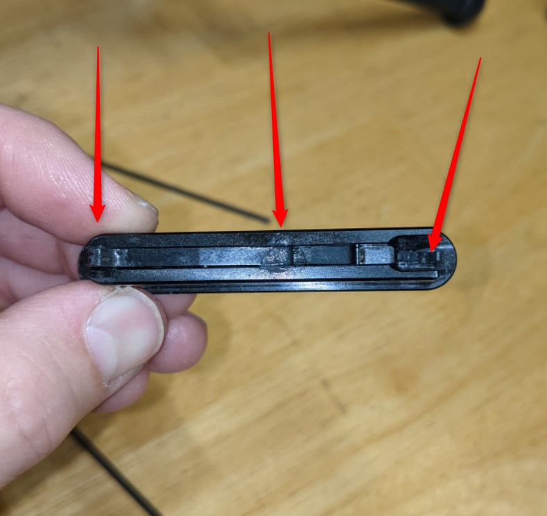

The biggest gains to be had in helping the trigger are on what we've been calling the trigger bar return spring, circled here...

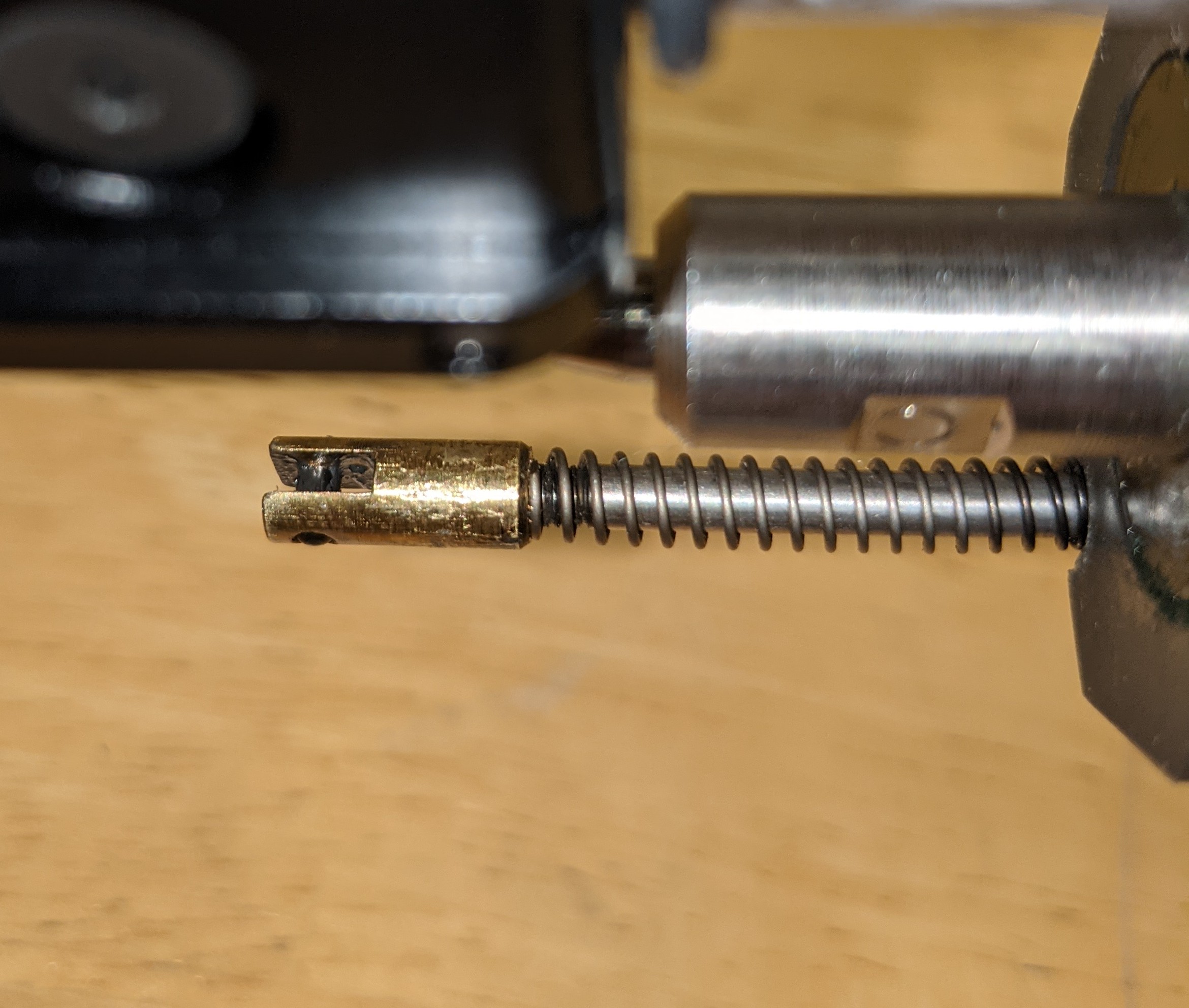

And a photo of that spring.
This is how the trigger cassette "catches" that bar.

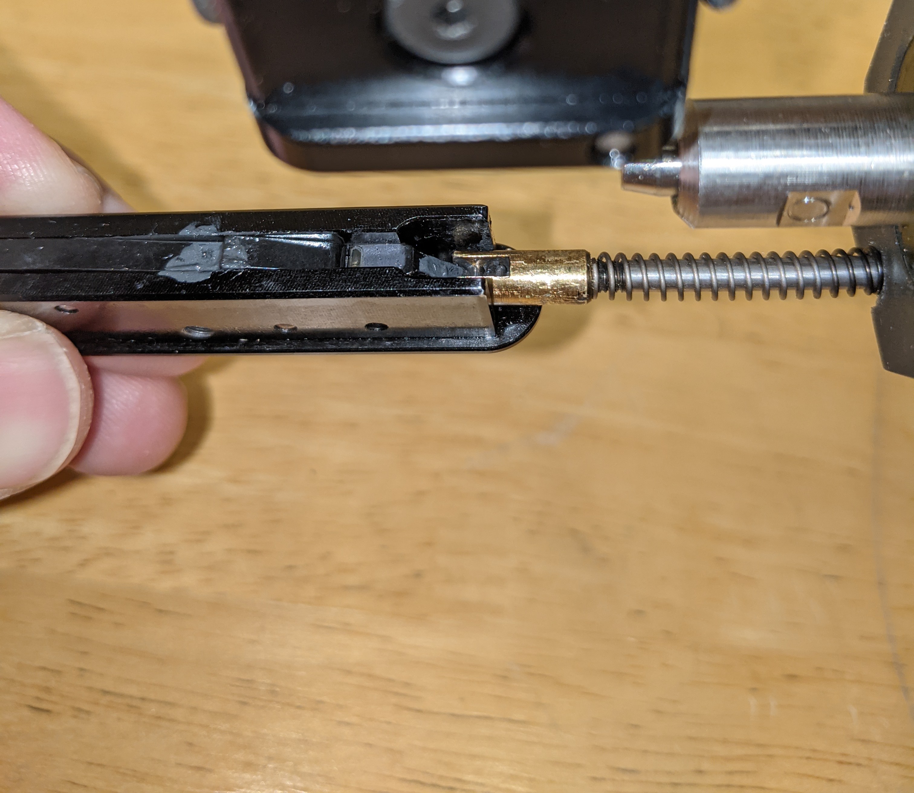

I hate to clip a spring, much preferring to replace with lighter springs so that both ends are finished, but after a failed attempt at sourcing a lighter trigger bar return spring, I did the dastardly deed. I only clipped half a coil at a time, and then reassembled to test the trigger weight.
WARNING-I cannot recommend anyone attempt this!!! If you don't use heat to counteract the thread lock on the brass "eared" piece, you WILL DESTROY IT. (don't ask how I know). And even with heat, that thread lock is serious business. I don't think BRK intended for this to be a user-serviceable part, so fair warning. For the most intrepid, it might be safer to clip coils with wire snips, while leaving the brass piece threaded onto the bar, and then bending each coil off of the bar with needle nose plyers on both side of the snipped coil. Even with that process, you run a high risk of messing something up.
It is also tricky to get that brass piece threaded back on to the exact depth required for the trigger to function properly. So, if you're brave enough to try, take careful measurements.

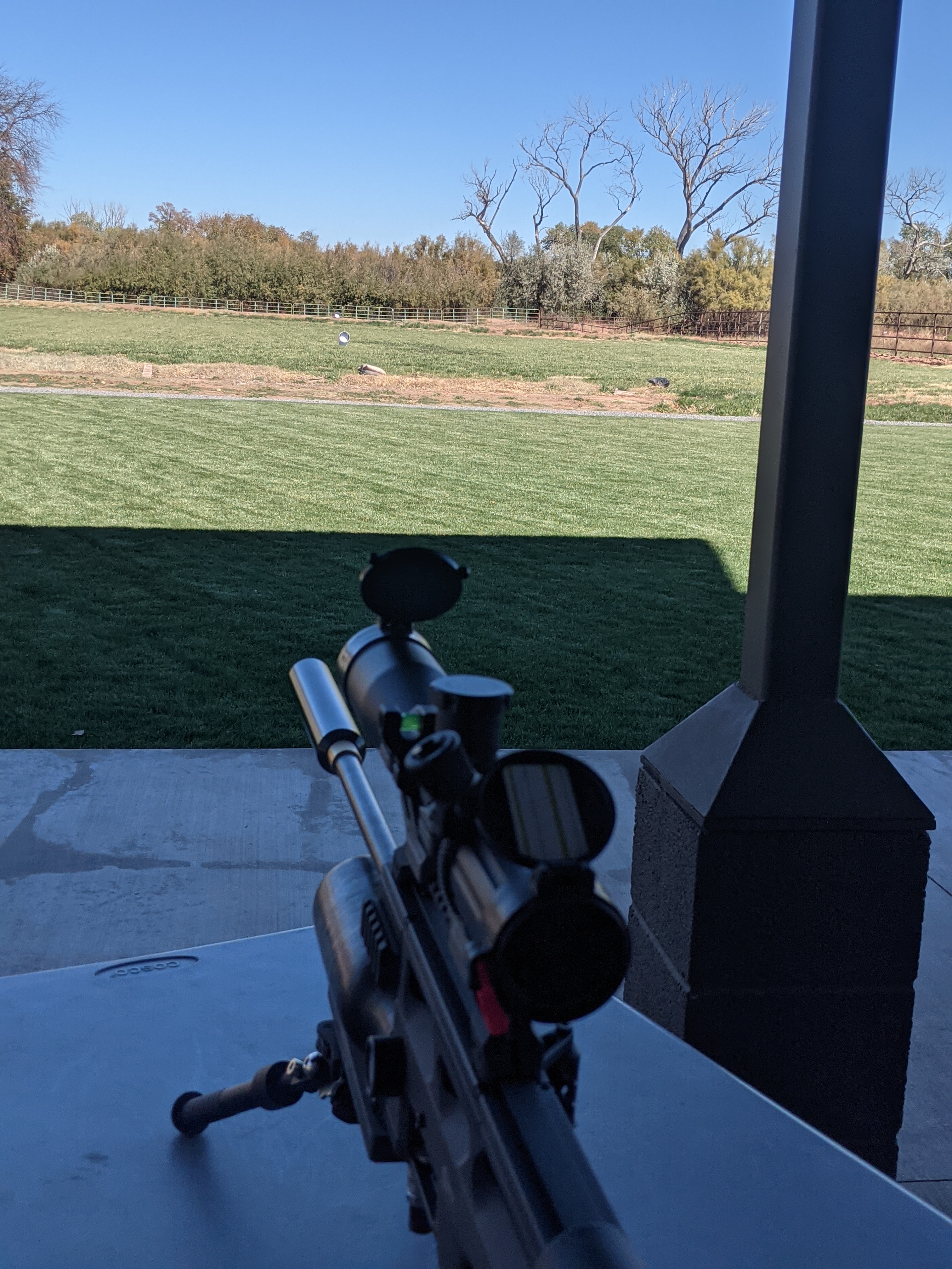

I was able to get 2 fills shot through the gun at 95 yards today.
The first 4 shots were taken by my nieces fiance, his first experience with any sort of PCP. They were the company coming over that I mentioned earlier. He saw the Ghost sitting there on my high quality bench on the back porch and expressed some interest. I told him to plop down and take some shots. I figured he'd go for the 55 yard trap but he blew dirt up right in front of the 95 yarder. I chuckled and told him lets give it about 25 clicks on the elevation turret, knowing that it was sighted in for 55, and that 25-30 clicks (1/10th mil) is usually just about right for 100ish yards with any diabolo going around 915-920. He proceeded to shoot another 3 shots and acted impressed with the results. Of course I couldnt see how he did at that point but he excitedly threw a bunch of questions at me, and I enthusiastically answered them. And then we went on with their visit, returning inside the house.

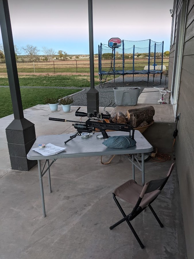

Here's my super stable bench set-up.
Later that evening I took a walk down range to add another pellet trap next to the one already there. I was surprised to find that he'd shot at least three 8's and probably one of those would plug up to a 9. Laughed to myself and shook my head. He'd done pretty good!
I went ahead and shot another 3 at the the target right below my future....nephew-in-laws? group, and then moved over to the other bucket and shot 6, 5 shot groups. I was still above reg pressure and moved back to the first paper and shot another 2, 5 shot groups (circled in red on right side).
So 46/47 of those shots from that first fill are on this paper (his first shot hit the dirt b/c I didn't have the elevation dialed into the scope for him).
These were all taken with a batch of MRDs that is so-so, not best I've come across, but certainly not the worst.

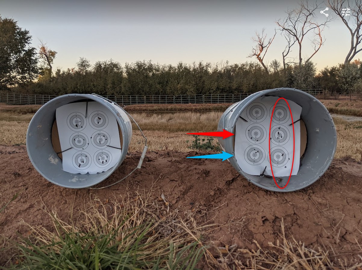

The red arrow is pointing at nieces future husband's group.
The blue arrow is pointing at my sighters.
The red circle is around the last 2, 5 shot groups I took, at the end of the fill.

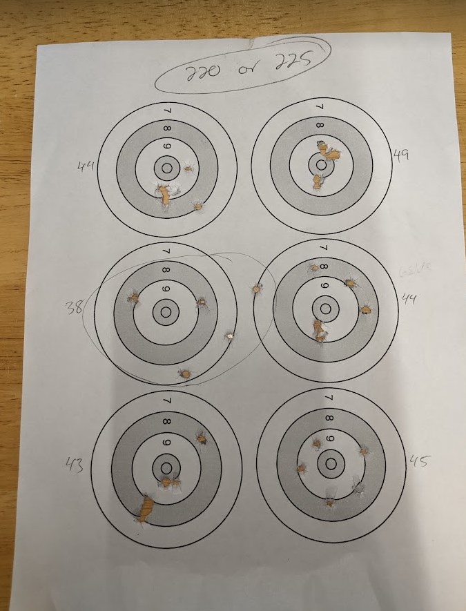

But back to the reason you guys are reading this.....accuracy results!
There were a couple of MOAish 5 shot groups in there ("ish" b/c it was 95 and not 100 yards and if you look close you can see the edges of the holes peeking out from under the coin).
This is what it looks like scored. The "or" is totaling it with inclusion of either lowest 5 shot group.

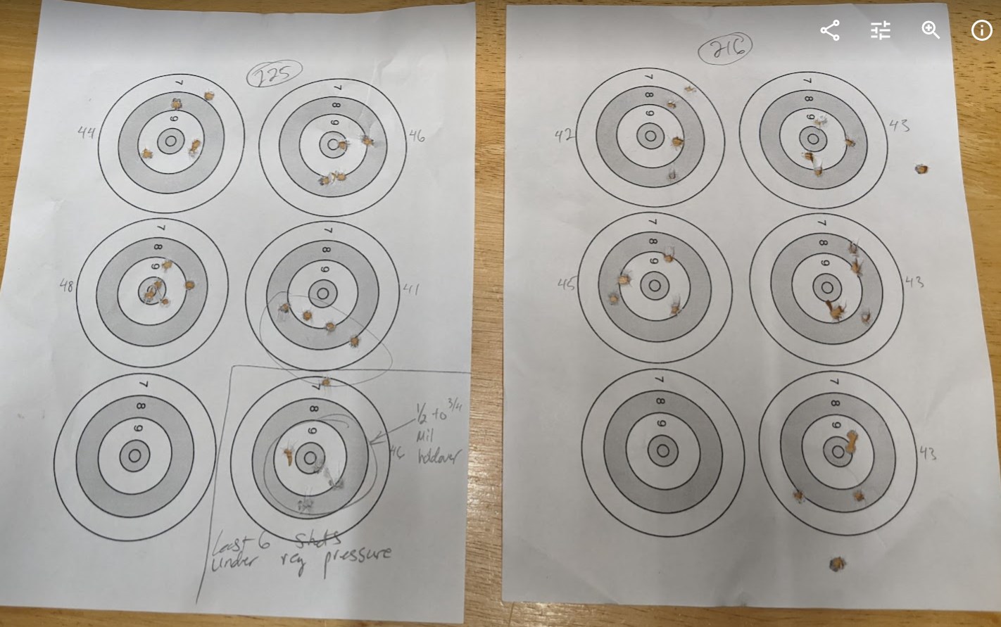

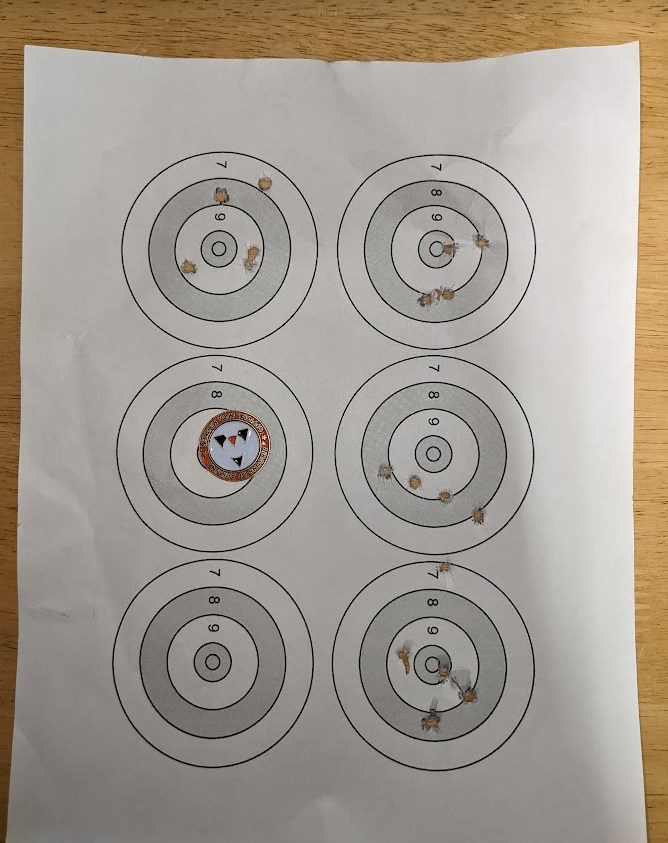

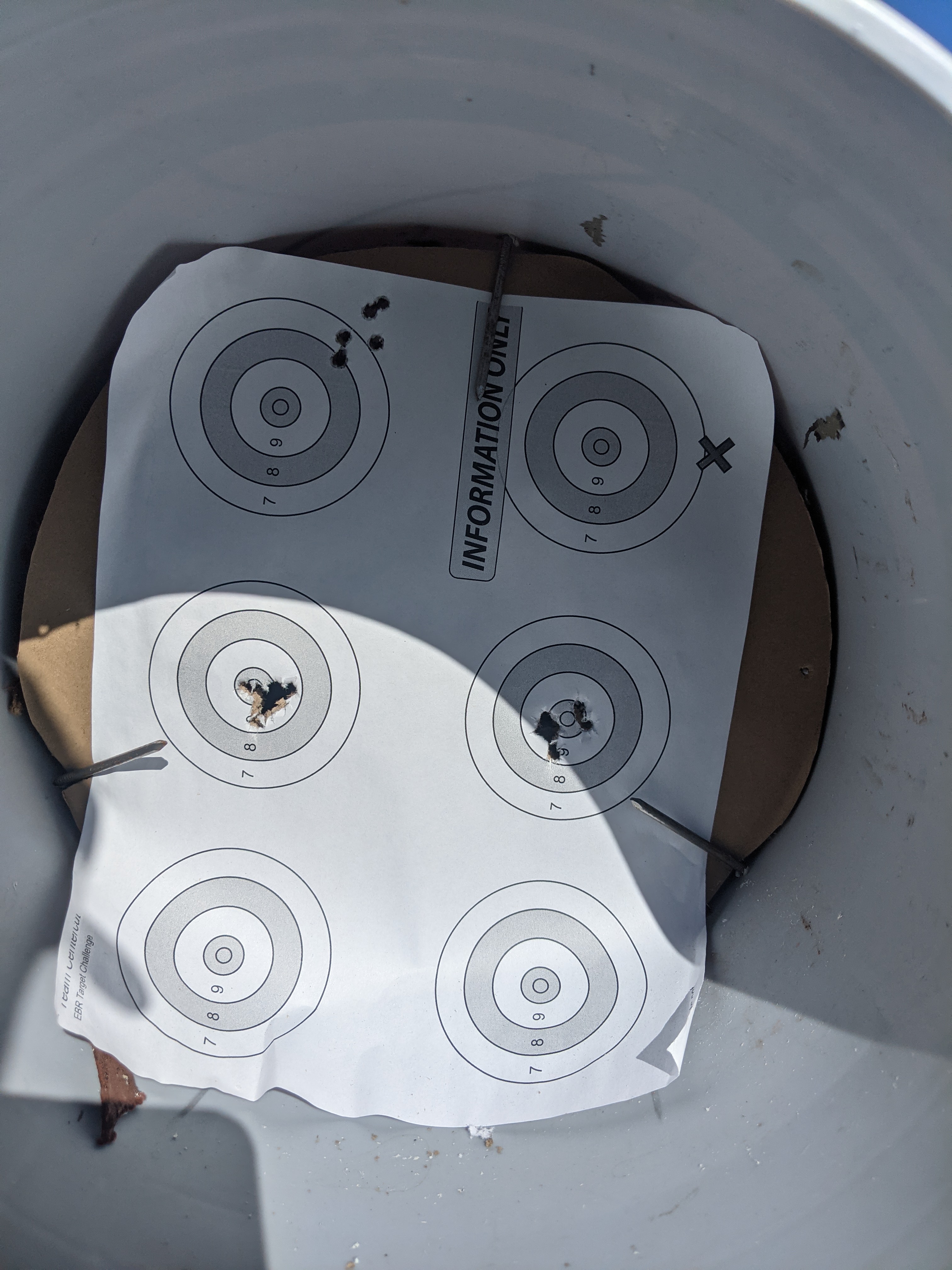

I filled the gun up again and shot another 2 cards as well. All shots taken are shown here (no sighters). All from one fill. These 50 shots are with my best batch of MRDs.
The card on the left was taken last. If you look at the middle target on the right column of the left card (the one that scored a 41) you'll see that low shot down into the next target. The gun was off the regulator here and that's why the shot struck low. I made a box around all 6 shots that were off the regulator. In order to get those last 5 shots to roughly center on the bull I started holding about 1/2 mil high, and kept holding just a bit higher with each shot, eventually getting up to around 3/4 mil holdover, knowing the shots were decreasing slightly in fps as I kept going, trying to stretch a full two cards out of one fill of the gun.
One of those in these two groups was MOAish also, the 48 (photo taken before I wrote all over it).

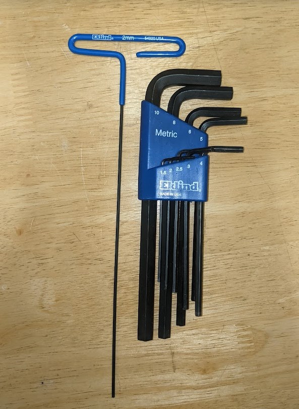

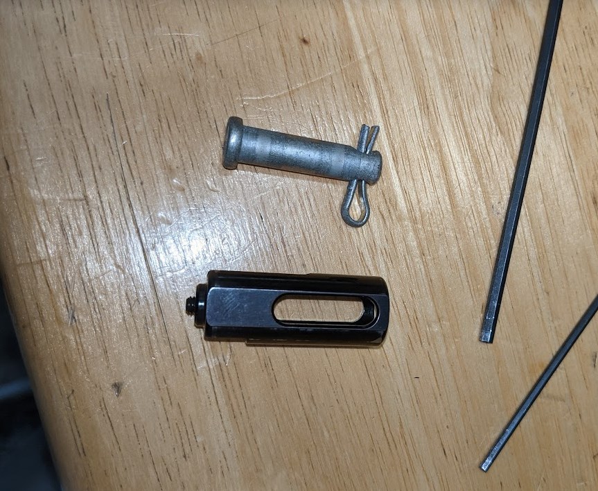

I've wrenched on the Ghost A LOT!!!
And this has been all that I've needed,
The long 2mm is necessary for reaching the threaded nose of the hammer through the rear of the gun without disassembly (although this one is a couple inches longer than it needs to be).
Now, I know some of us geek out on tools, and I realize Eklind is on the lower end of the quality spectrum, but it's not quite harbor freight, and I've gotten a ton of use out of his little set. This set and range of sizes is everything needed for the Ghost though (minus the loooong 2mm).
On this same topic, you can start to see the quality of an airgun through multiple disassembly/reassembly sessions. Take Crosman/Benjamin for example, I started with a 1377 pumper and then a Benji Disco was my first PCP. Love the heck out of those two guns, still have them both. BUT, after just a couple take-downs, fasteners start to get pretty loosey/goosey. The metal in them just isn't of the caliber that can handle much of that, in short, soft.
Now, take the Ghost, everything tightens up nice and snug still. None of the allen key heads are even starting to open up/round off. BRK used some pretty high quality steel bolts as all the fasteners that I've touched (and I think that's pretty much all of them at this point). Another cool thing I noticed in the last hour or two, as I took the rear subassembly off and on at least 6 times....that grub screw that attaches to the rear of the valve has created an exactly perfect, concentric circle in the flat that it affixes to on the valve. Ie, there's just not much slop in the parts, they fit together so nicely, that time and time again that grub screw lands in the same spot. And this is definitely a place where tolerance stacking could be expected, because we're not just talking about two pieces mating together, but multiple pieces affixed together to create that sub-assembly. In fact, I even pulled the valve and once it went back in, same little circle created by the grub screw on the valve flat, not even the smallest thou of difference where that grub screw circle lands. And it has done that over and over and over and over again. Pretty sweet. The Ghost is machined well folks.

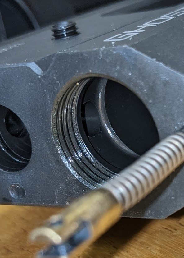

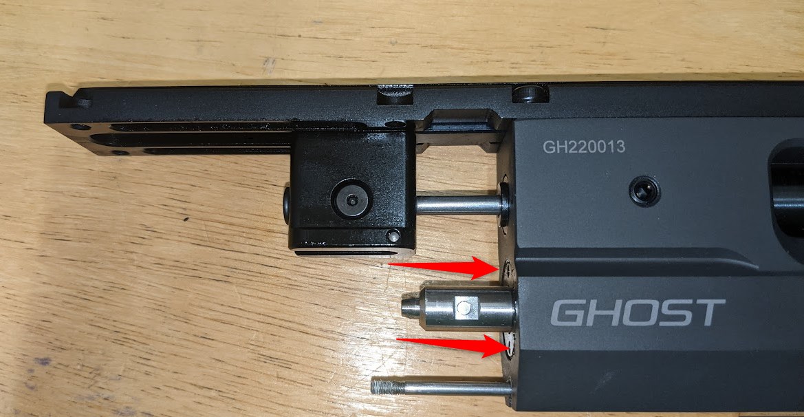

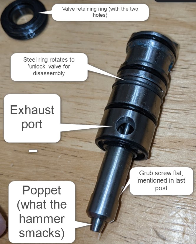

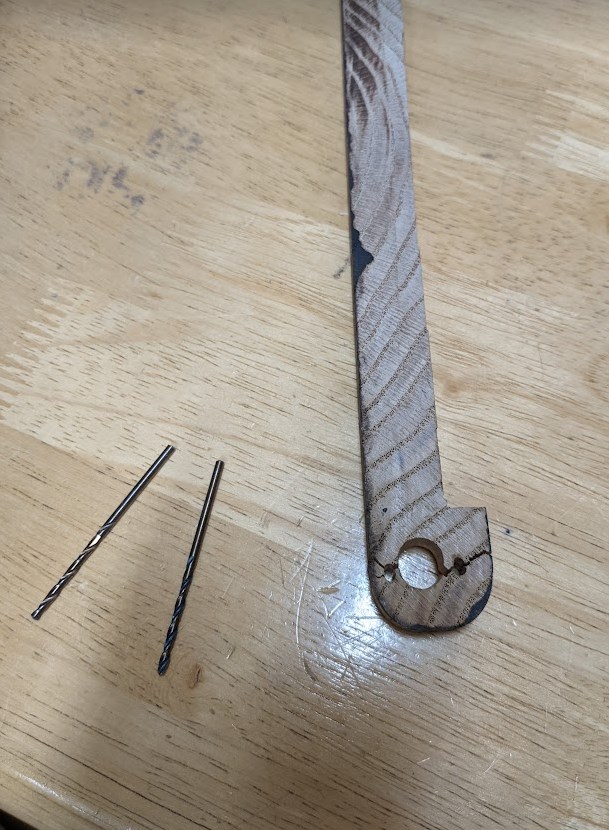

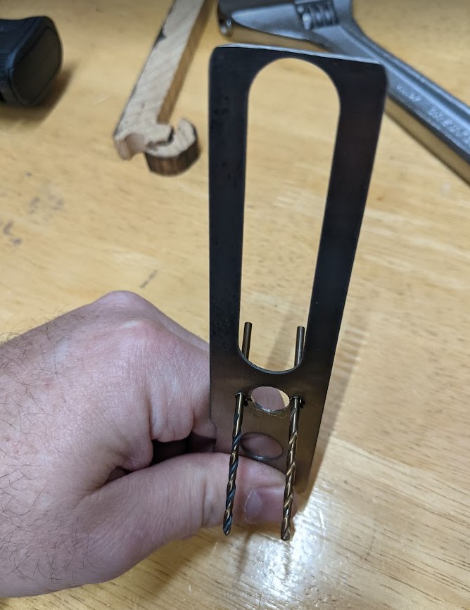

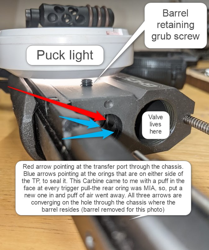

To pull the valve, the valve retaining collar needs to be unthreaded. There are two holes in that ring that allow it to be rotated. Somehow this is the best photo that I've got...red arrows pointing at those two holes.
Bob told me he was able to get his with two appropriately sized drill bits (the smooth shanks, not the cutting tips), and a crescent spanning them. The problem with that technique on mine was that the two holes were also aligned with the trigger return bar and there just wasn't enough room in there to make it happen.
Now, Daystate/BRK has a nifty little tool to make valve removal easier, but there's not one of those at my house.
So, improvise!!!
My first attempt was a piece of scrap oak. It's a slice of a stair tread from redoing the stairs in the big house remodel. Went to the scrap bins in the woodworking shed and thought that sweet little bullnose would be just perfect. It's more than 1/2 inch thick so thought it'd do the trick, but nope, split.
Next, shim material from an experiment with bedding a Red Wolf action in the stock better......
PAYDIRT!!! That worked a treat to get that valve retaining ring loosened up. My little tool wasn't/isn't pretty, but it worked!

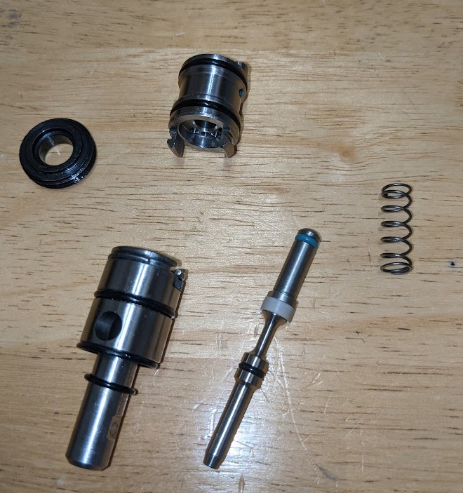

So, here's what we had....
That ring has been rotated here....

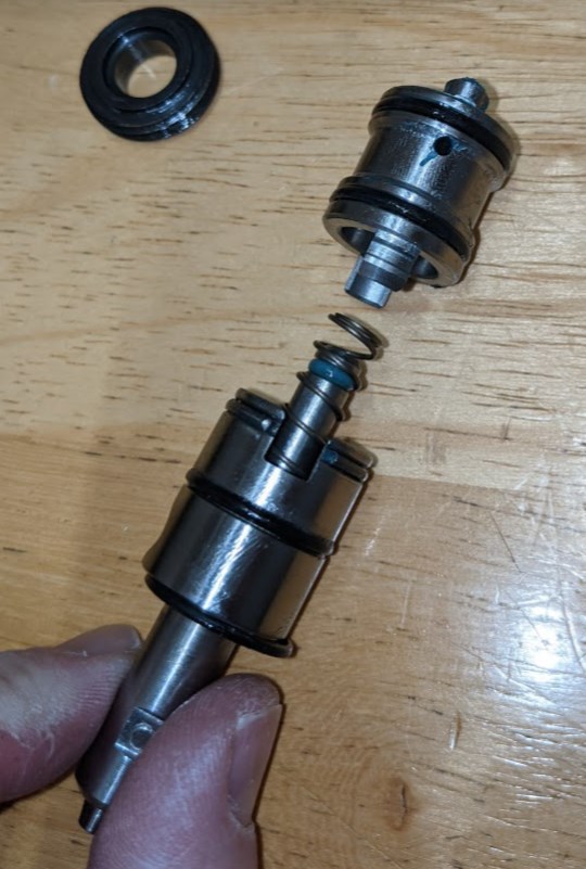

And then just pull the halves apart....
Valve innards...

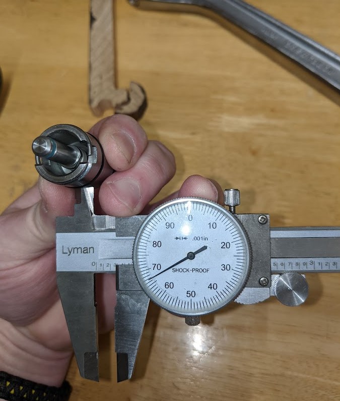

Sent a few of those photos to Bob and he said it all looks in order but let's measure the exhaust port, "should be 0.267" he says.....
Yep, 0.267"
"How does the air passageway through the chassis look?"
"Bout the same size," I respond (too hard to actually measure in there but here are some photos....
This is just the end of the transfer port proximal to the valve (above photo is end of transfer port proximal to barrel).
So, valve is identical to the valve in the HP configuration. Porting is all the same, in both the valve and the chassis. That's a relief....but what the heck is the problem with why this .177 Carbine conversion to .22 won't produce the FPE?!?!?!

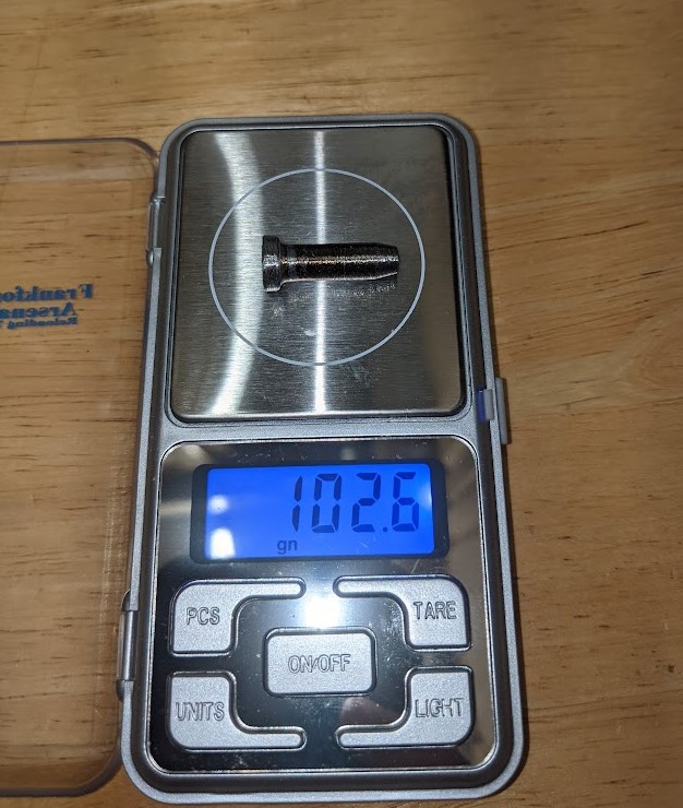

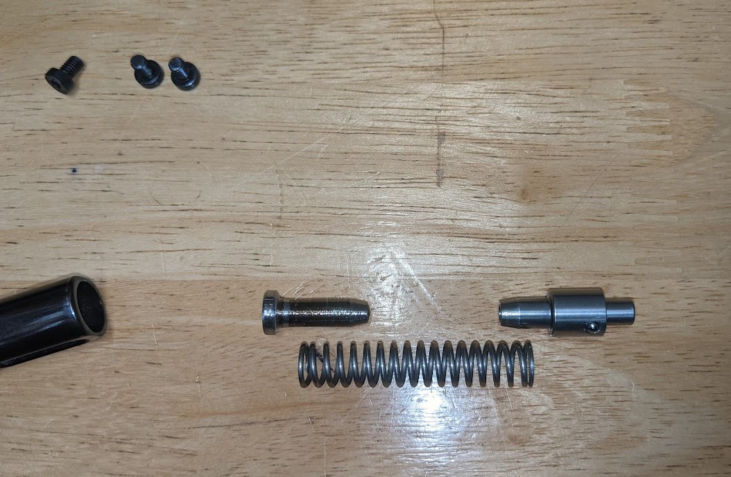

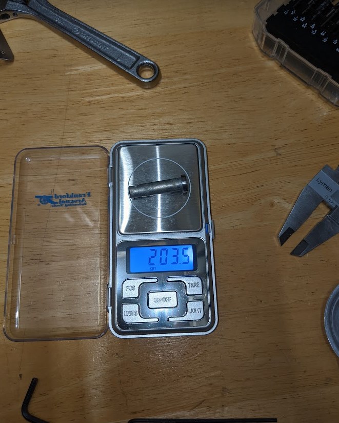

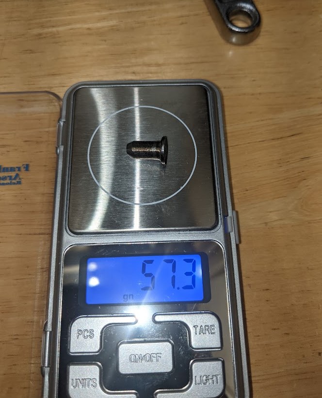

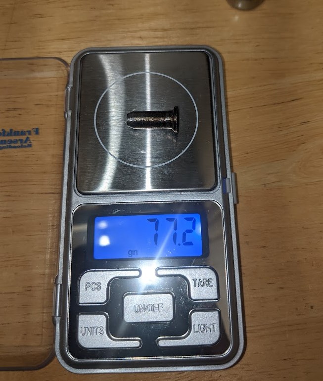

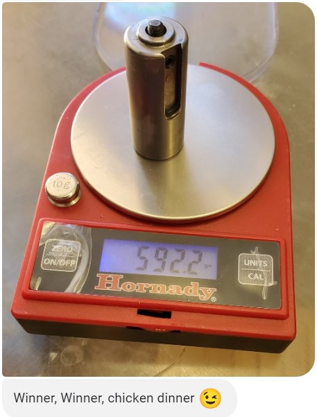

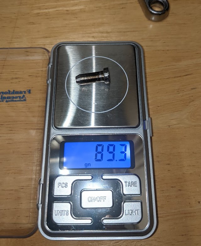

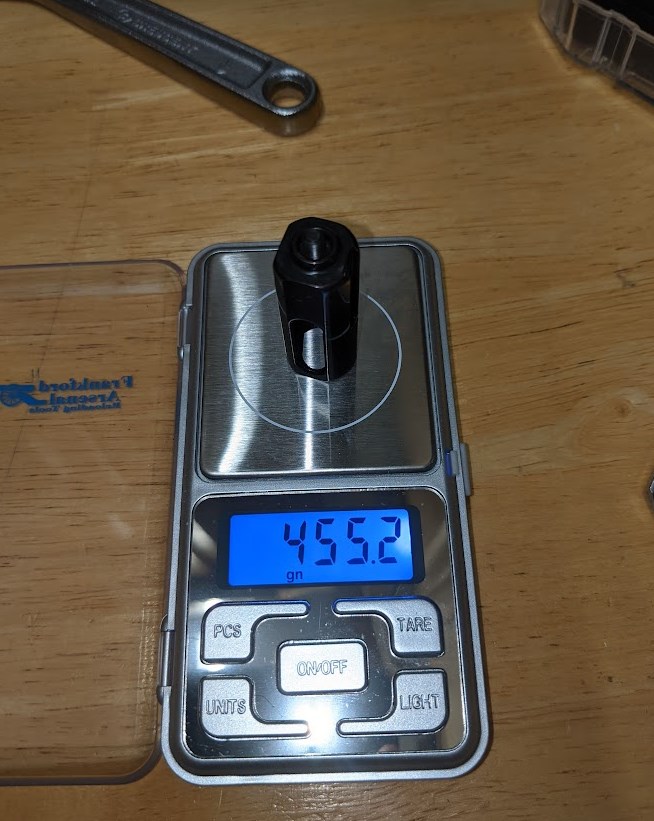

He texts back at this point, "that really only leaves the hammer mass."
I responded, "Your hammer seems .more solid than mine. Mine has cut outs. " (He'd sent me a photo of his hammer a few weeks ago).
Next I get this from him...
I couldn't get my rear sub-assembly apart quick enough!!!!!

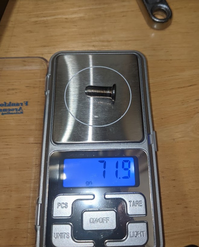

Winner winner chicken dinner indeed!!!! Mystery solved. The hammer that comes in the HP models (and probably? the Standard) weighs 137 grains more than the hammer that comes in the .177 Carbine. And it's obvious in those photos. The Carbine's hammer is skeletonized, AND it has flats running down both sides. The BRK/Daystate engineers had to do some serious slicing and dicing on the hammer to get it down to appropriate for .177/20 fpe, a testament to the power their valve can put out, if nothing else.
Mystery Solved
The Carbine hammer weighs only about 75% of the hammer in the HP models, AND they still had to use a thinner wire spring to TAME THE BEAST THAT IS THE GHOST into a sub 20 fpe .177.

Wasn't five minutes that I shot out a request to AOA to see if they've got a spare hammer from a Ghost HP floating around the shop. The response, they'll look and see and let me know.
But in the meantime......I wanted to see if I could jerry rig something into creating a heavier hammer so I could throw some over the chrono and see what we've got. We knew we needed about 137 grains.....I found this in a random bin of stuff and thought with some reshaping I could maybe make a sort of spring guide/weight, with the flange keeping it inside the hammer.

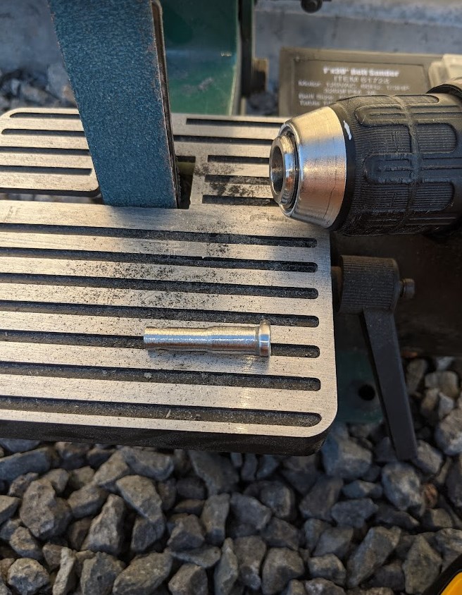

I'm deep enough into this airgun craziness that I need a lathe, and I've been researching here and there trying to figure out what to go with, but for now all I've got is a Bubba lathe (belt sander and a hand drill). Where there's a will, there's a way.
This was my first attempt. A little light but I knew I'd have to cut it short to get the gun to cock. I also knew I'd be adding some preload with the flange.
I also tapered the end, similar to the angle of taper found on the OEM spring guide.
Put it together and NOPE, way too long, wouldn't even come close to cocking. So, more cave man machining.
Put it together again, and NOPE, still won't cock. So more "machining." Thinned up the flange a bunch this time.
Still wouldn't cock...Sigh.
Put it together again and it would just barely cock, but only with the hammer spring tension on minimum. Wouldn't cock with any more preload than that. Knew I wanted more adjustability so went crazy this time, cutting it back quite a bit.
Put it back together and now we're talking, I could get it to cock from "MIN" all the way up to "14." Wouldn't cock past that though.

The .177 HP has the heavy hammer I had mine out because I could not break the retaining screw for HT adjustment loose without putting heat on it. I have looked at the pictures several times and never noticed the difference in the hammers. I also lost FPS by extending the HT screw. The light hammer is something SorenDrost will need to address if he wants to get the most from the long .177 barrel. Thank you for this post, it has been very help full.
