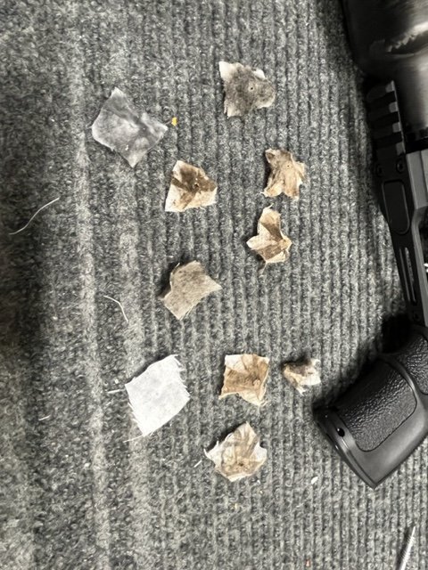

Back home I go to pull the barrel and do a thorough cleaning this time. Here is what I found...Nasty gunk!!!!! Used Gunzilla and JB Bore Paste. It took about 45 minutes to finally get the white patch in the picture.

I believe that is the bore preservative that BRK, and quite possibly most manufacturers, applied to protect the bore from corrosion when it shipped, as the gun had to travel via ship--thus, the salty air--to the dealer. You'd be surprised how quickly steel rusts in salty air. Unprotected steel can start rusting even in a day in such type of air. That brown gunk is also what was on mine. I had to scrub it all out with a bronze brush and Breakfree CLP and JB Bore paste.
