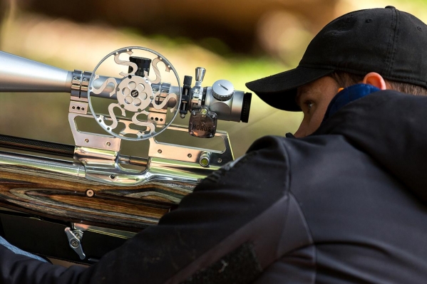

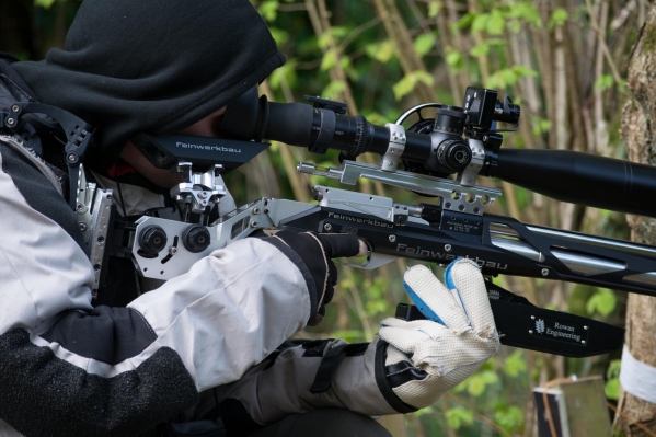

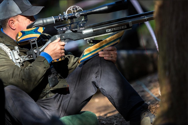

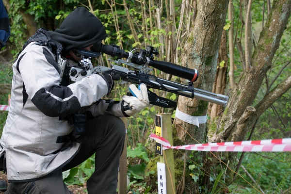

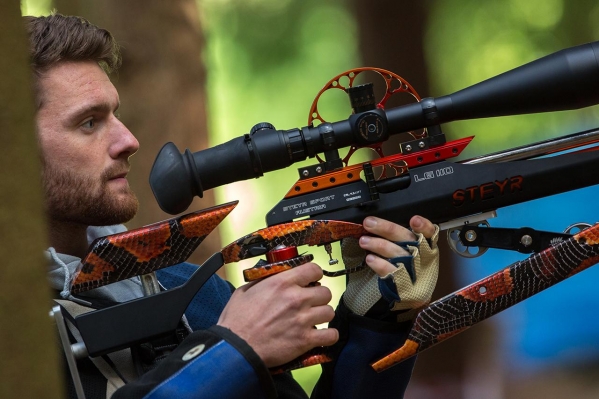

"Skip-in-WV"Wow. Some of the scopes are mounted extremely high. I wonder how it effects holdover or clicking? When I tried a very high mount my clicking went from one turn to two and a half turns. It was very confusing. When I tried using holdover I couldn't get enough if I used the horizontal reticle.
Skip-in-WV, look at section 6.4 below...
"It's a common myth that the higher the mounts are, the more the canting error is, but this is not true. The shots from a canted rifle will impact along an arch, and the displacement of the pellet impacts depends only on the angle of the canting and the pellet drop at that distance (see Fig. 1 in chapter 6.1.). A detailed article about this question can be read here:
http://www.szottesfold.co.uk/2012/03/high-scope-and-canting-end-of-ancient.html with test results and theoretical proofs. There are some exceptions with a certain aiming method (see link above) but this is not used in FT shooting.
The height of the scope has nothing to do with this. Why? It's proven by tests and can be proved theoretically, too - but now simply imagine a rifle with more scopes mounted on it, one above the other. Each scope is zeroed at the given distance, each sight line looks at the same point, where the gun will shoot. If you cant the gun with an angle, you might aim through any of the scopes, lower or higher, they look to the same point, the gun underneath will be in the same position too, so the canting error will be the same. The canted shots move along a circle and the amount of displacement depends only on the pellet drop (d) and on the angle of canting (a). It doesn't matter how high your scope is, you always have to pay the same attention to avoid canting the rifle.​"
