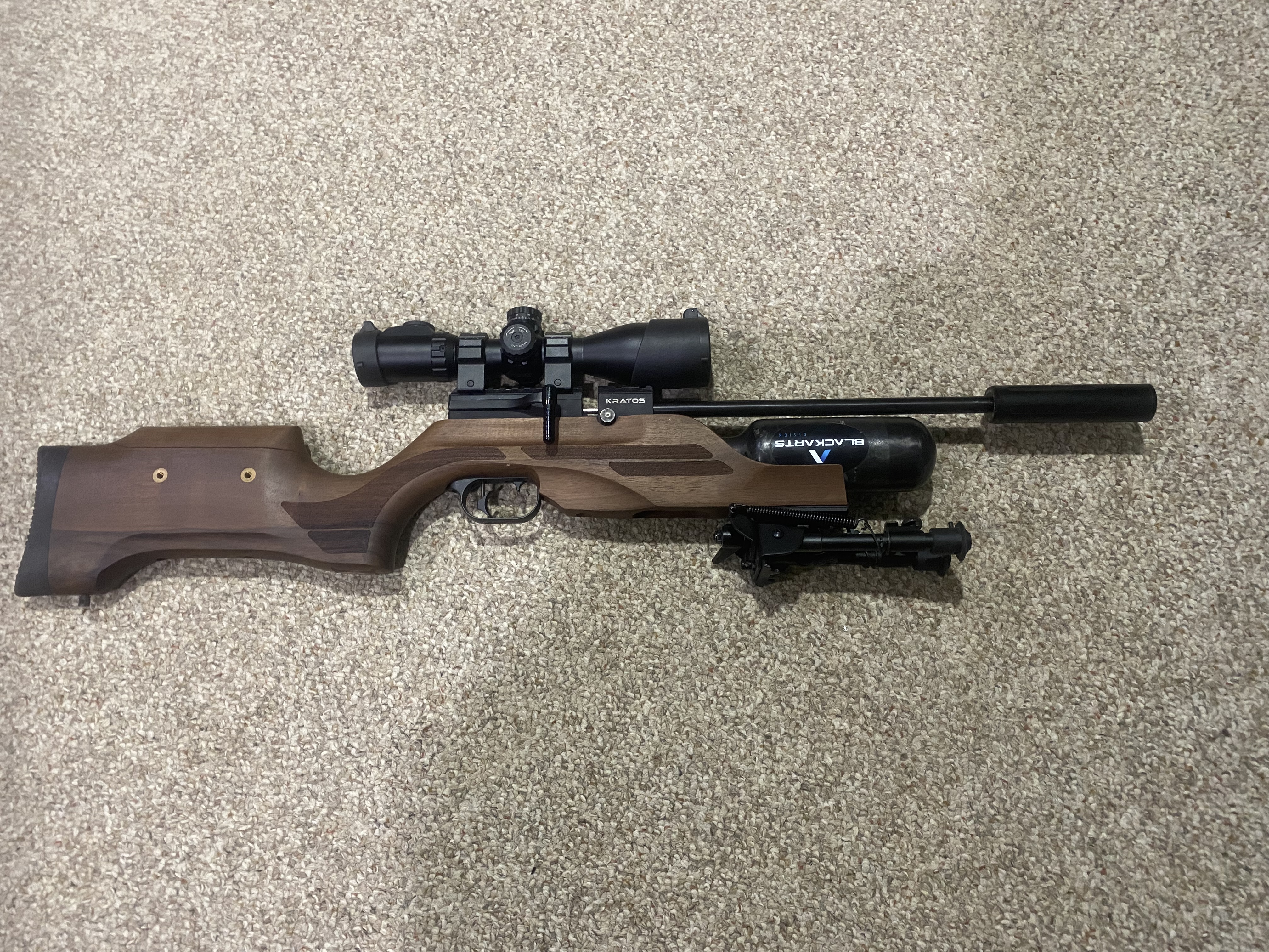

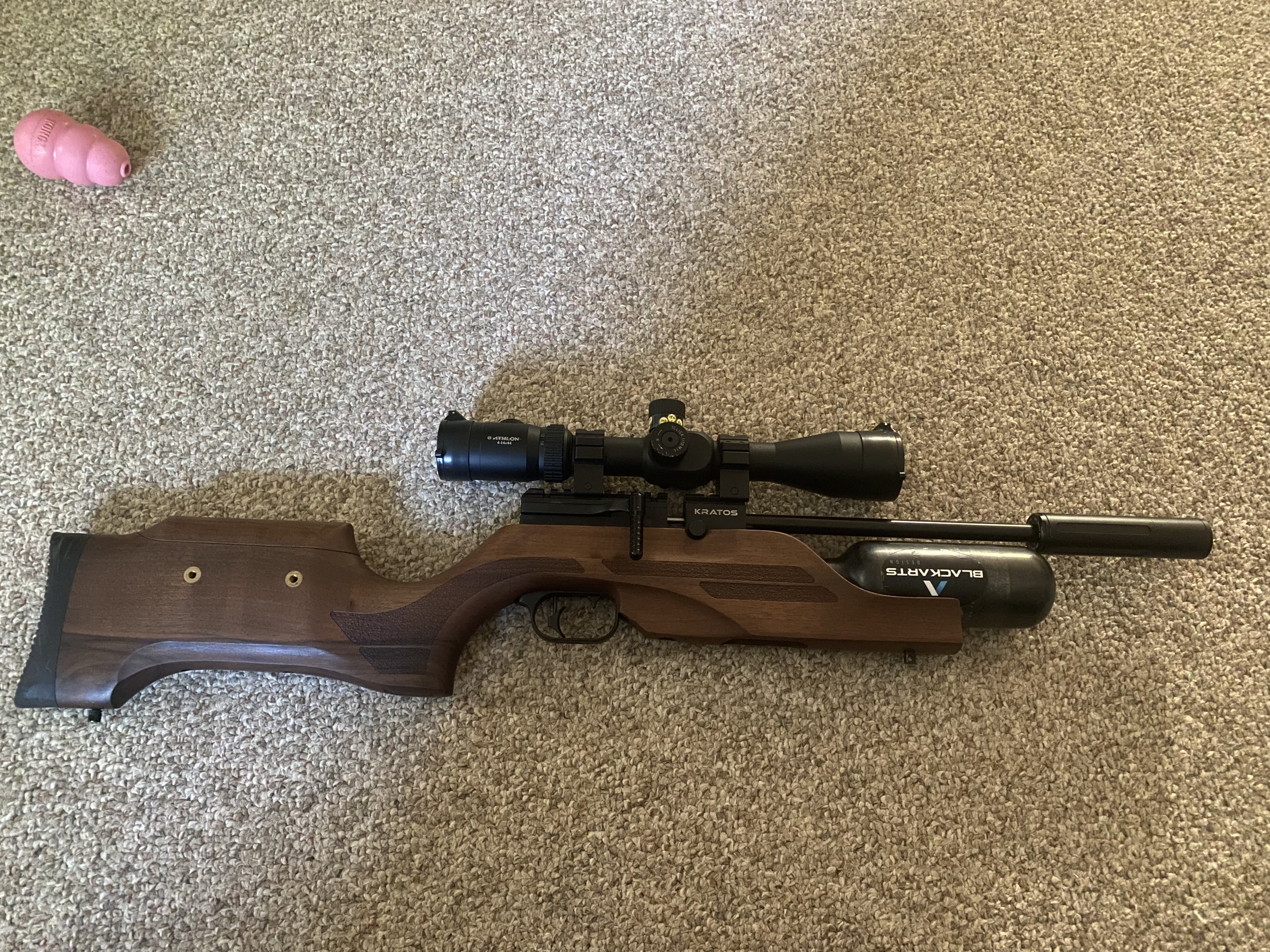

The barrel set screw closest the magazine will line up into the barrel duvet. The forward screw won’t but will set on top of the barrel and works fine. It has been working great for me. I’ve moved the 16” np03 barrel over to my kral empire xs and put the 13” barrel from the empire xs on the kratos. I’ve also ran a custom 10” kral barrel on the kratos. Pictures are of the 10” and 13” setups

I agree with you on the lack of power. Mine is now just a plinker for my son, but is setup to be a short and light woods gun. I did do a 23” barrel in .22 but ended up chopping that one down to the 10”. Due to the length it definitely needed a barrel band and was just too long for my liking
