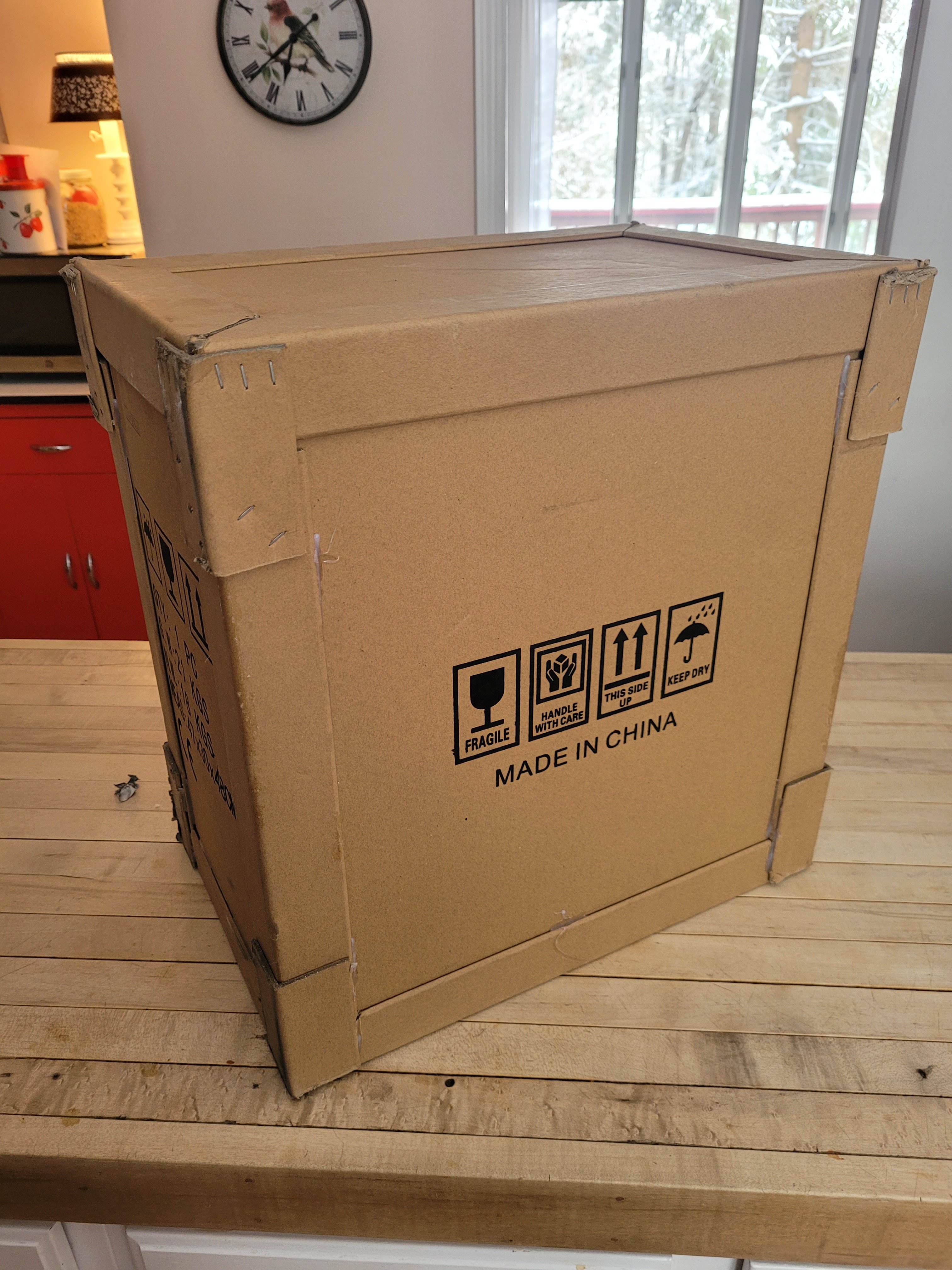

So my YH arrived today. I kind of expected it to come with oil but no.
