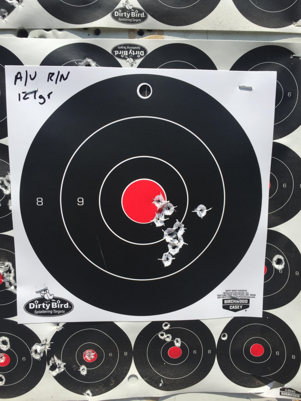

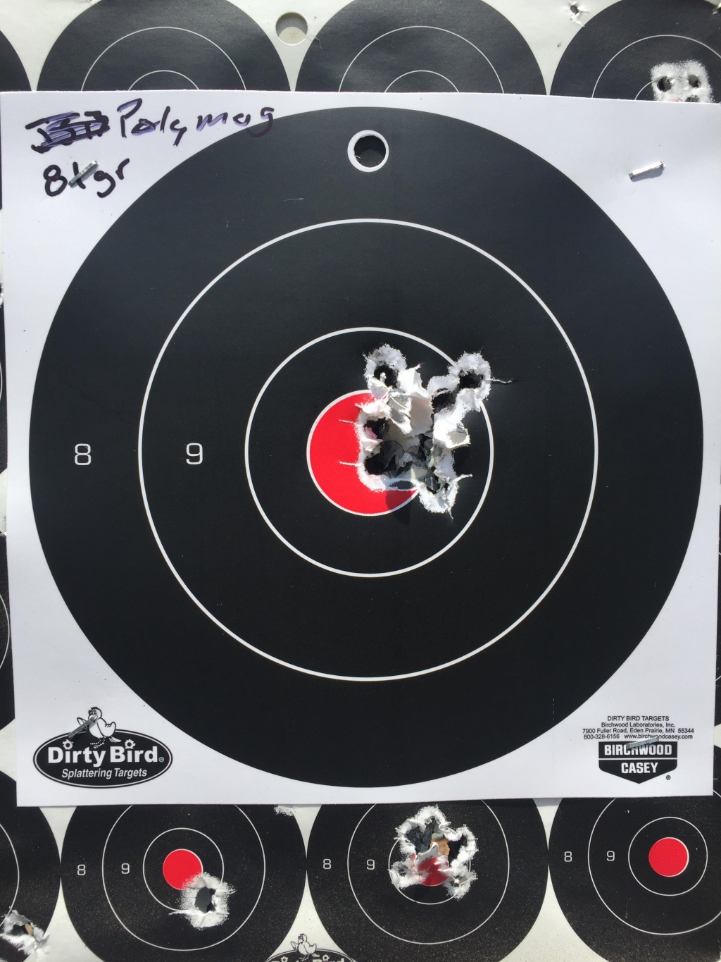

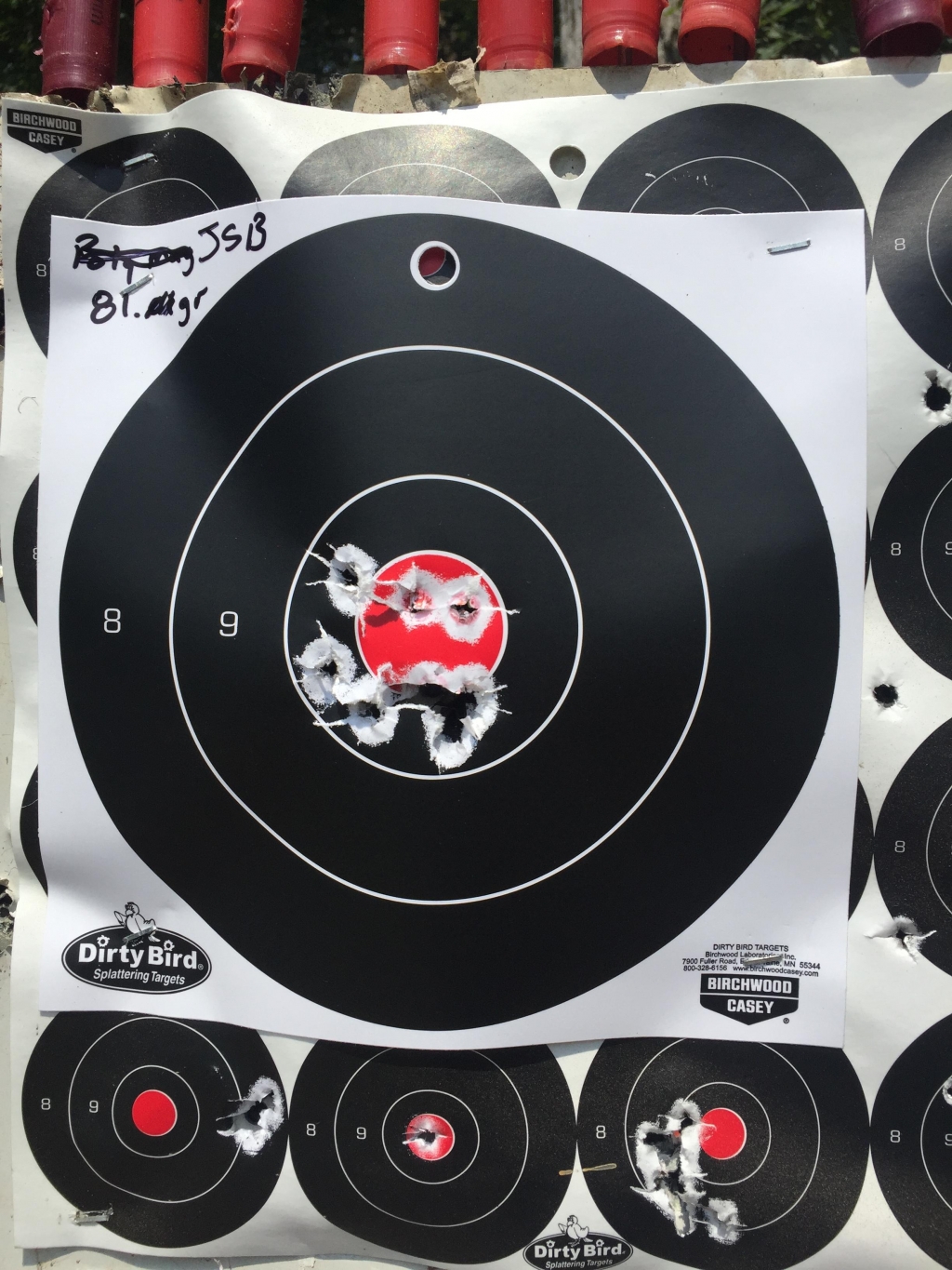

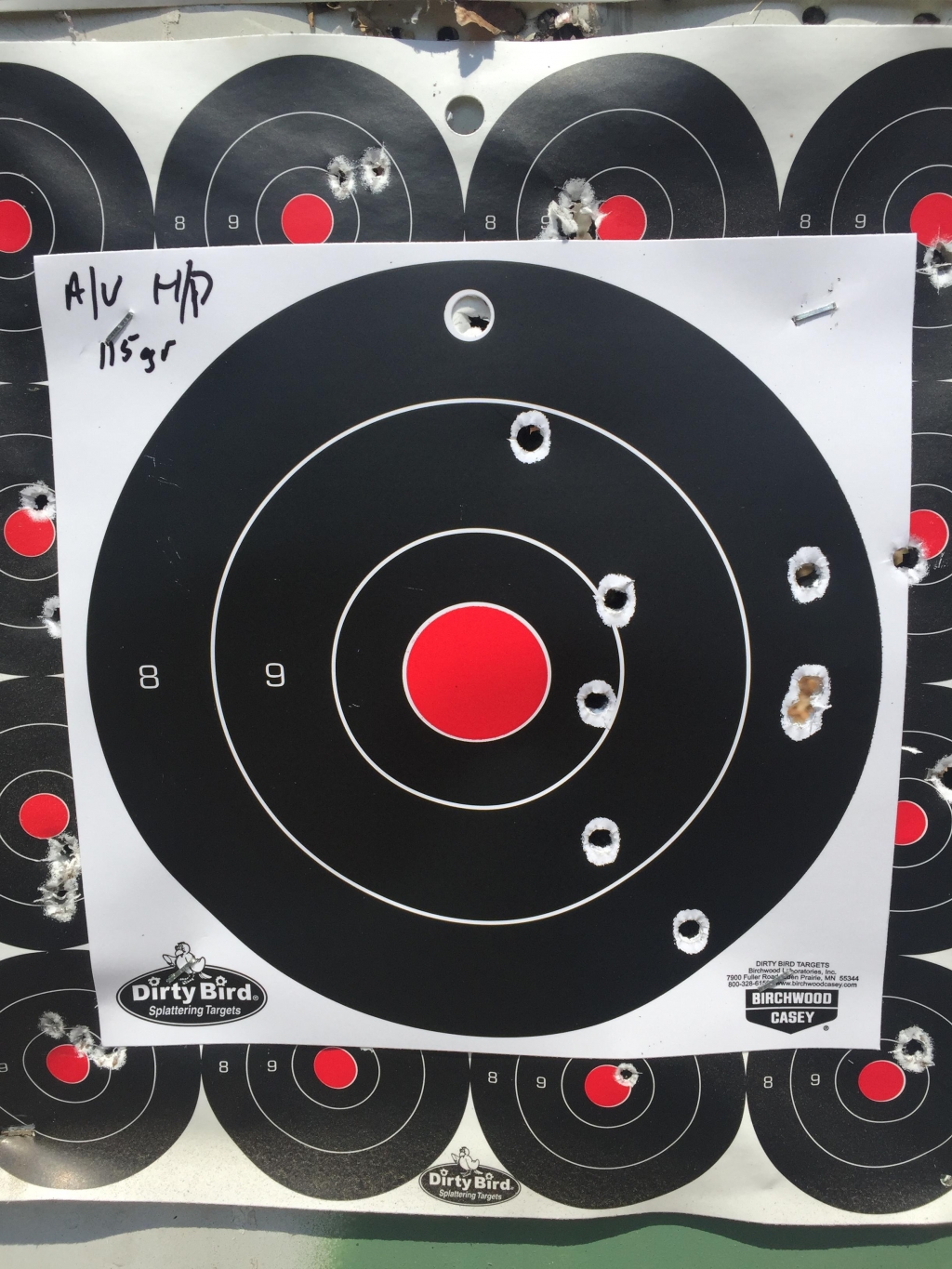

There were all at 50 yds, from a Caldwell rest, 10 shot groups, topped off to 3000psi each group

I have the Pitbull Barrel Supports, Pitbull Mega Moderator and I bored out the valve and transfer port to .281. I’m getting one ragged hole at 25yds and 1/2” at 50yds on a good day with 5 shot groups. I’ll usually shoot 5 shots from 2800 down which is the best range from the shot string below. I also turned in the HS 2.5 turns from stock. I think your main issue is you need to support your barrel. Both the supports and the Maga moderator do wonders for this gun.

A bit hard to say for certain but if you are firing all 10 shots in a group from a single fill, you have a shooter.
Straight out of the box at 50 yards 3 (maybe 5) shot groups. Chrony & tweak it a bit and you may have the groups you want ( but not 10 per fill at range). The factory barrel support ( just open the end so they slide all the way down ) are much better fit than some others and cost just a couple of dollars.

AV tend to be cast out of too hard an alloy to shoot well.
