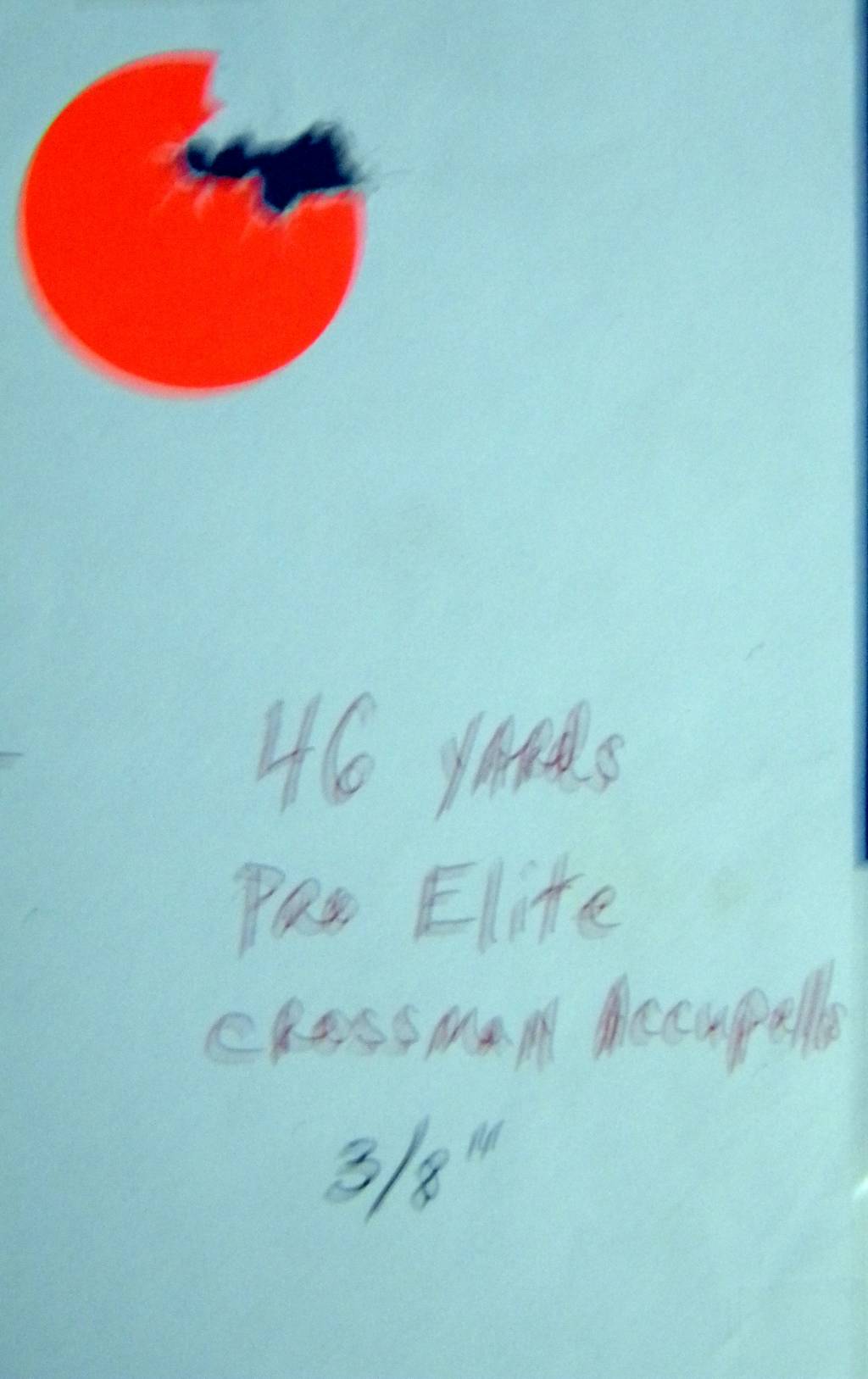

Not if the breakbarel is quality made like a NON Hatsan for example. Or Gamo or Crosman Benjamin if you are a natural born gifted great spring gun shooter.

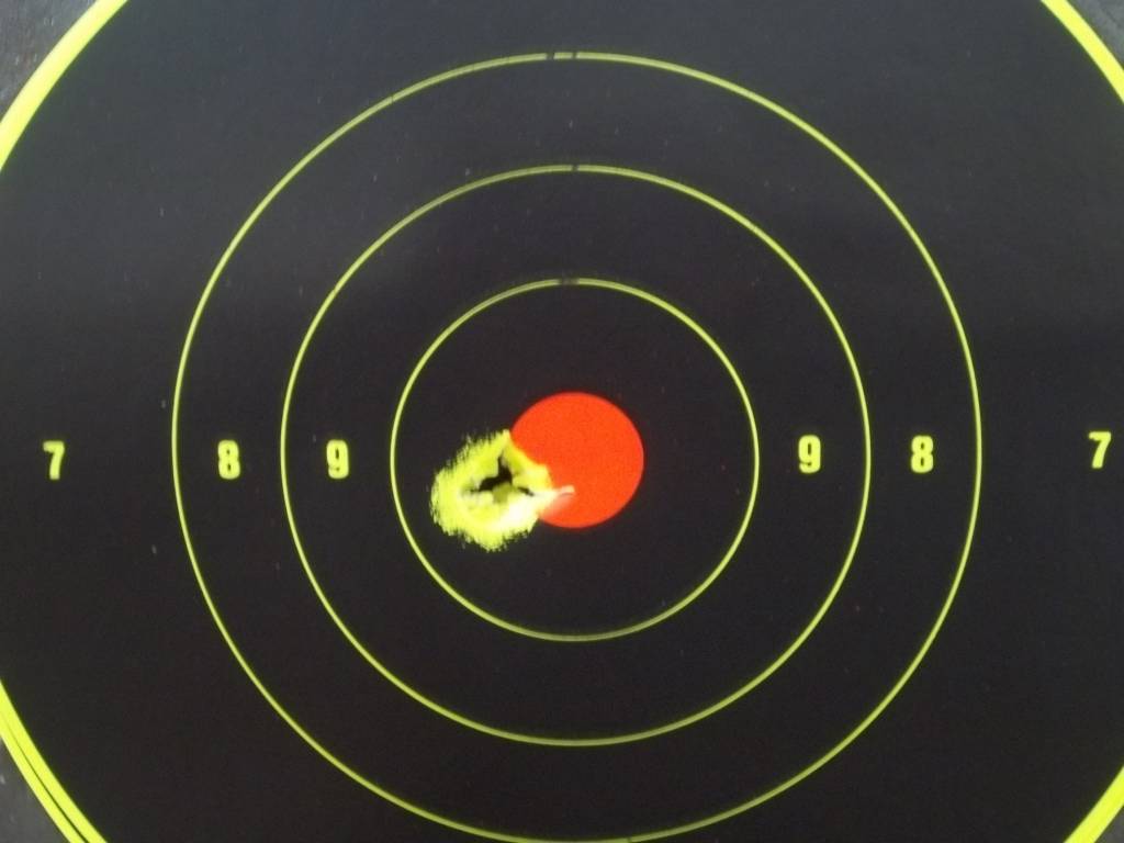

Not here......... Gamo Whisper Fusion 22 cal...........5 shots.....15 yards
