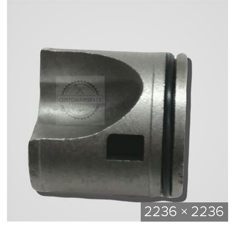

Sorry about that it does not clarify. I want to remove the breech not the breech seal. I can’t imagine another name for it. SEE PICTURE.
Ok , he has the wrong gun name..
That is the breech plug that fits a cfr or gamo underleaver gun.

My gun is a Gamo Raptor Whisper with IGT technology. See Attached PDF.
The drawing is only meant to show what I would like to replace which is the cylinder breech.
Removing it I can see just pushing out, but how would you guide it back in, making sure the holes
line up.
The only thing at present is just use string...
View attachment Breech Cylinder.pdf
I dont know looking down the tube inside ot looks welded in .. on my whisper fusion.. ive never known that part to be removable or replaceable...
That underlever maybe due its also the loading tray
As seen here
Outside not a underlever. Ive never seen that animal from gamo break barrels

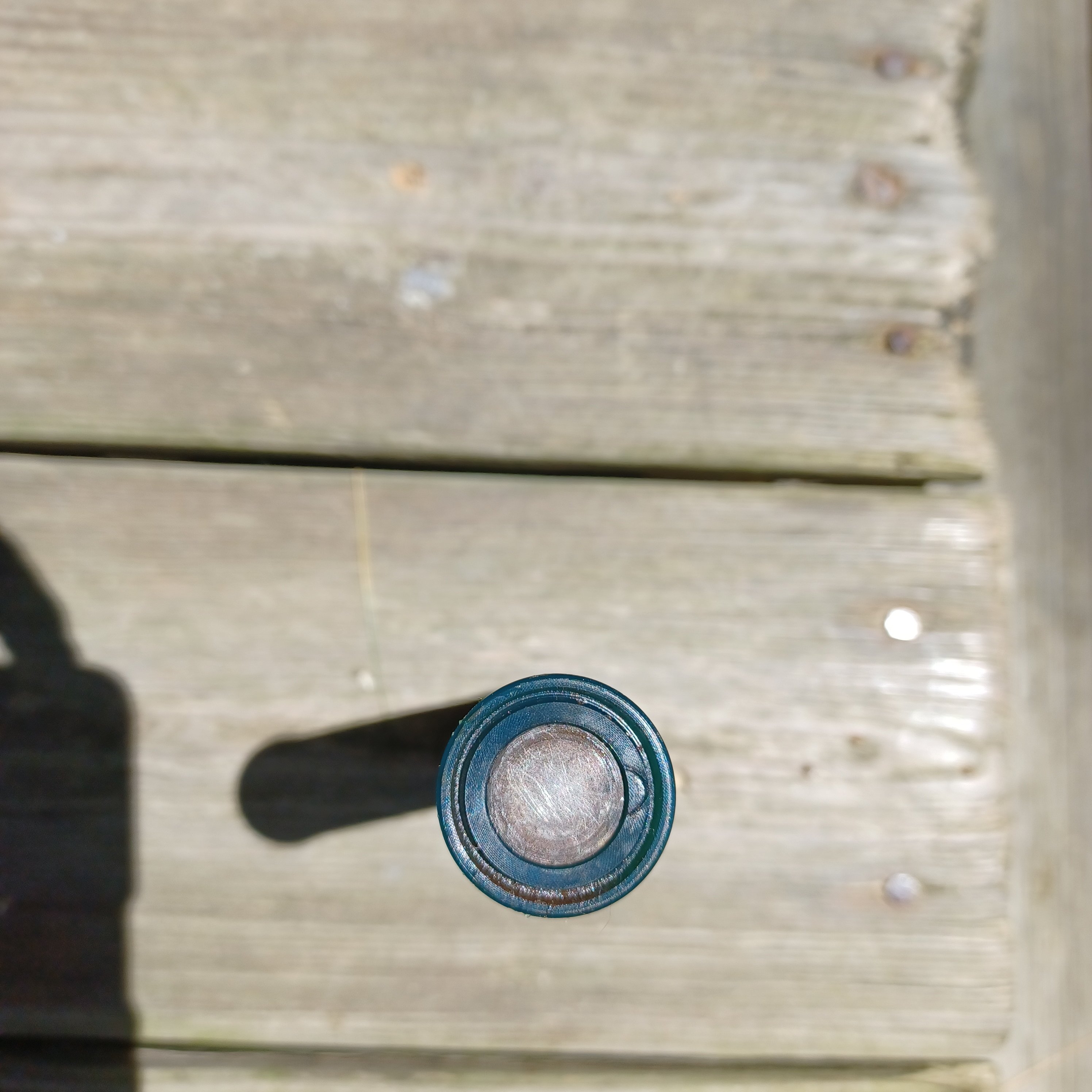

I going to keep looking because my cylinder breech is messed up, it damaged a new piston seal, see attached picture. The damage was caused by the Gamo piston seal breaking up in the compression chamber, damaging the breech intern damaging my new piston seal. It amazes me the poor workmanship that goes in to Gamo guns…
I understand your point looking down into the air chamber it doesn’t seem possible to replace, but if it goes in, it has to come out “that’s what she said”.
That s strange ,. Like the piston stroke is to long and the piston slams .. you onow my gamo i use now may of got that happing bit in like 4 years of shooting it i noticed a bit of power loss.
So i pulled it apart and my seal had a chunk just about the same placement at the piston button. Hmmmmm.. that picture is interesting.. sadly ot once he 33mm piston and c.a.s in Australia os the only place i know to sell one. I just cleaned ot relubed it and reassemble it and still shoot fine .. it was a after the fact and kinda wished id took it apart for inspection onve a year now but thats water under the bridge now.. even with the seal damaged she still lays the smack down and nails what i aim at , so oh well .. i dont get why c.a.s sells stuff on amazon and ebay but not that 33mm seal in the usa ,go figure ..
Mines a gas ram but maybe if yours is a spring you may find a way to shorten the stroke or piston travel just a mm or 2 to resolve ?
Then maybe thats normal gamo thing and you just let it bob till she drops then put another seal in and repeat..?
Look here under Parachute seals .
https://www.pyramydair.com/blog/2008/3/spring-piston-seals/
same marks i seen a gew more examples looking so not so uncommon i guess to happen in any brand i guess.
Another shows one pretty hammered
So it caused by not enugh back pressure to cushion/stop by he piston at the end of the travel (?).
