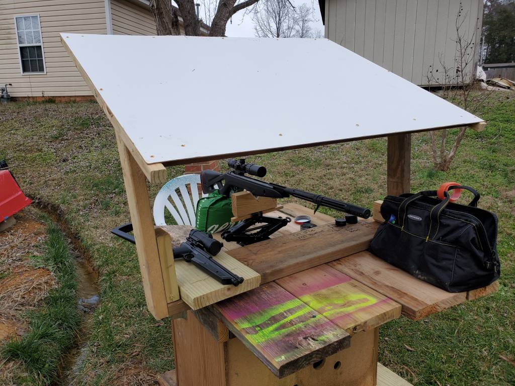

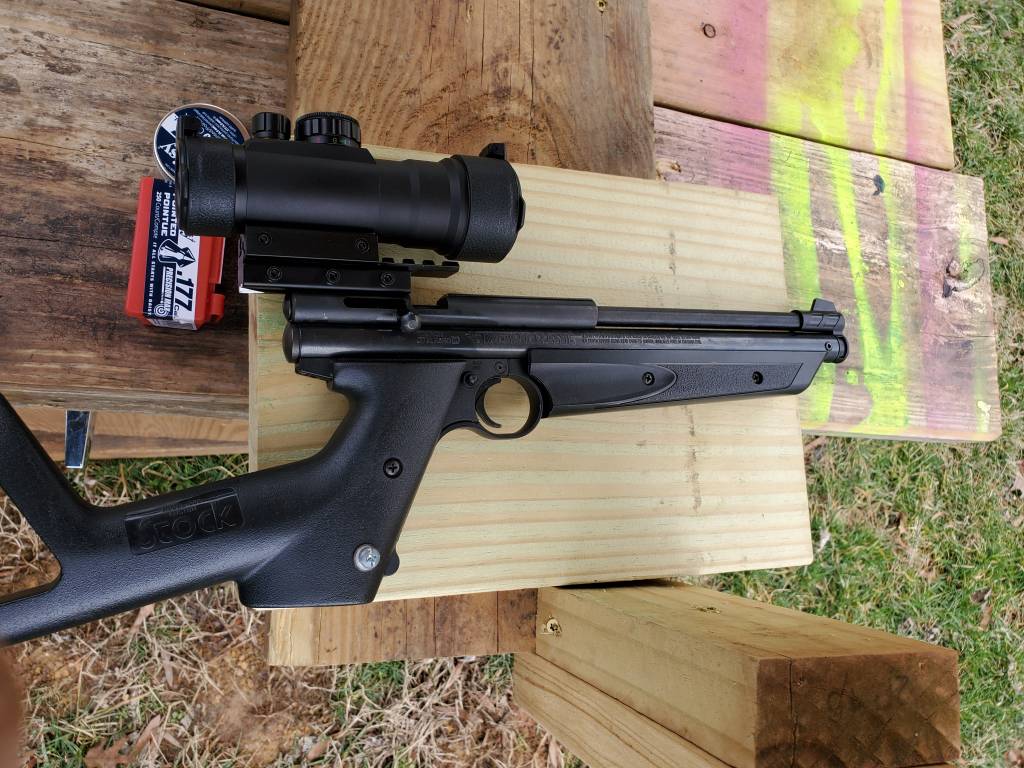

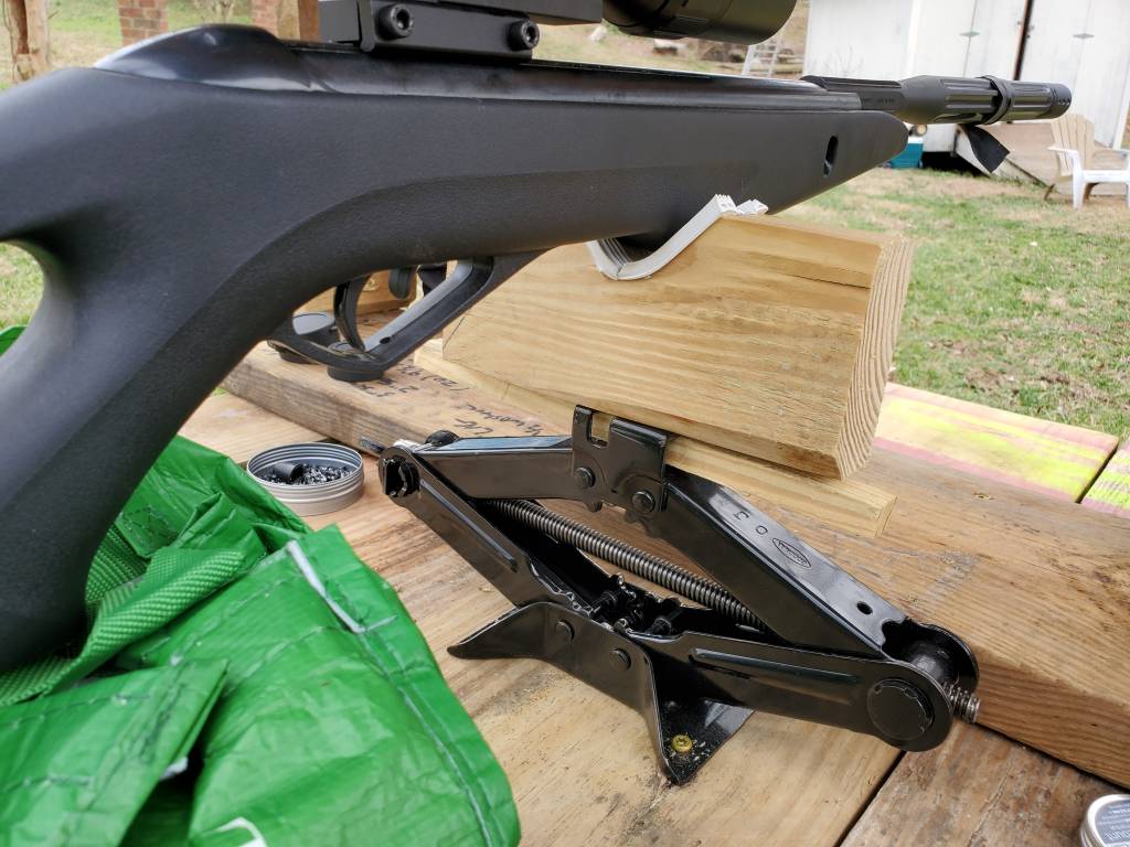

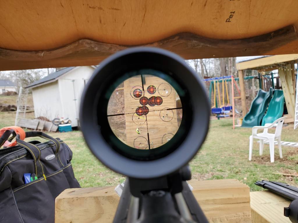

Just a few pictures of my rig. Today, 10, 15 and 20 yards, bullseye no problem, great groups.
When I pulled out to 25 yds, thats when my accuracy dwindles. I swear it is due to operator error and will work to become more proficient.
Some one mentioned, zero in the same way you'll shoot when varminting. I know I'll never shoot freestanding, always in the crotch of a tree or some kind of rest... this makes sense to me too.
Thanks guys and gals. I'm a diy'er as evidenced by the car jack turned into elevation component, and homemade sand bags.
I had weather stripping left over and thats what the small padding is.
I'm gonna remove that and recut the 2x4 and insert a pad with a bit more padding.
My only reason for the BR shooting is to zero as best I can; eliminating reasons for misses/so I can't blame the gun, bit more so, myself.
Thank you all again.
