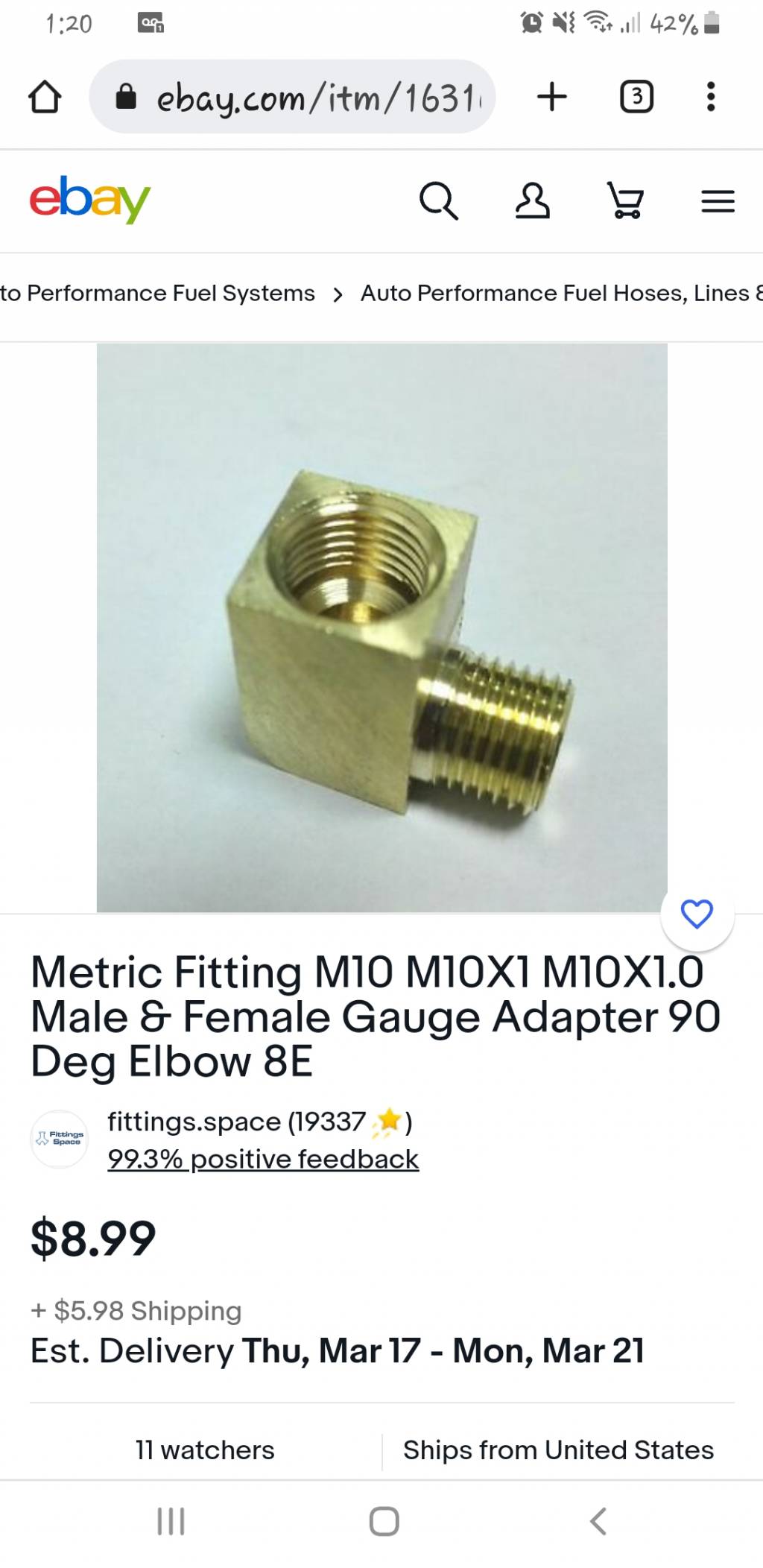

I am thinking of using this elbow adapter to fill my tank to 4500 psi. Would it handle 4500 psi? Description doesn't say the rating. Most quick fill connector that came with my hpa hose lines are brass, few are stainless steel. So I would think this brass adapter could handle 4500 psi?
What's the rating on the fitting? Doesn't matter if it's brass or stainless as long as its rated for the attended pressures.
If your fill line is used on a 4500 psi pump then I would bet ever fitting and hose used on the pressure side of things is rated for 5000 + psi.
Doesnt say, that's why I asked if brass can handle 4500 psi. Or should I find stainless steel. Pic in the above comment.
that brass elbow on flea bay is a 150 psi fitting,, that said, it is not the material but wall thickness to interior volume ratio for a said material, the bigger the vessel, the thicker the wall thickness,, my Zbroia comes with brass fill probe for a 300 bar(4250 psi) gun,, higher pressure fittings will usually say the psi rating,,
