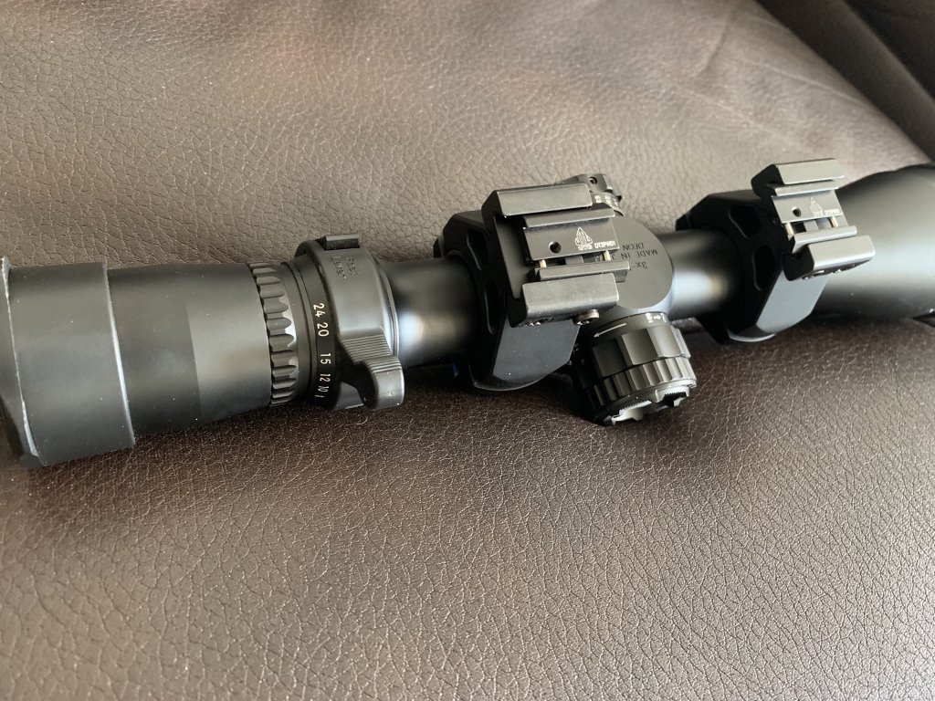

Yeah, I was also not too thrilled when I found that the XTR signature rings didn't line up evenly with the UTG dovetail to pic adapters! Here's what I mean..
