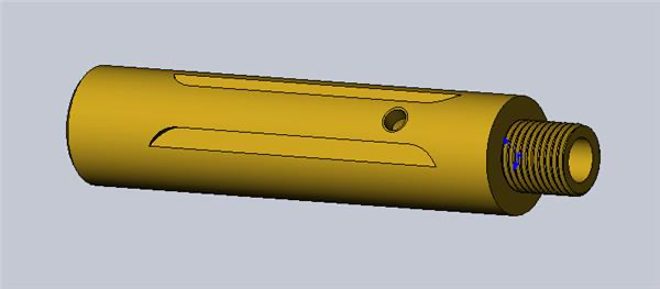

I have drawn up a threaded brass nose cap for the Diana’s. Features 1/20 UNF threads and a 9mm rail slot for globe sights.
Would an 11mm rail be more compatible with the front globes out there?
Going to get some quotes for manufacture. Let me know if you’re interested.

I'm guessing that's for the 48. I would be interested, when I want to use a suppressor on mine I have to switch out to the longer barrel sleeve to accommodate for the shorter adapter.
it is an interesting idea but
Anschutz, FWB, and Diana globe sights are 9mm+ or -
the Air Venturi globe is 11mm
and i am not sure about the Daisy
the 9mm sights are hard to find and are in the 40 to 75 buck range depending on inserts
the AV is 25 bucks at PA is made of plastic and takes Anschutz 17.2mm inserts
and the AV sight like to turn white over a very short time but will clean up
the right way to go would be 9mm but the easiest for the buyer would be 11mm
todays Diana 350 mag would take a 9mm and also 15.9mm inserts like the old model 75 and the 150 and 300 FWB and old Walthers

Thanks! Making it 11mm isn’t any harder than making it 9mm, so 11mm it is
