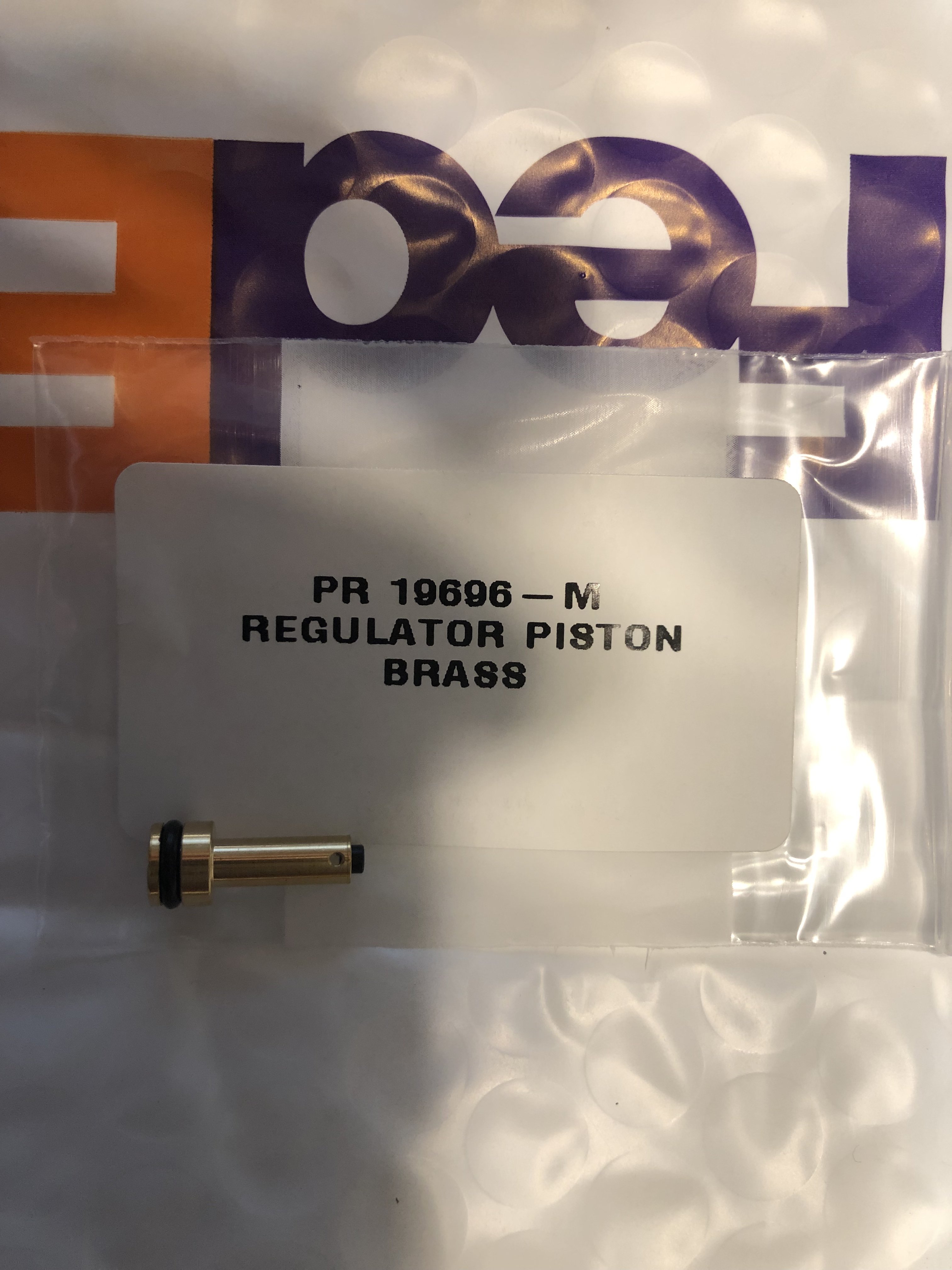

brass impact regulator piston
Just in from fx USA Today
Reactions: qball
The main thing I'm looking to get from a brass piston is reduced set point shift due to temperature changes. It's very noticable on the plastic piston. 70deg F to 40 deg F is around 10 bar change on my M3. Other than that issue, the plastic piston works great and it has the advantage of not needing a separate sealing surface material.

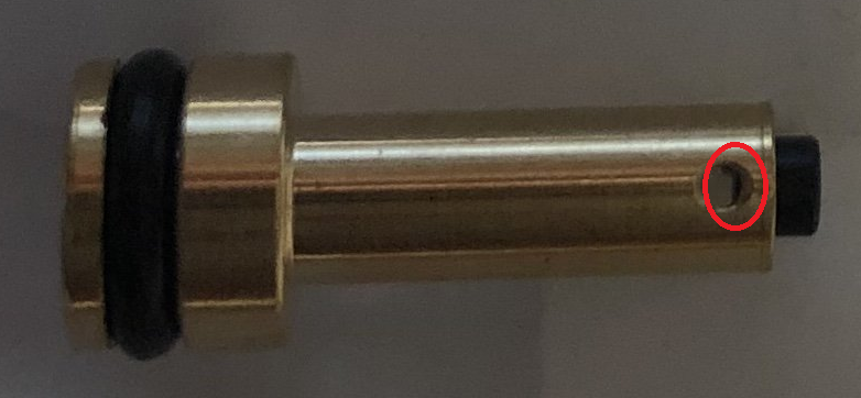

I think FX design is not the best one. That delrin part should be as thin as possible:
50ab7dd8-d851-4a9b-a118-c14ab8e55f9f-jpeg.279261
So that it does not change its dimensions drastically under temp. range.

I think FX design is not the best one. That delrin part should be as thin as possible: So that it does not change its dimensions drastically under temp. range.
A little unconventional the way it sticks out like that but it's such a small part, its length will change only an infinitesimal amount due to temperature. Contrast that with the entire piston being made of Delrin.

The body of the regulator piston is just an aluminum block. Looking at the critical parts:
Both the nozzle and the piston are influenced by thermal expansion. If the temperature is lowered then both become shorter. The effect is similar to unscrewing regulator adjustment screw. However, delrin's dimensions are influenced like 5x more than brass. I would take FX brass piston and remove the excess of delrin material. I would eventually replace delrin with peek which seems to have lower linear coefficient of expansion.

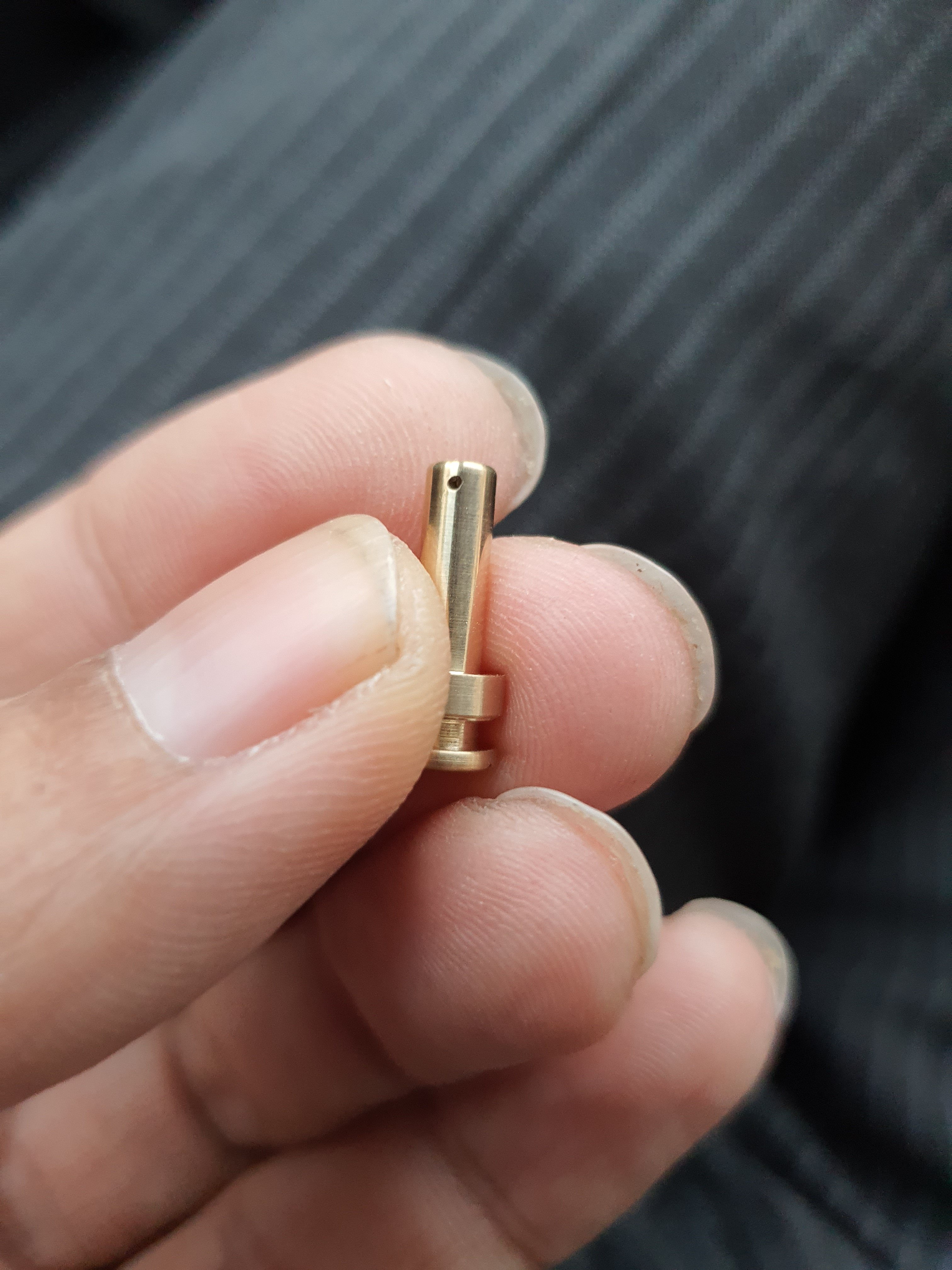

But I think there may be a problem with delrin thickness reduction as there seem to be a hole in brass right below that delrin piece:
It seems delrin sticks out. What a poor design. C'mon FX! I understand they made it to improve reg service time - easier to replace delrin part.
PEEK is a good choice provided you smooth and polish both sealing faces, else it is apt to creep like crazy.
However its coefficient of expansion won't make any meaningful difference compared to Delrin because the dimensions are so small.
My brass pistons with peek seats are working great.
