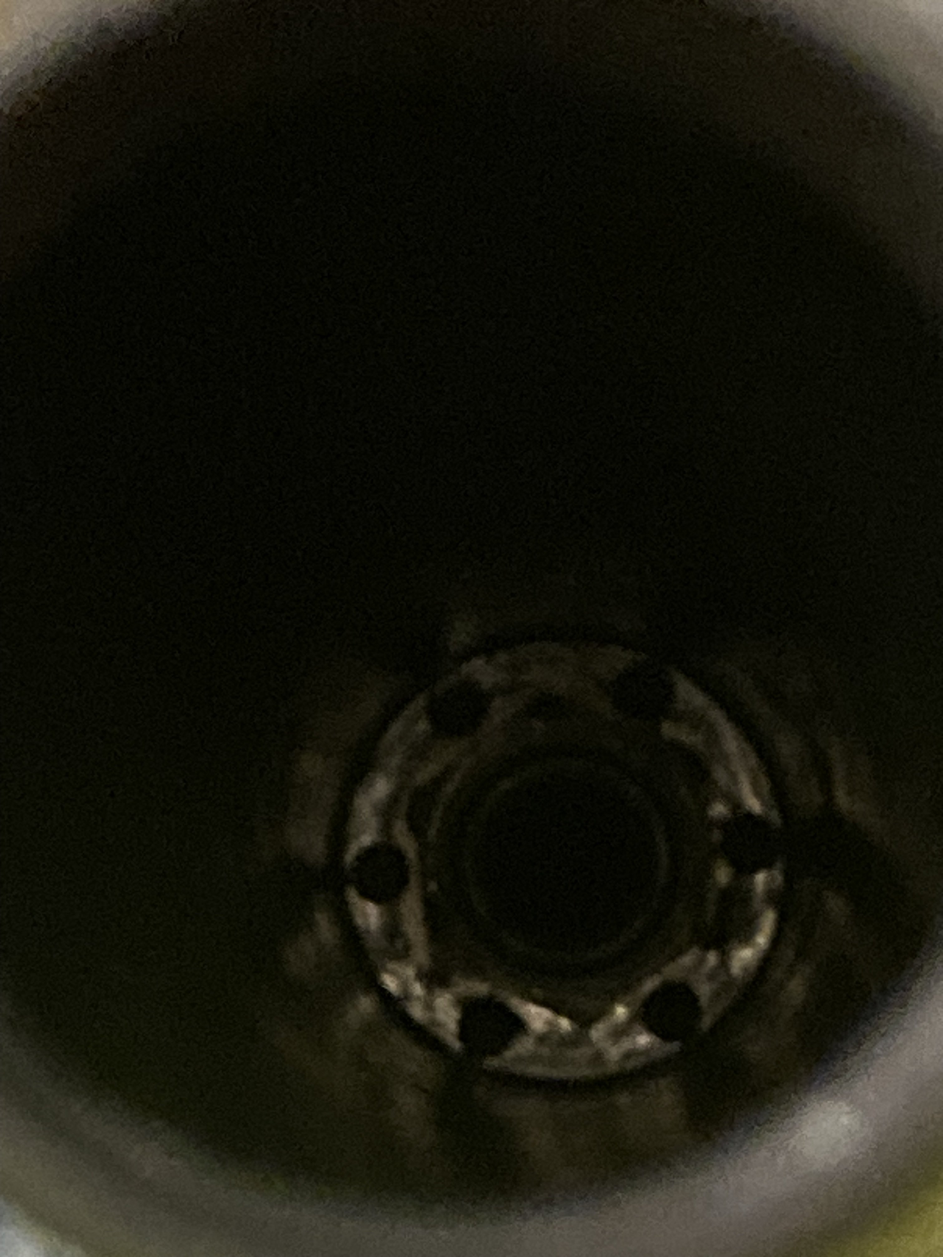

I seen the scope option I wanted to keep this one as open sights. I am fully aware of how to hold an shoot them i been doing it for 30years lol. I’ve just never had one where the shroud spins

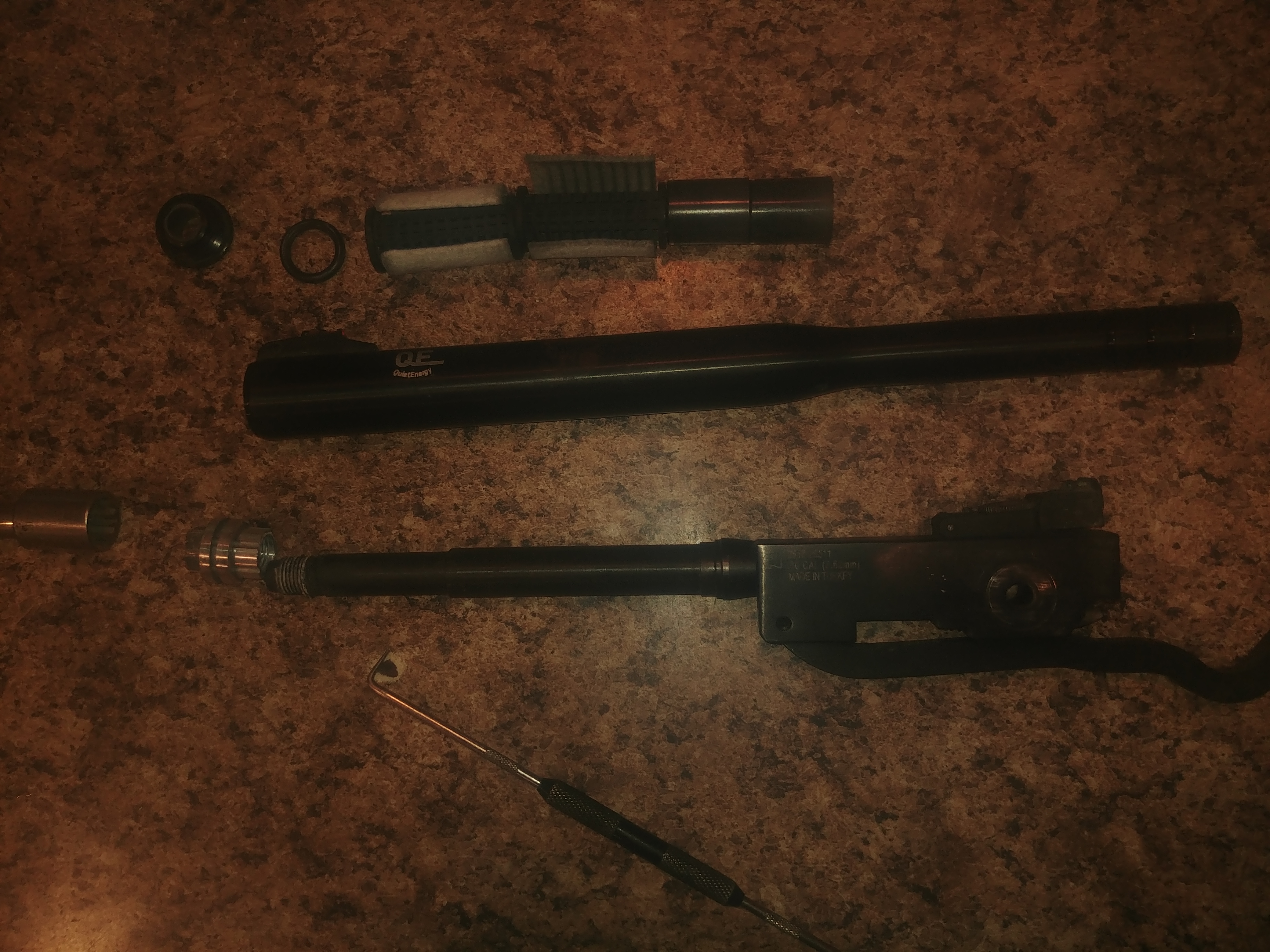

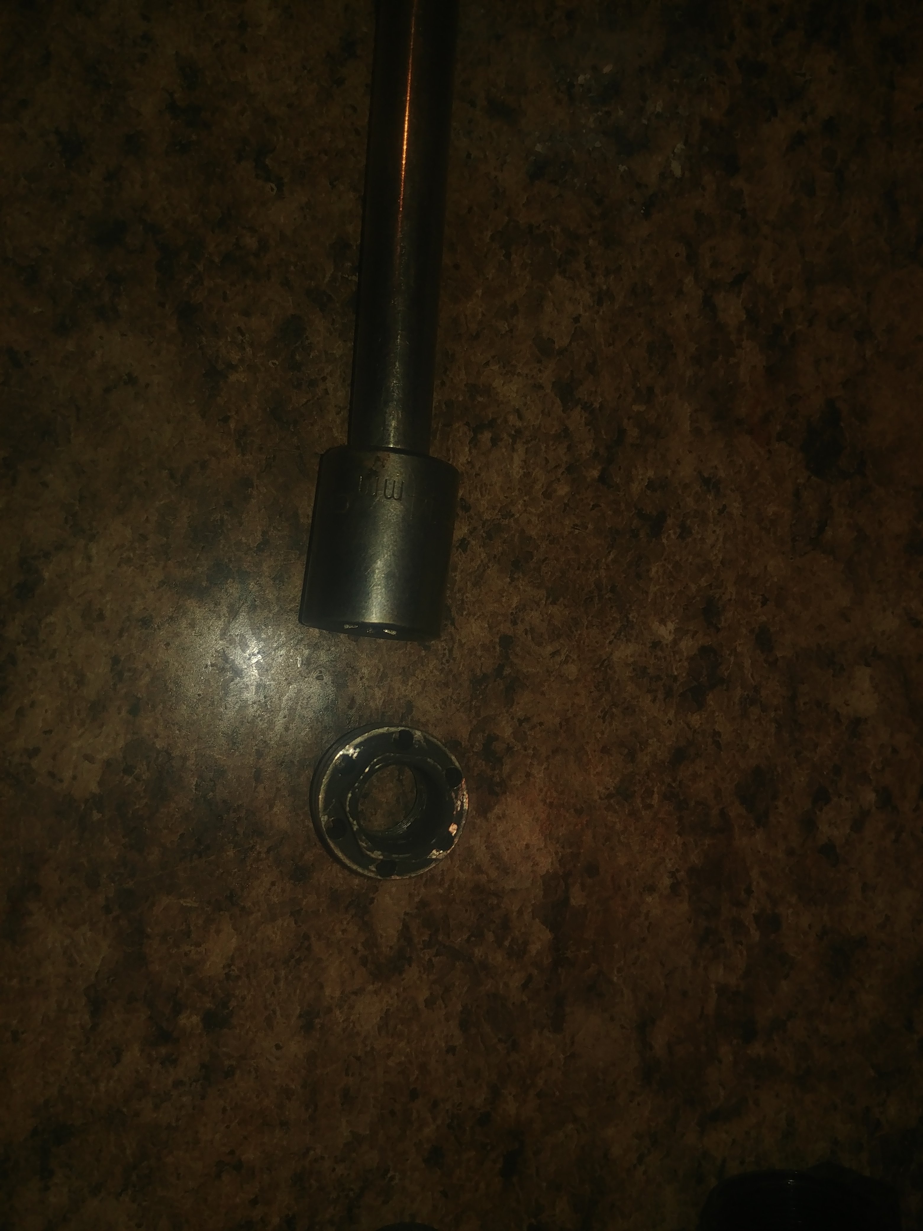

It is a 14mm, at least on mine I used a 14mm 12 pt. Long extension and put barrel block in vise, on the gun I would try and use a piece of leather and a crescent wrench on the block as I tightened the nut, it didn't want to budge easy, thread lock, corrosion and the nut is aluminum.
Thanks for the info i used every socket i had nothing fit ? I looked inside the shroud and seen what looks like a nut but maybe it was female ? So to speak
