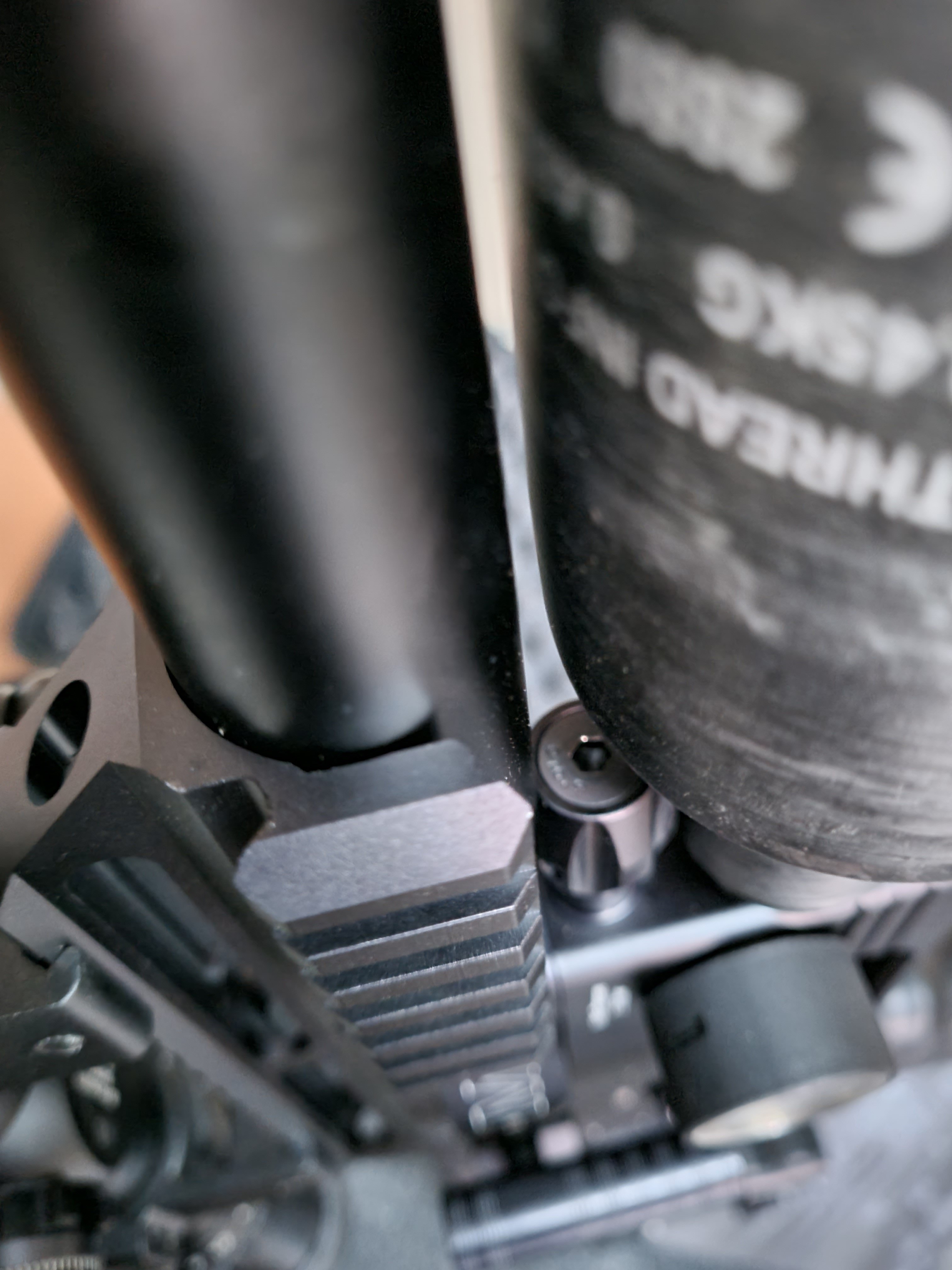

FX Brand New FX Impact M3 not firing
It is a bit strange it was dialed to 0 though, also that this prevent the rifle from shooting at all, but granted i am not a Impact owner so i do not know.
My Maverick, well i am also sure something strange happened at the factory to finally deliver it after waiting for months on end when they came out, i have a sneaky feeling it is a SUB 12 rifle half way turned into a FAC one for the Danish market.
Also the use of " do NEVER come apart " thread lock on most parts of my Maverick confuse me.
The valve turned all the way in will prevent the valve from opening. No air to the projectile.
