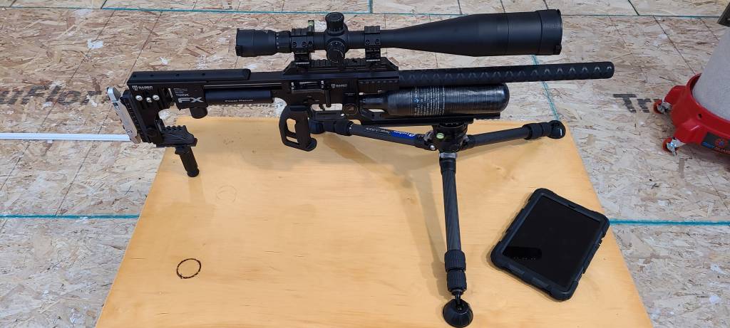

Fx Impact MK2 PP 700mm with a long Arca rail, and diy designed rear adjustable stock with integrated picatinny rail for attachments.
For now the CF tripod with a low profile Leveling head and arca clamp at front and an adjustable monopod at rear is...relatively easy and comfortable to cary around and setup at bench.
For a fixed distances 100 and jump to a 50 meters the front tripod is fixed height and adjusting the rear monopod only.

This what I am using, and pretty much working well at one range (50 and 100 meters), but missing the height adjustment at the other range (50 and 100 meters also).
What is a problem? The table/bench height in relation to the target, the two ranges have different height tables, also the target buts higher at first range and lower at next range, so I started carrying now a piece of 2x3 as well in my pocket...

I was at my gunclub today, some leisure time not many people around. I was focusing on tuning my shots, and found myself struggling with holding the gun down on the table. Feels like not enough weight up front and the whole thing is moving slowly to the Right, every 2-3 shots I need to adjust the rear for about a MOA (POA @100). The sequence is release the levelling head -> move the rear -> check the bubble -> tighten the head. If I don't do this way and just move/push the rear monopod back to my initial POA the POI looks like that I induced a side torque.
