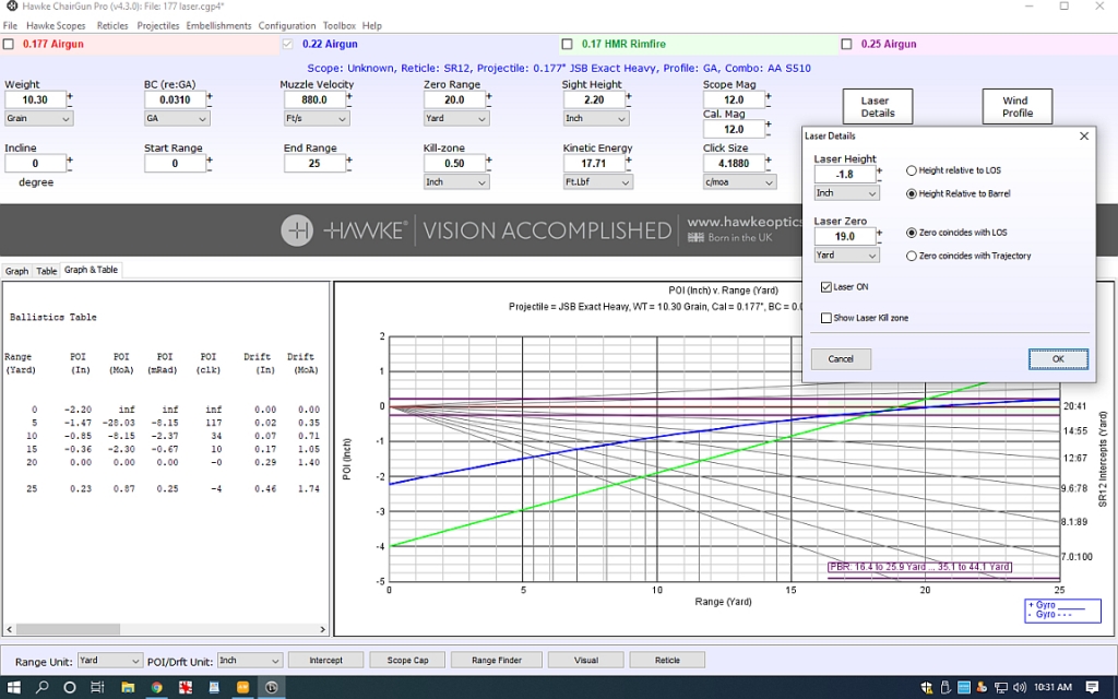

You can add a "bottom up" laser somewhere under the barrel to help calculate the holdover for ultra close shots from 6-20 yards without clicking. Scope height 2.2" zeroed at 20 yards, laser height -1.8 inches zeroed at 18 yards. Sight through the scope. If the laser is below the center, aim exactly halfway between the laser and the crosshairs. if the laser is above the center, aim with the crosshairs which will be 1/4 inch low at 17 yards, 1/4 high at 30, 1/4 low at 43 as the pellet flies through the arc. This is just an example which will depend on your pellet and velocity (JSB 18.1 gn at 880 fps), and scope height. You would need low magnification to see the laser at 6 yards which would require 7 mils of hodover. So 15 mils of visible holdover in the reticle. A first focal plane reticle is not required since you don't have to calculate anything in real scale. just split the difference and shoot.

blue line is the impact point on the flight path, green line is the laser.
