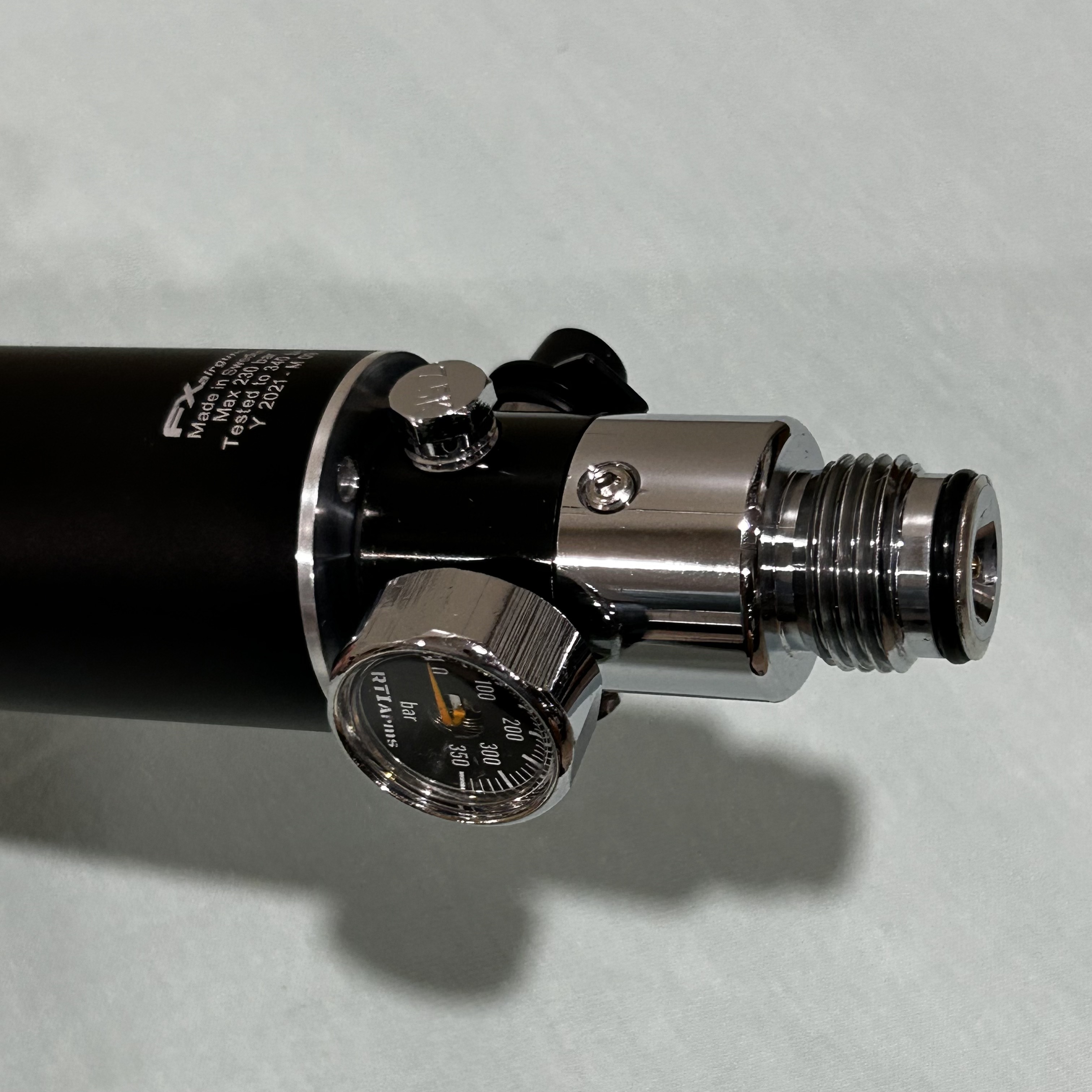

This is a pic of a standard FX 170cc tube next to M18x1.5 bottle threads of an RTI regulator.
All you need is a good machinist for an adapter..

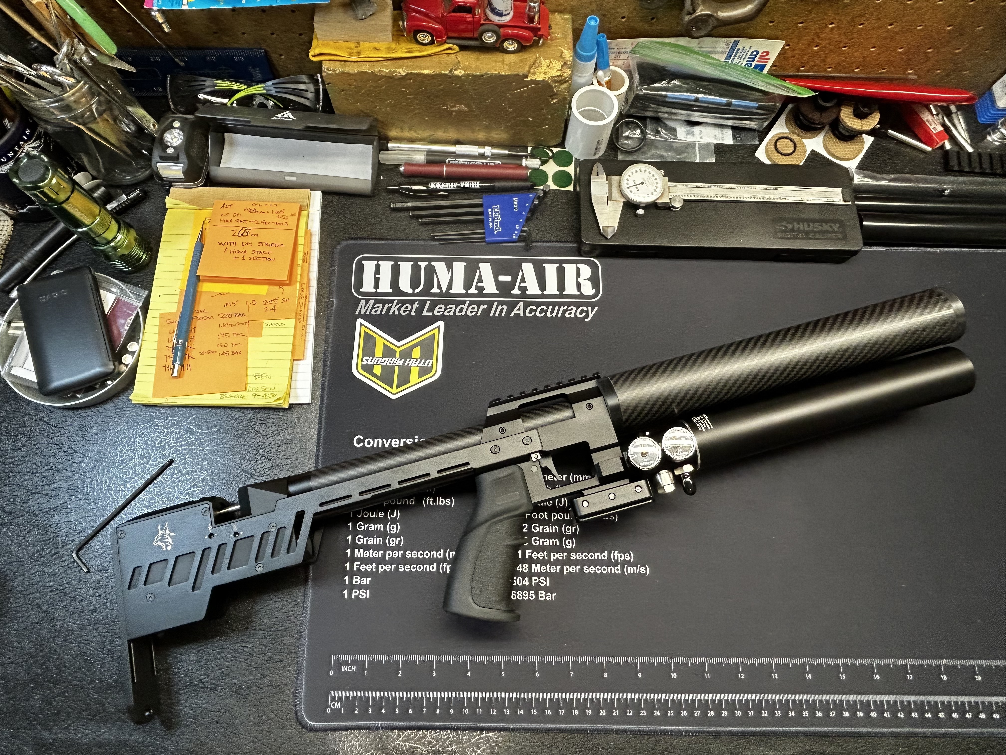

Then assemble.. ;-)

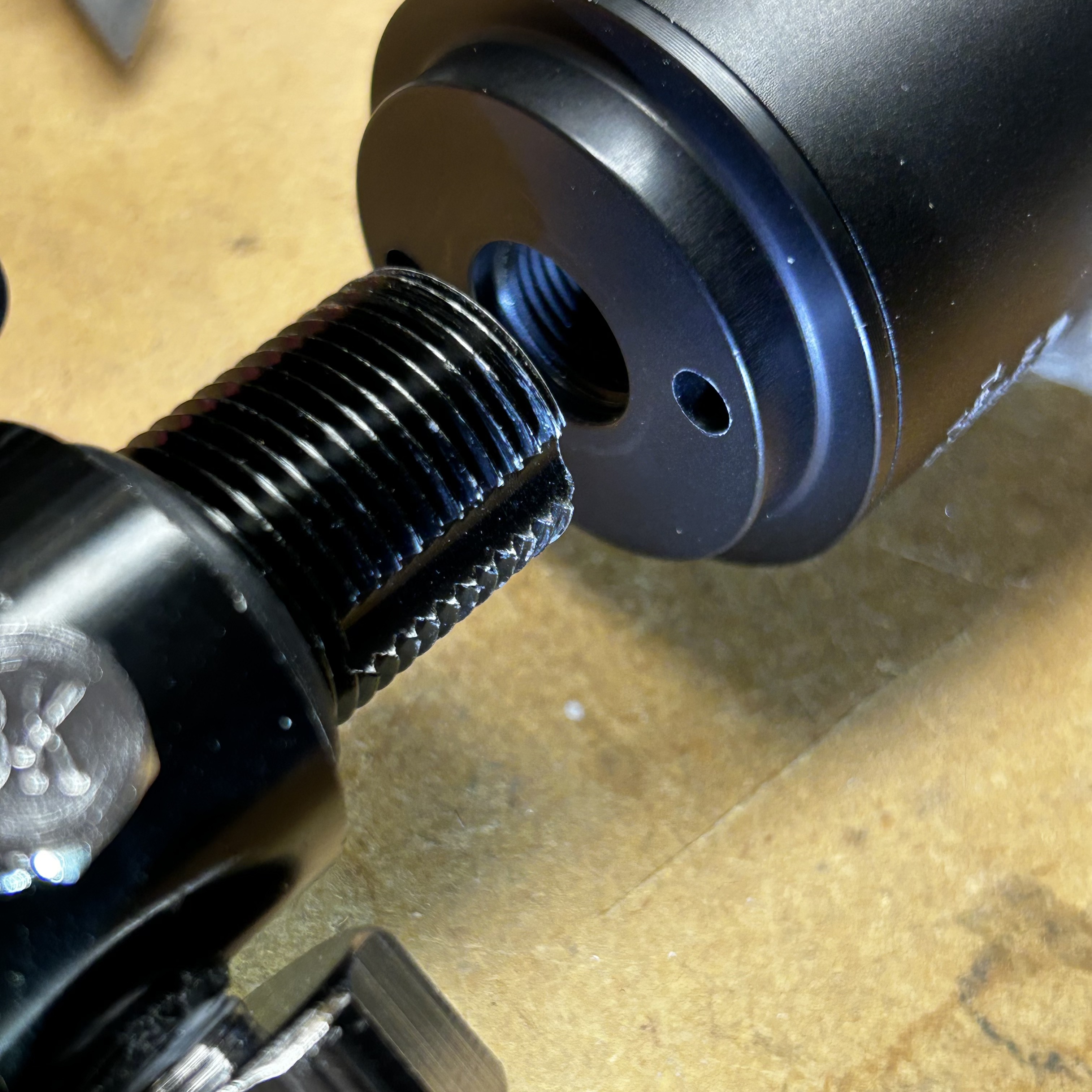

Like people have mentioned..depends on the tube threads.View attachment 591574
Then assemble.. ;-)

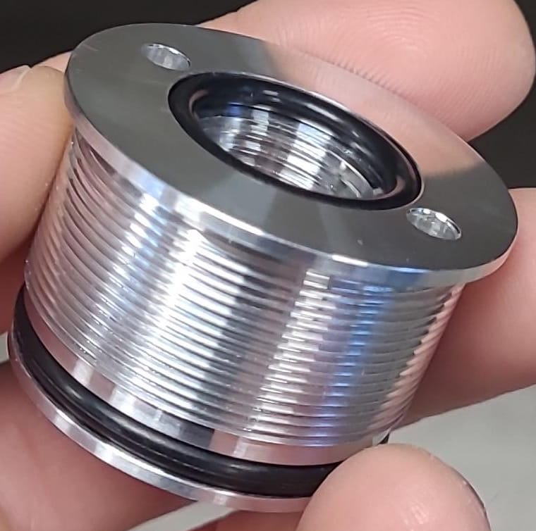

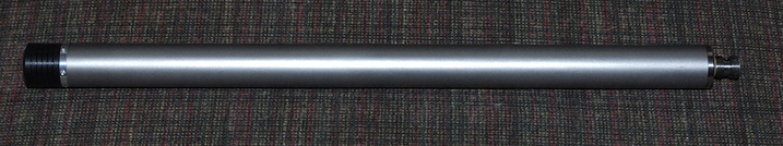

The thread on the FX 170cc tube is NOT M18x1.5. It is ??? and considerably smaller. You will need an adapter for the FX to M18x1.5. Or as I did, replace the tube end insert/cap.
The resulting project..based on a Naked P1..but essentially a bottle to tube conversion..
