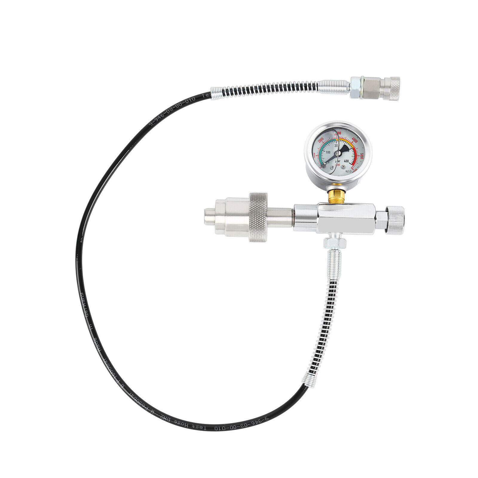

So far every SCBA tank I have seen has the same threads between the valve and the tank, and of course the same threads on the outlet side of the valve since they are (almost?) all CGA347.
If your tank already has an SCBA valve on it, then all you need is a CGA347 fill station.

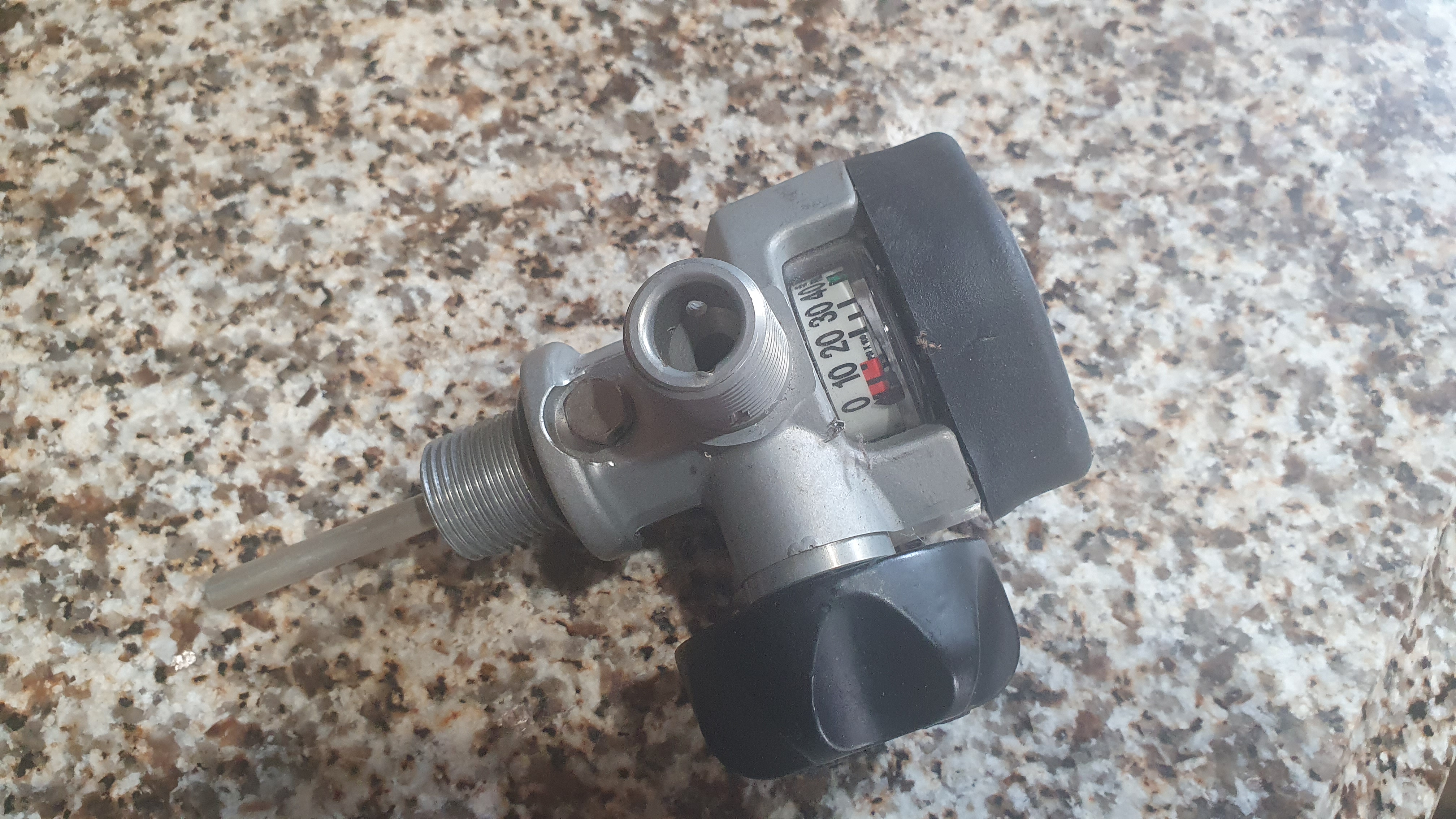

I have always used the SCBA valve assemblies, but I am 99 44/100's percent sure that the threads are 7/8-14UNF also designated as .875-14UNF.

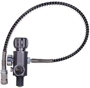

You can get an SCBA valve like the one starlingassasin posted for free sometimes at a fire station off an expired tank or buy a used one off ebay for $25+, then get the fill station like what I posted above, or go with one that goes directly into your bare tank like this one:

As @Scotty1 and @Geezerhood both said, your U.S. SCBA tank is 7/8-14 thread sometimes referred to as .875-14. You can find that valve on Ebay, or Aliexpress for significantly less than Amazon charges for it. Just be sure you get the right thread pitch. Don't get one with M18*1.5 metric thread or you'll be sending it back.
