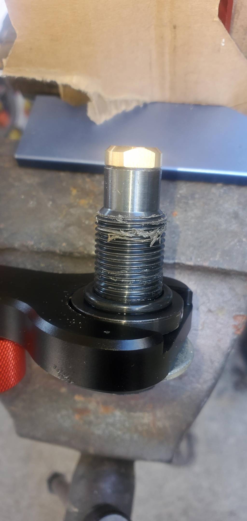

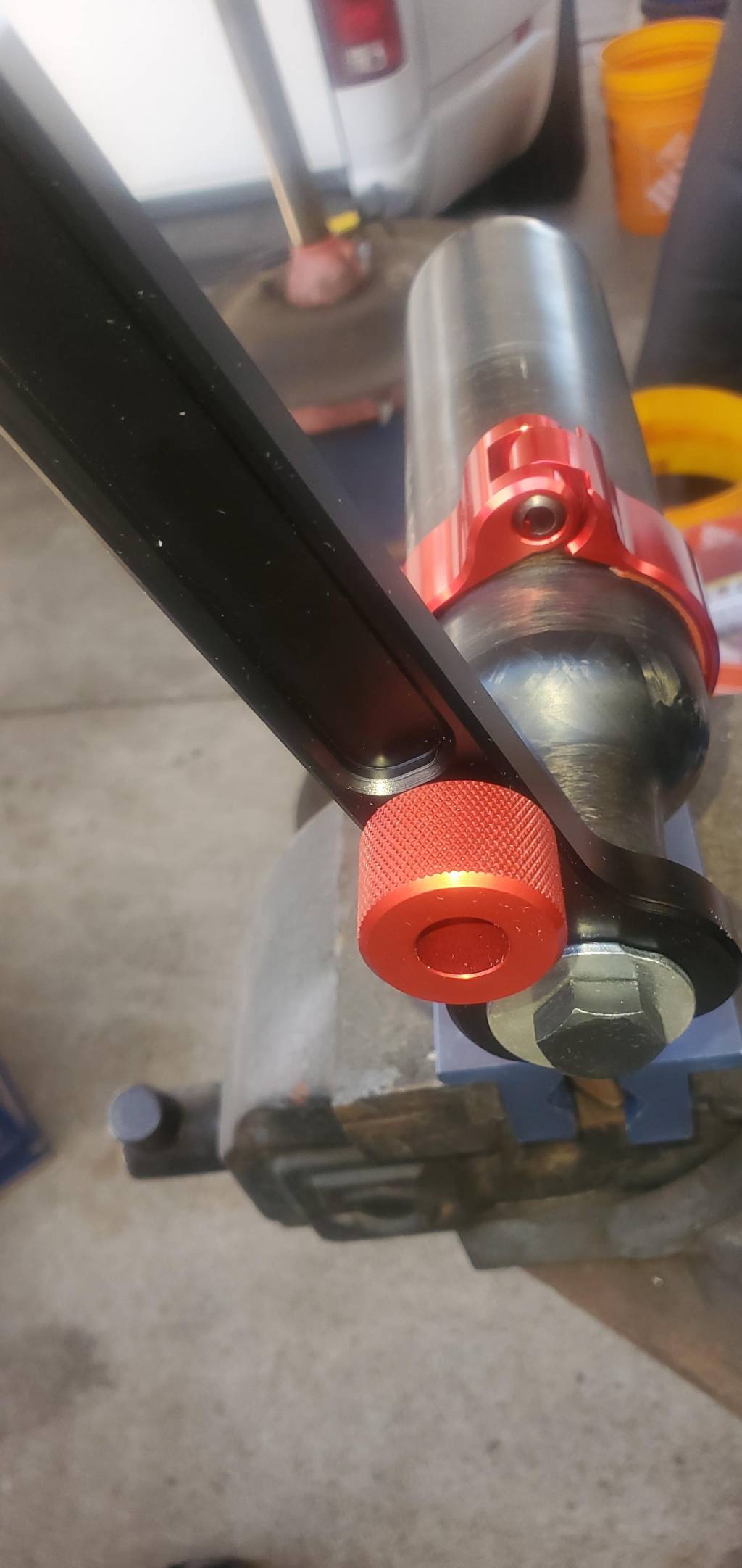

As to removing the valve from the OEM bottle, I heated the bottle and valve -- just as I've done successfully with FX bottles and valves in the past -- yet the valve stubbornly refused to turn, and I simply gave up, and opted to purchase another valve.
Yeah the valve has a lot of thread lock on it. So it is super tight. I had to use the FX tool to remove it. just be aware the threads for the valve itself is a different thread than that of the fx so you have to use a bolt and depending on how long the bolt is washers. I dont have the thread size here at work but I can find it later when I am at home. just make sure to use a pick or a wire brush to remove the dried up thread sealant.
And none get into the bottle.
