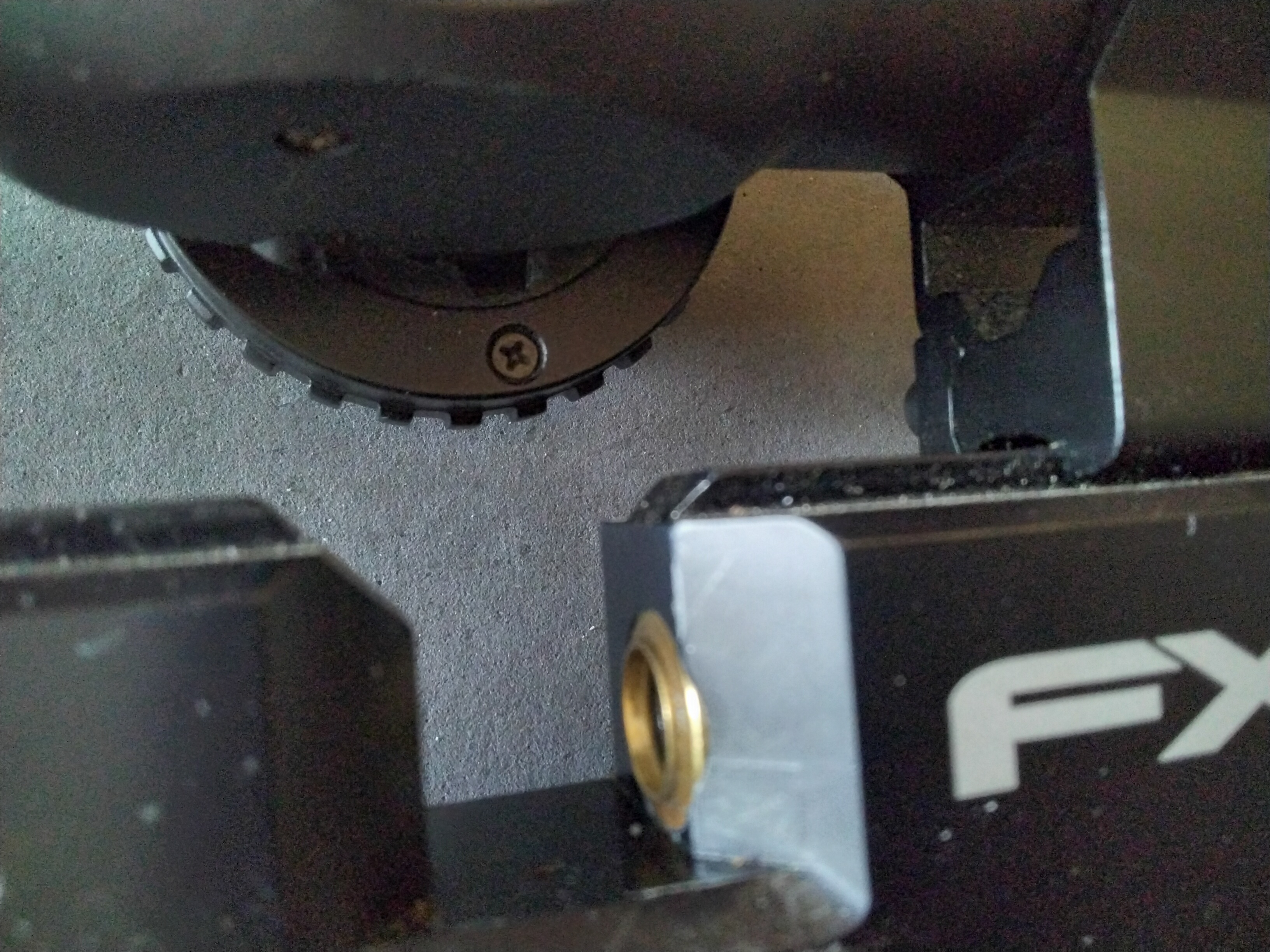

Barrel is out.

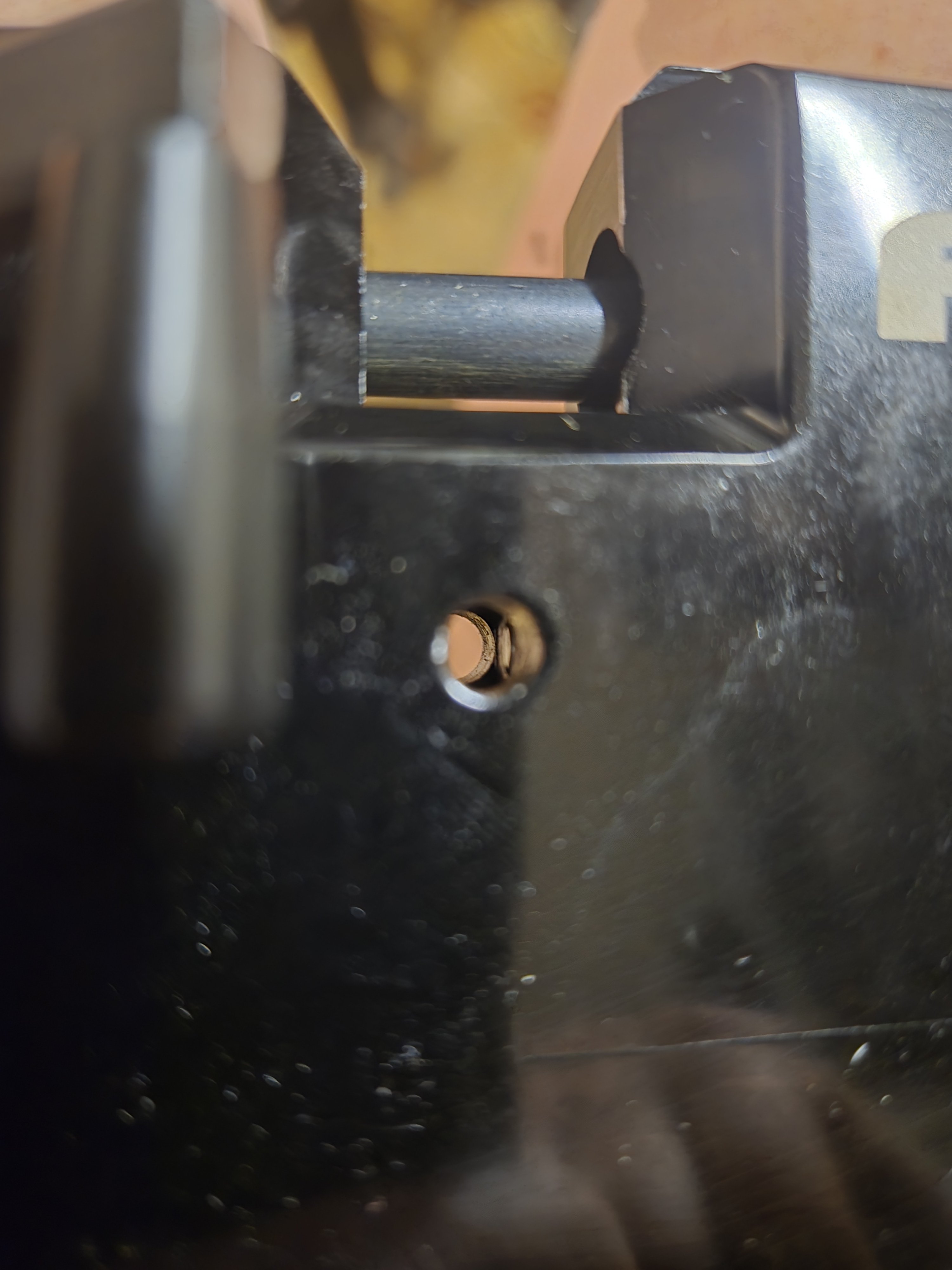

This is an issue between the poppet and transfer port. Air flows direct from whip out the transfer port. It appears something is holding the poppet open. There should be a stub from the end of the poppet visible in the cross hole. The hammer has to strike that stub to open the poppet.
I just can't see what is keeping the poppet from seating.

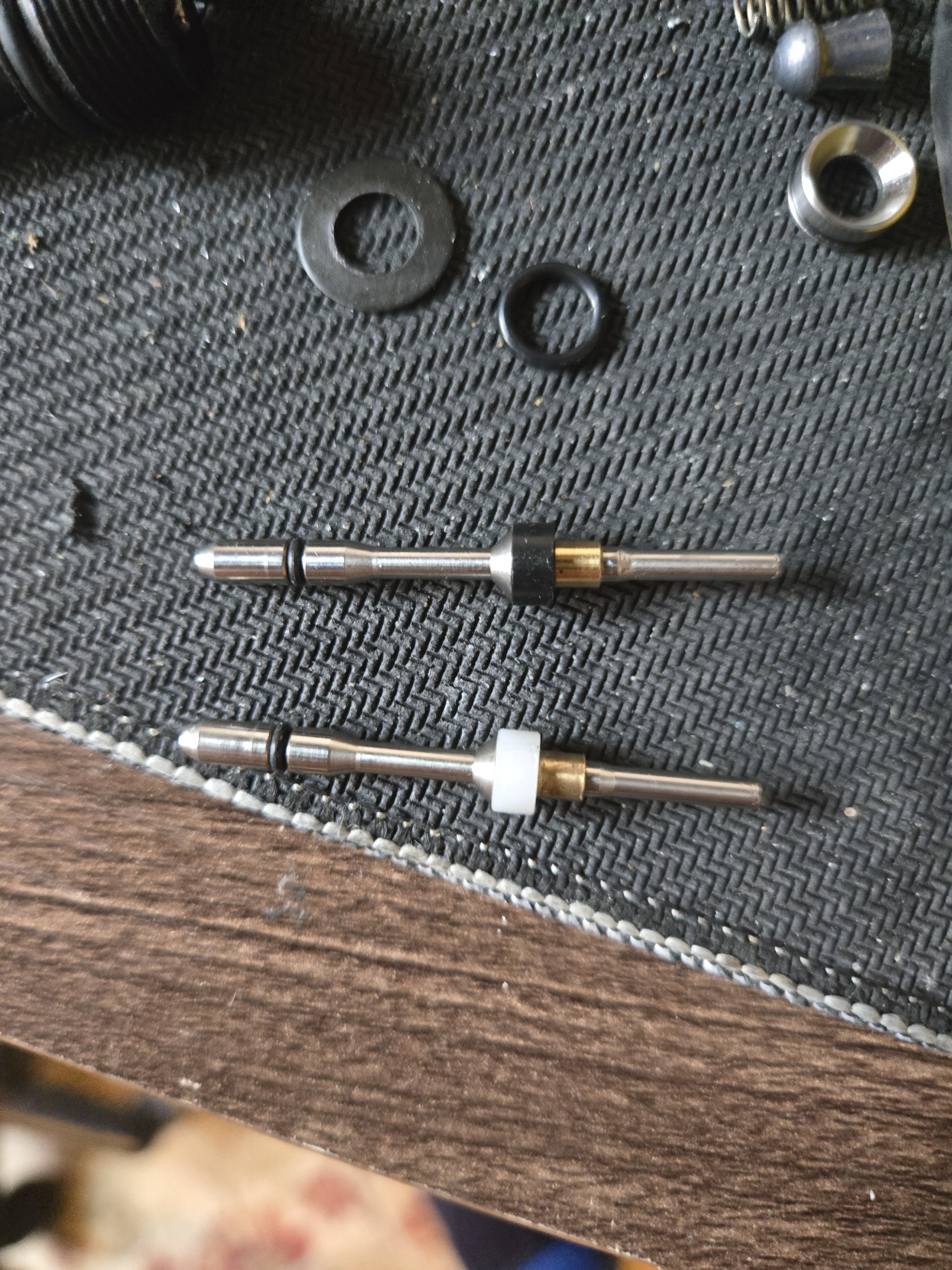

One of the poppet is brand new and never been hit by the hammer. Other than the black ring it appears identical to the original.
Reactions: Normkel
I'm wondering if this is the one recently on classifieds with a Dreamline barrel.

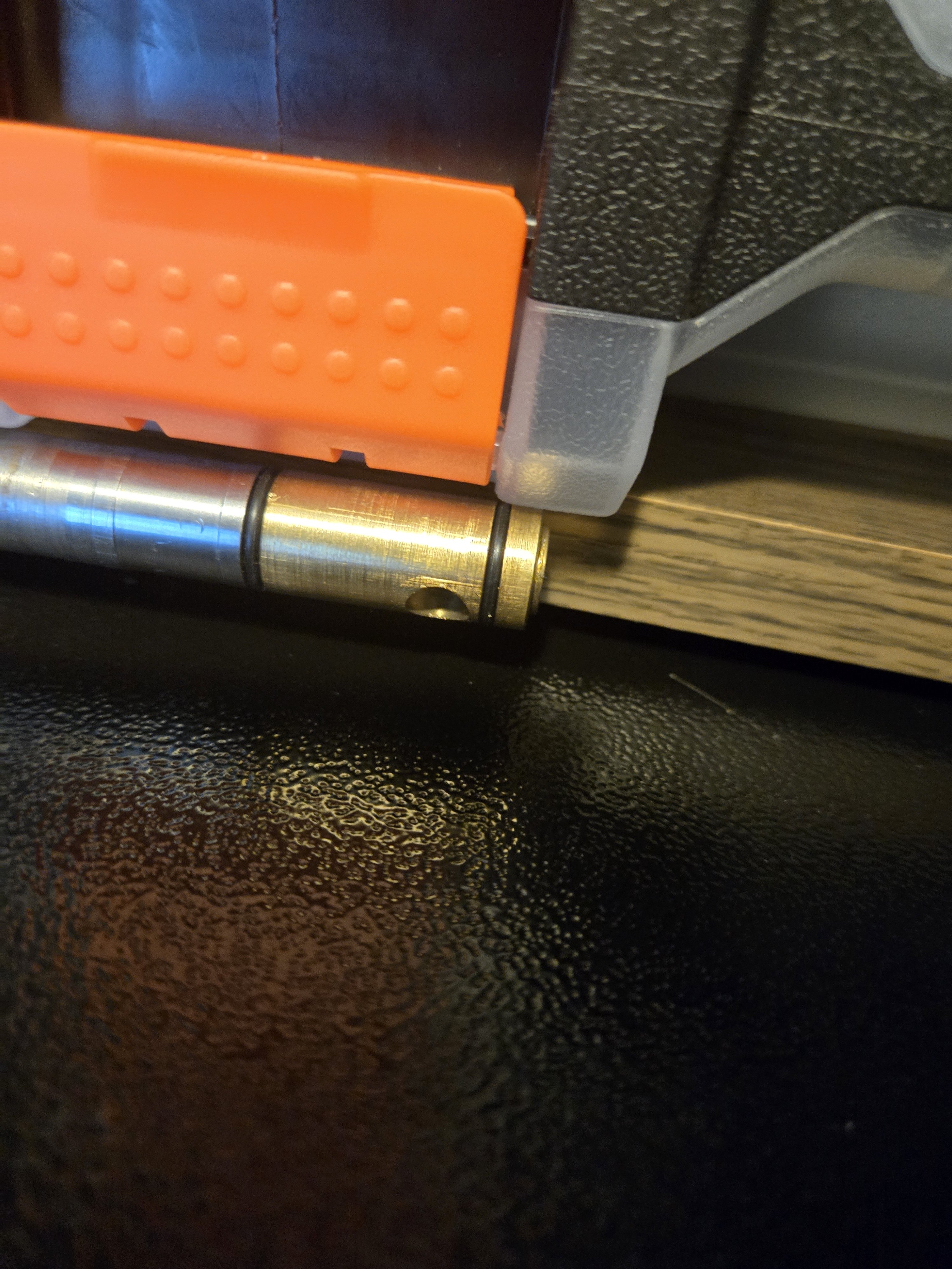

@Gerry52 @Ratzy Does the brass piece around the breech come out with the barrel when you pull it?
I don't see the brass piece on end of barrel in the picture. It's what seals end of barrel in breech & guides magazine fit. Is this a new purchase or owned for a while? I get it, probably disassembled in pic. Duh!View attachment 566774
It does not appear to come through far enough for the hammer to strike.
Both poppets and both valve seats show the same thing.
So I pulled the valve seat and the poppet still isnt fully in the hole.
Something appears to hold the poppet back a few mm. But the channel it goes in looks clear.
Yep, but the barrel should have nothing to do with the poppet seating
Agreed but one never really knows what the last owner/experimenter might have altered. I inquired about the ad but couldn't get info from seller as I was told he "wasn't a shooter". It was a kinda red flag for me.
