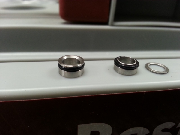

Here is a broken valve seat and a new one on my Royale. It is a failure point. At one time Ernest was making some better ones. Never could get one from him when I tried (still willing to). I have compiled some Royale o'ring numbers here. http://www.airgunnation.com/topic/oring-database-what-im-doing/
