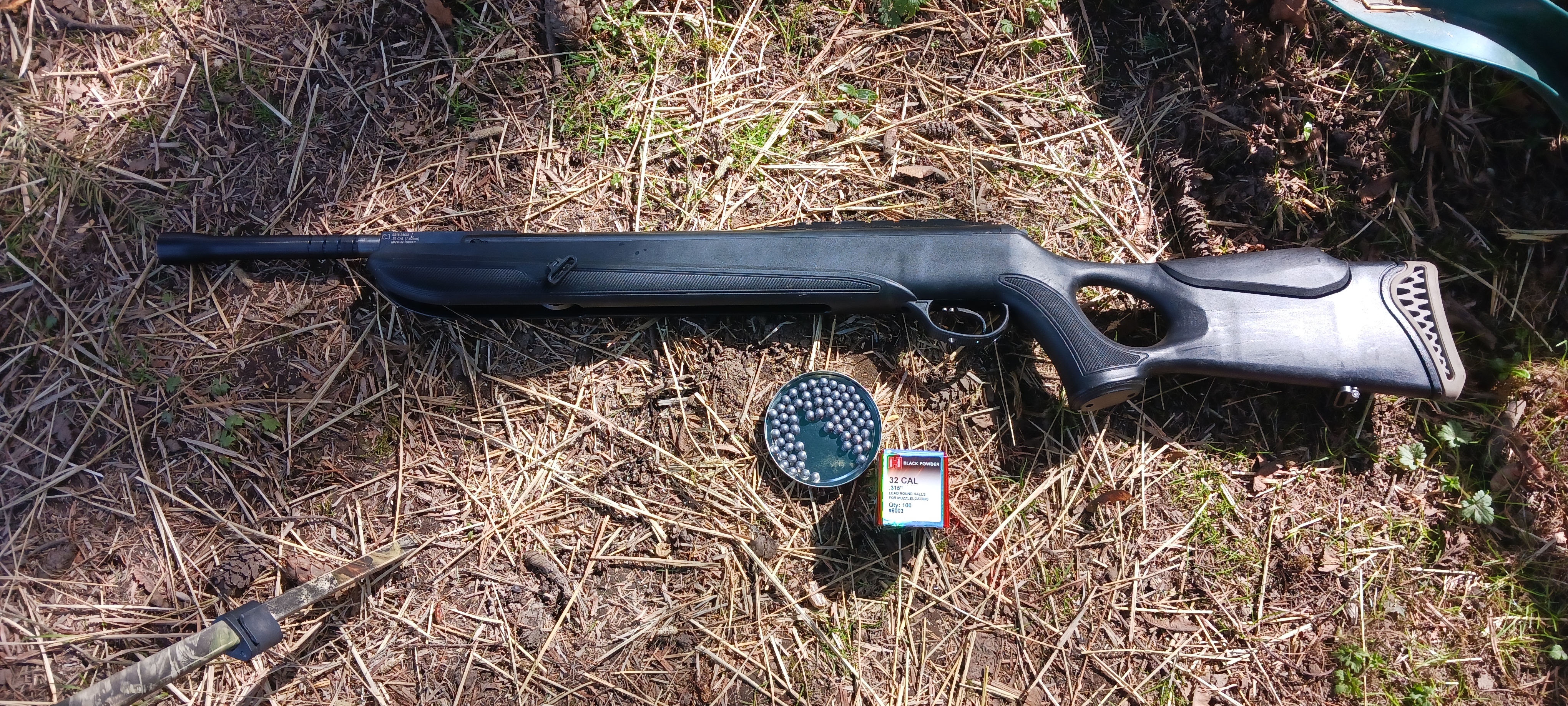

I have a Benjamin Trail .177 that's currently broken somehow (trigger won't release so it's fully cocked, but that's in another thread.) Once I repair that, I'm considering boring the barrel to a smooth .25 so that I have an airgun that I can shoot shot with. This gun was heavily used at a children's camp before it was give to me, so I don't feel qualms about experimenting with it. It's already missing the noise muffler piece (not sure what it's actually called) that my Benjamin Trail .22 has.
Have any of y'all ever converted an air rifle into an air smoothbore?

The Benjamin Trail is a great gun for it's price range, it's powerful and extremely accurate, boring it out to a smooth bore would be ruining a good all around air rifle, Until you find what the trouble is with the gun I wouldn't entertain any radical mods, sometimes when an air rifle isn't working as it should it's a simple fix for someone who is familiar with them.
Somewhere to start is with the trigger screw, if it's been tinkered with it could affect the coCking function, too loose and it won't fire, too loose and it may not set the trigger.
try to find someone who can check it out and find the problem, the gun is worth fixing.

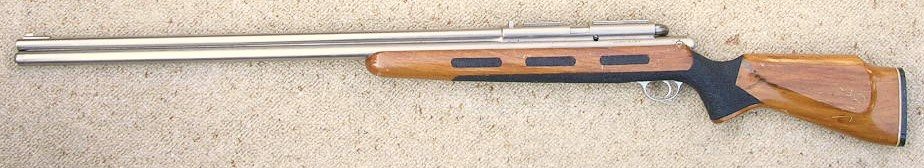

Track down a Farco.
