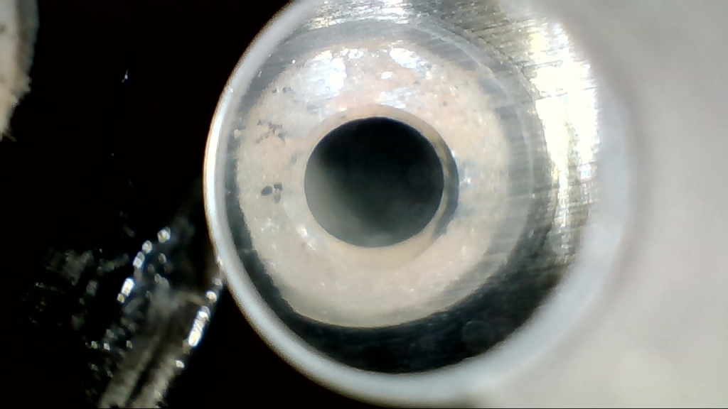

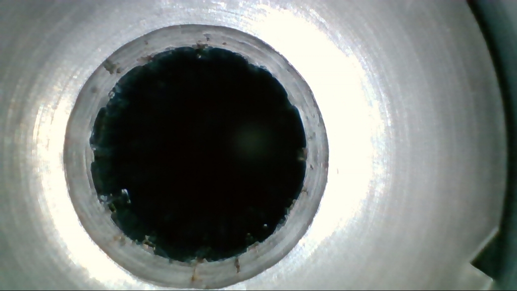

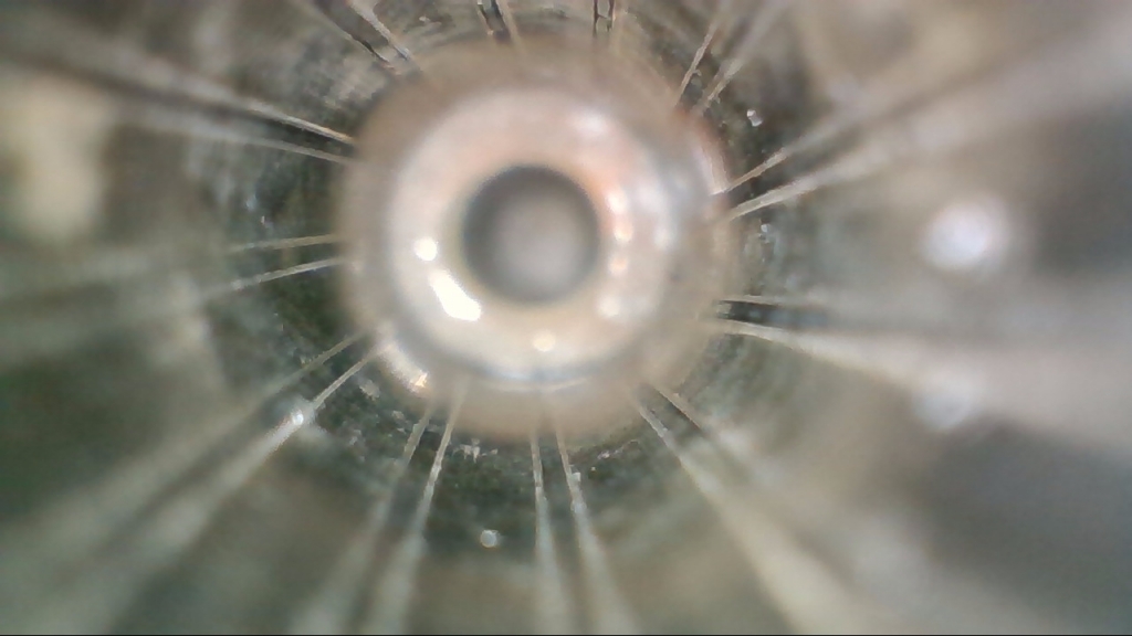

Borescope view of HW 80.....200 shot update.

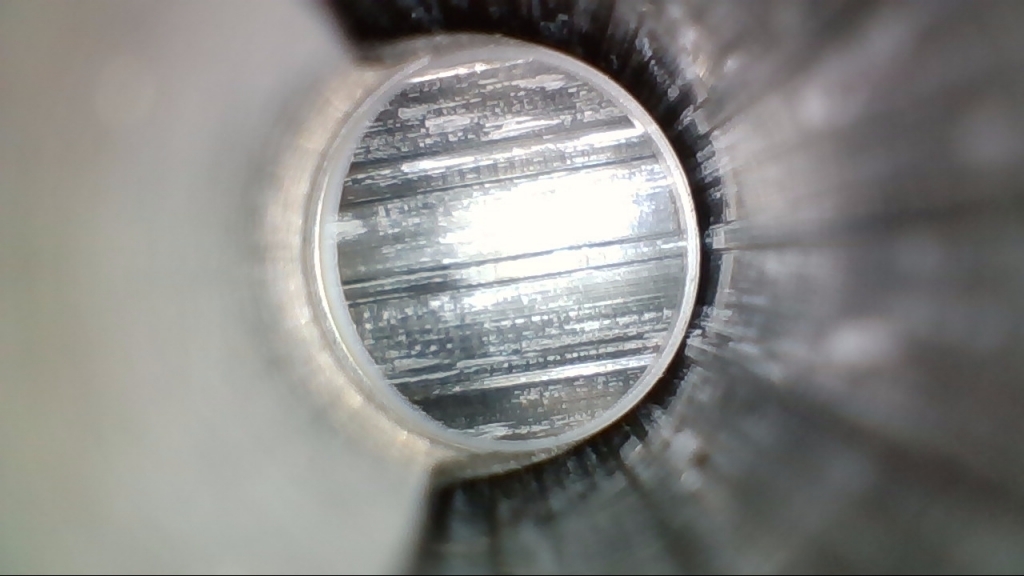

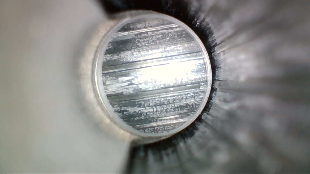

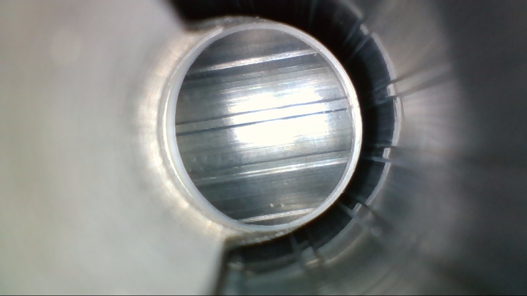

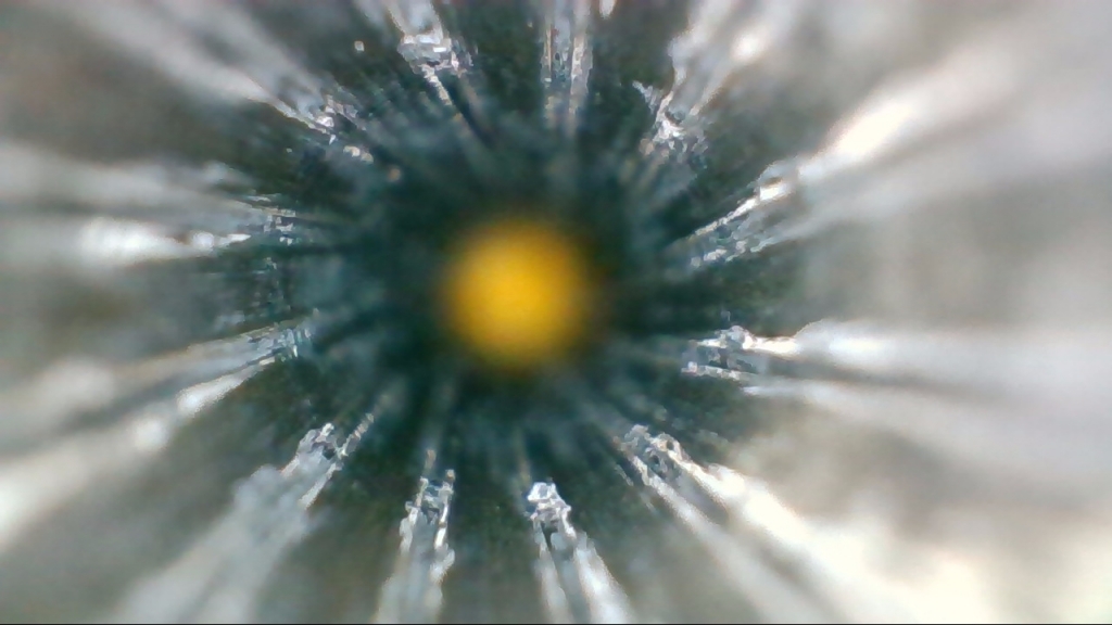

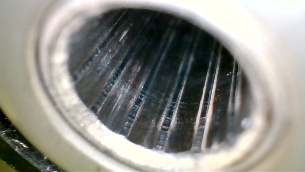

I hit the two tin 1000 shots fired mark late yesterday with my new 80. The spring buzz still remains mostly quiet. FAR less noisy than when new.

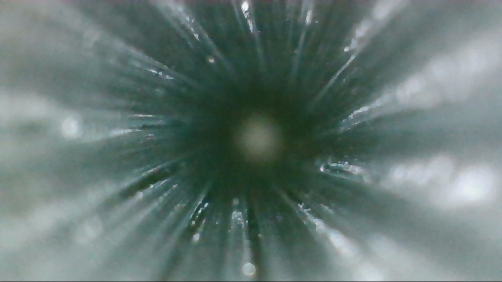

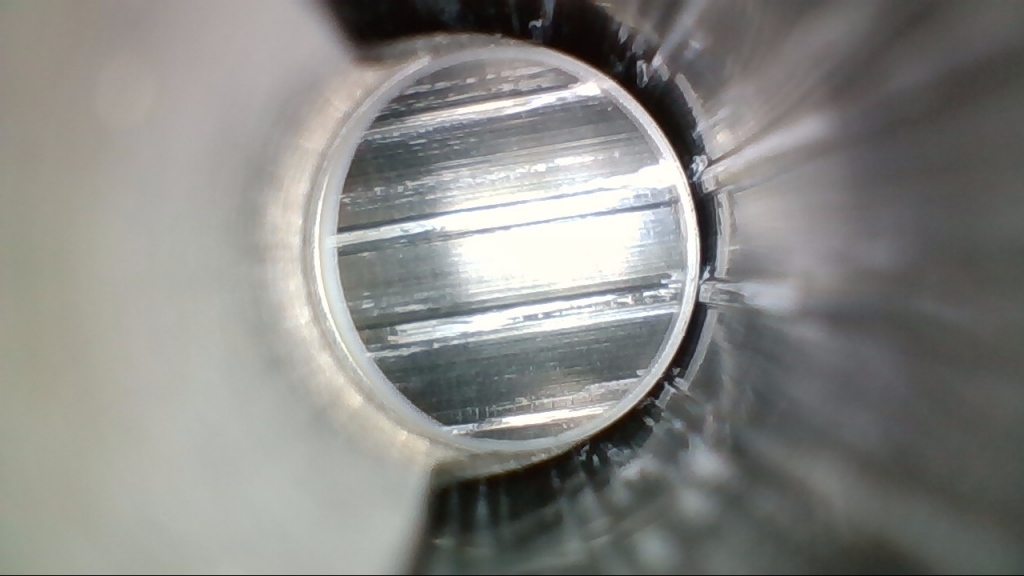

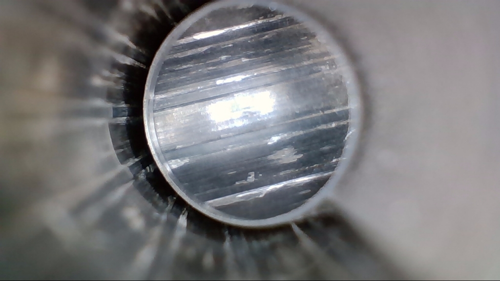

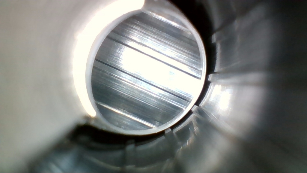

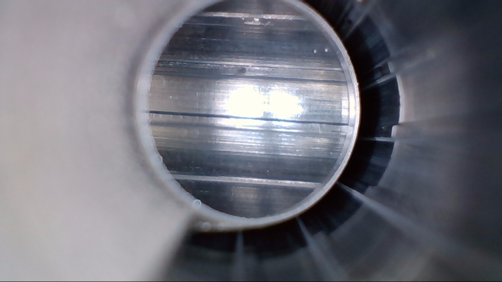

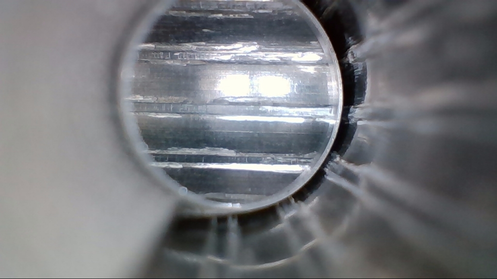

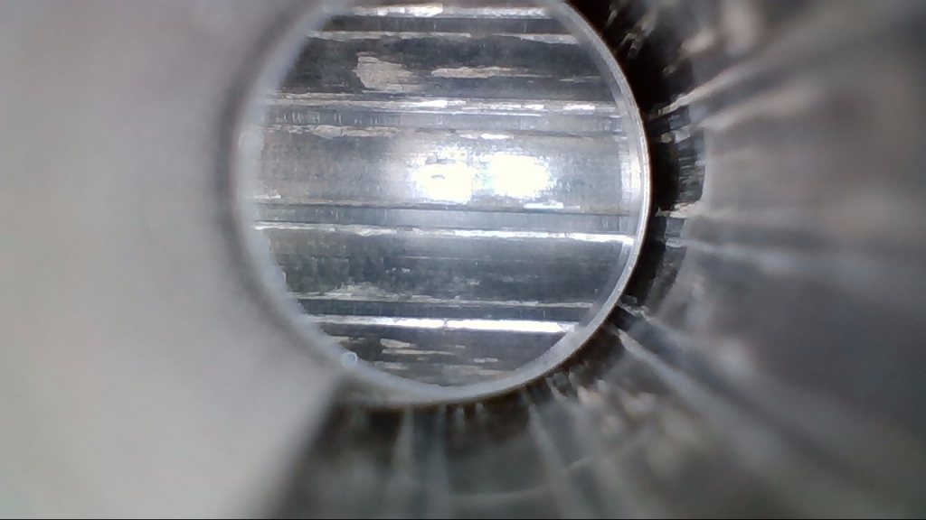

There is plenty of lead streaking in the first inches of the bore and some in the choke areas. The photos are approximately 30X magnified and one would think this is a serious leading condition. The rifle still shoots pellets very tightly, but I will get this bore cleaned up as when new. The leading will only get worse if left in there. Got a Teslong borescope, yet?

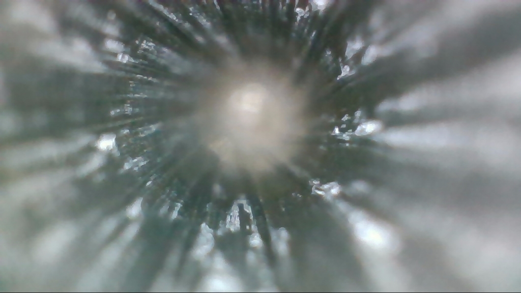

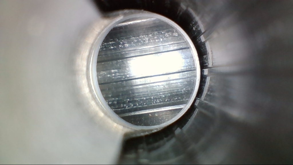

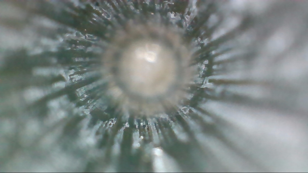

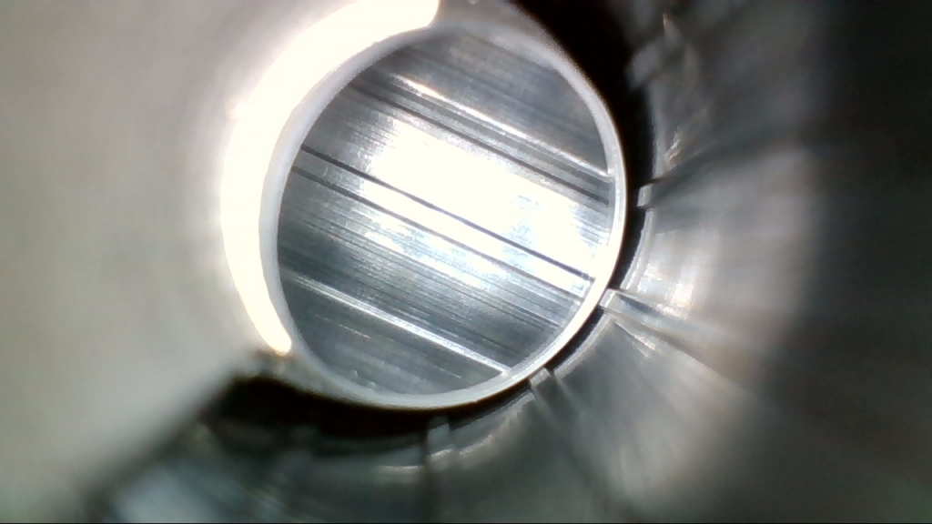

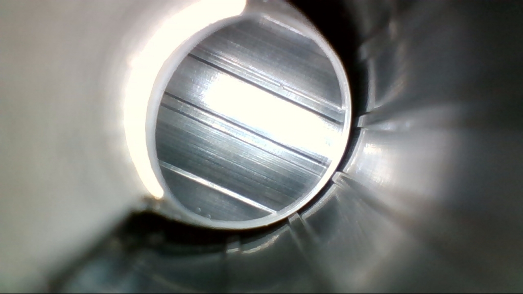

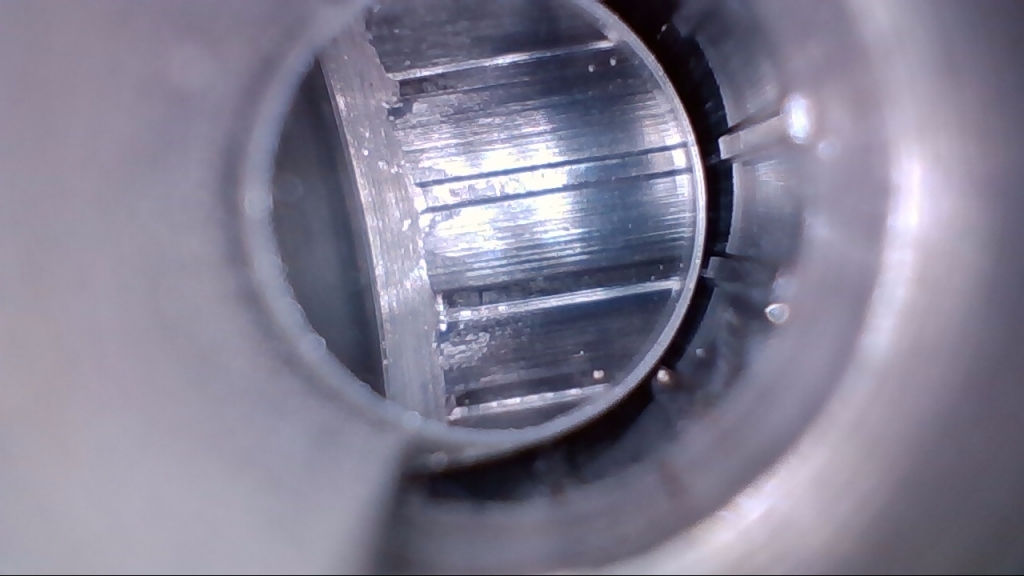

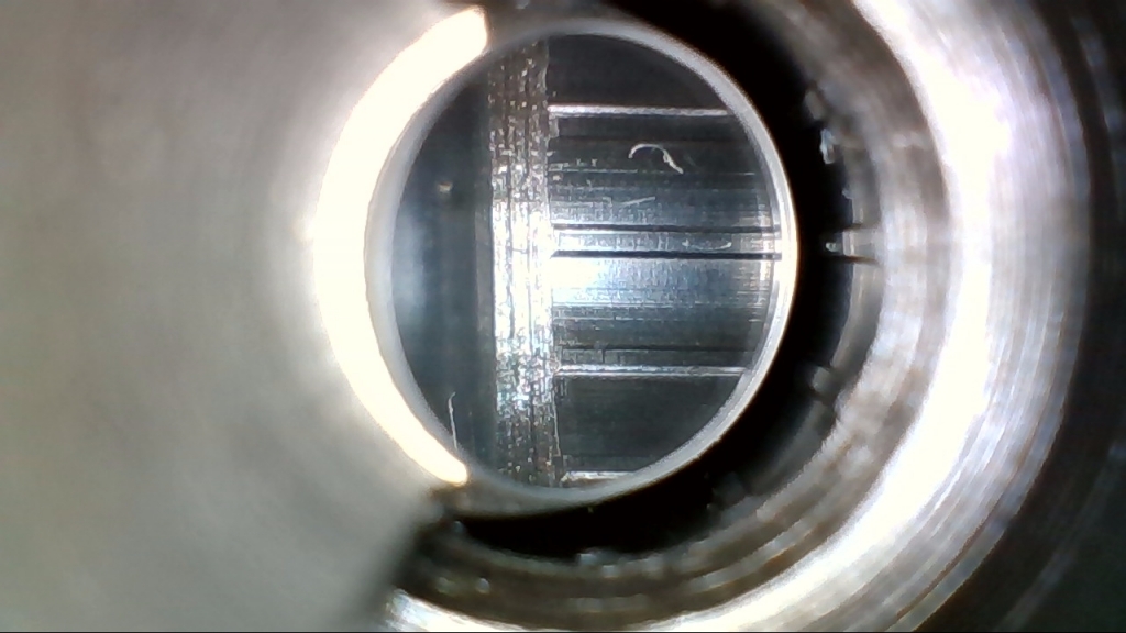

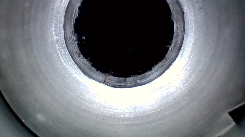

Now you guys really did not think I would let this go uncleaned.....did you? MikeVV, you are way off with your assessment of this barrel. Three pulls through with a solvent damp Hoppes .22 bore snake with a follow up bore patch damp with Hoppes #9 solvent. Then two dry patches wrapped around a Parker- Hale style jag on a nylon .22 Dewey rod.. All traces of lead and contamination are gone revealing a beautiful rifled bore. Just a few traces of lint strands remain. The very minor tool marks in the breech could not even be seen with the naked eye, let alone felt. This is a finely crafted airgun barrel.

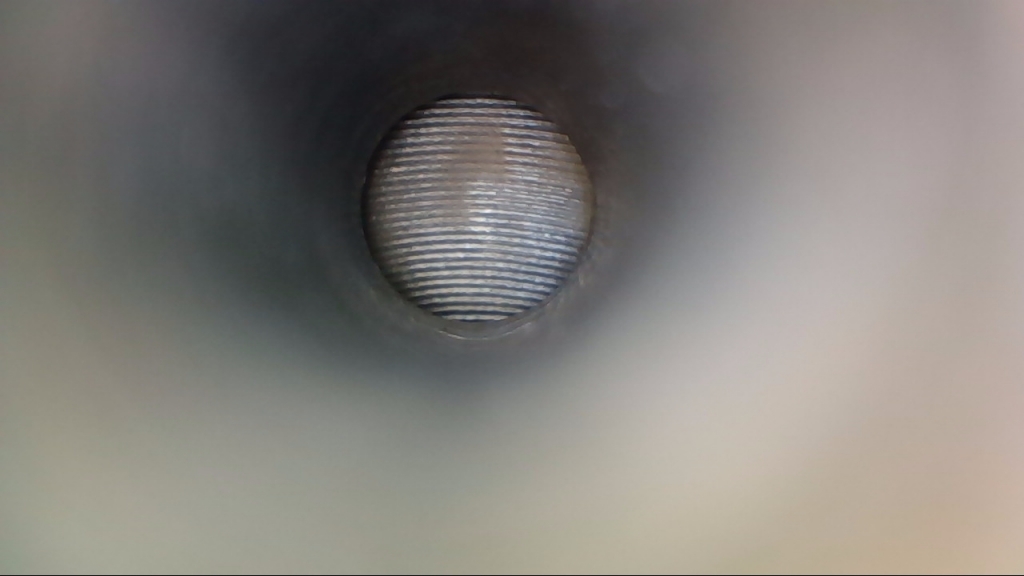

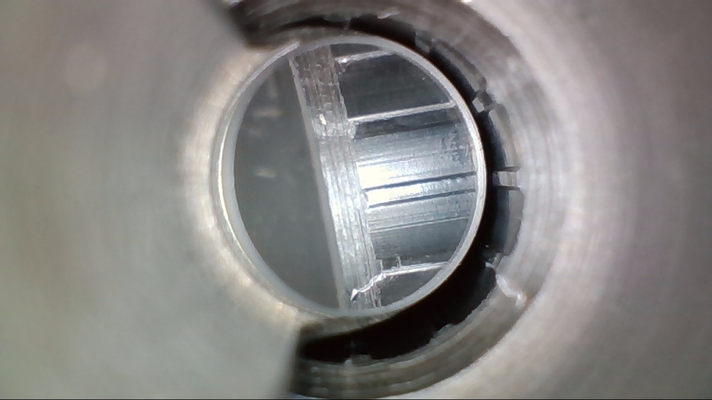

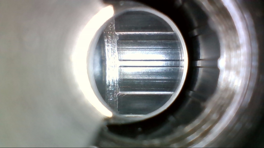

The first set of photos was with the Teslong rigid 21" borescope. This set was taken with the Teslong 40" flexible bore scope....I have both. $50. for the 40" flexible and $70. for the 21" rigid on Amazon. I sold my expensive Hawkeye bore scope five years ago. These are just as good picture clarity and can be shared via internet.

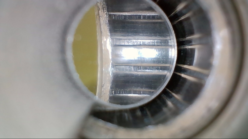

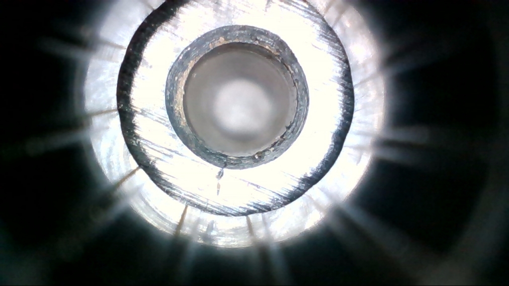

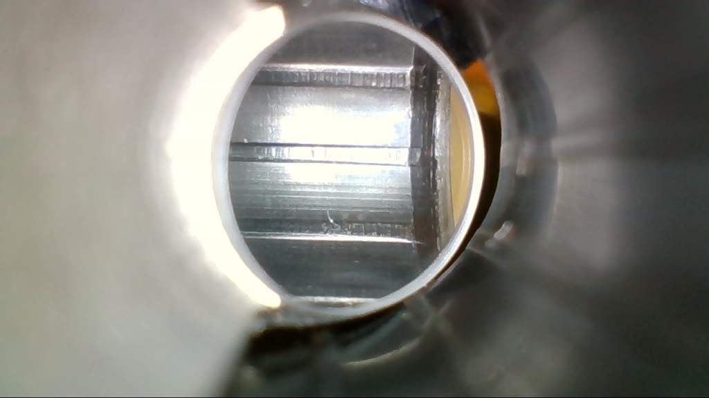

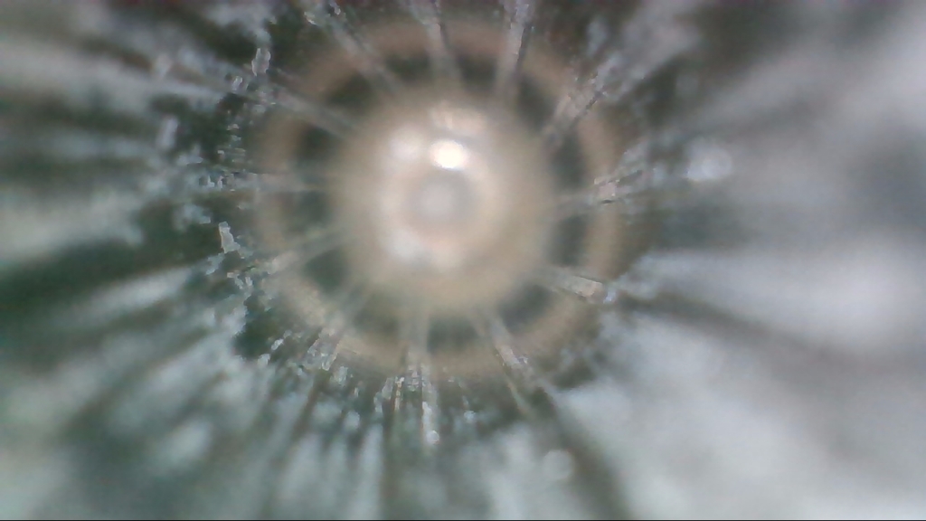

The first photo shows the machined grooves on the face of the Vortek seal looking through the transfer port. Barrel was in a closed position with scope inserted into the muzzle. (rotation of picture not correct)

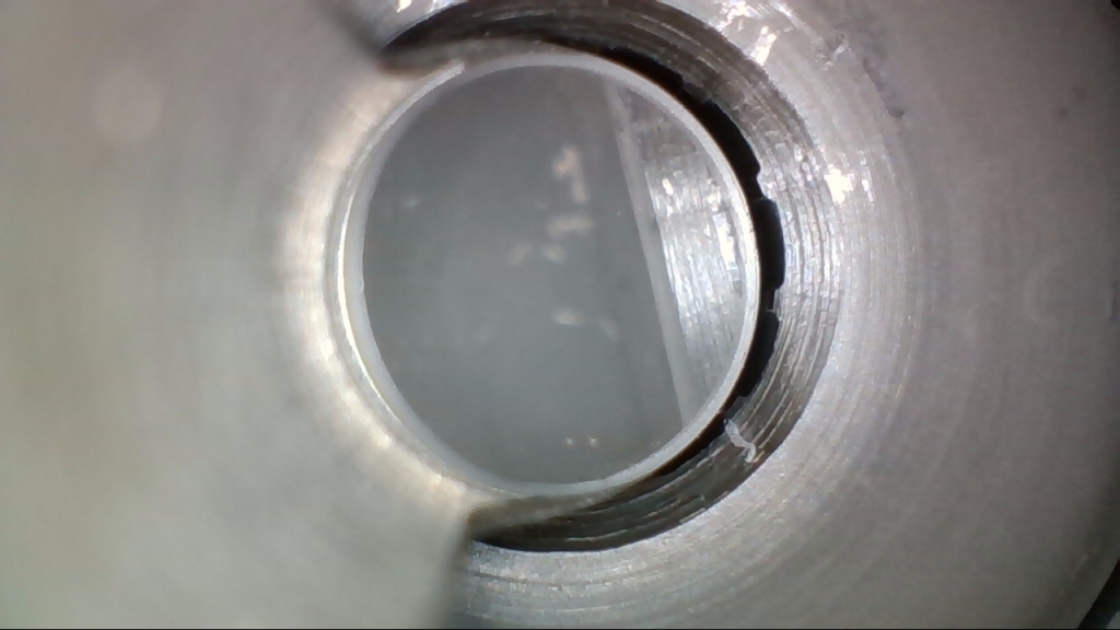

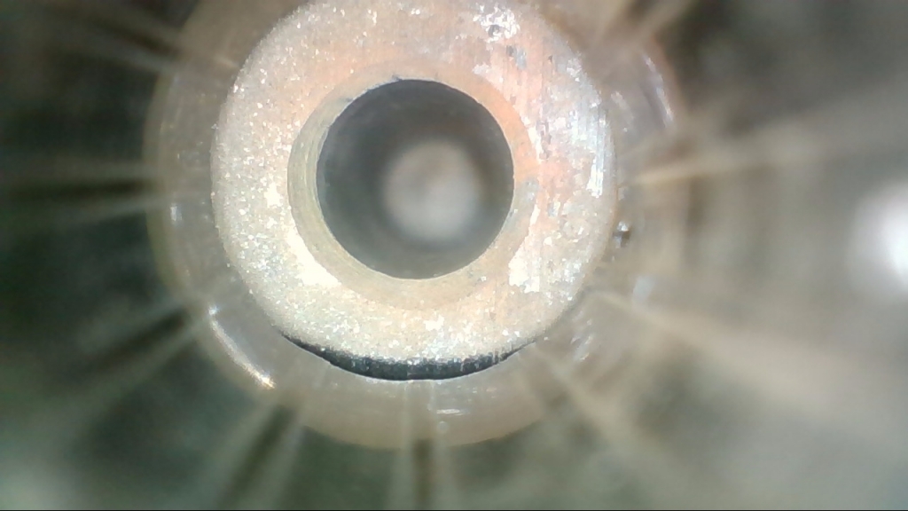

This is the TP and breech face with the barrel closed. No more lead streaks.

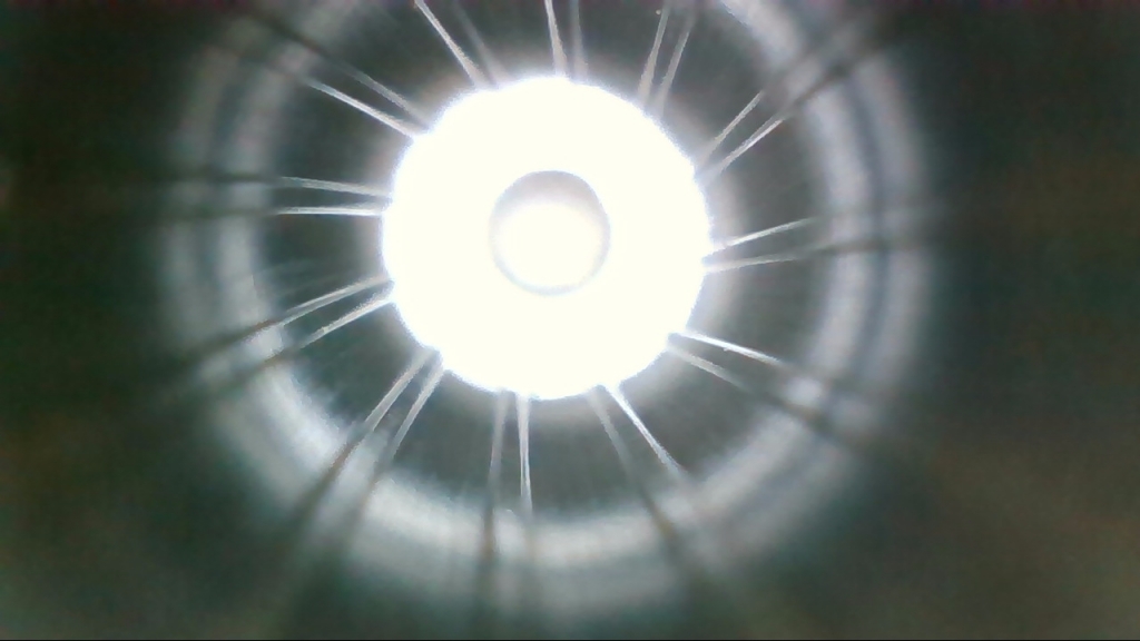

The rest just show a squeaky clean masterpiece of machined steel.
Breech chamfer

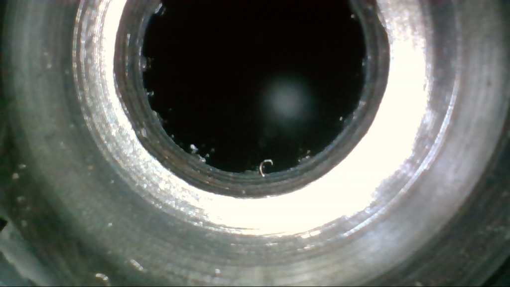

Muzzle chamfer

Now a question for the experts. What is the compressed air temperature when it hits the seated pellet? No doubt it initiates lead vaporization which in turn gets deposited to the steel surfaces, especially that brown ring around the TP.

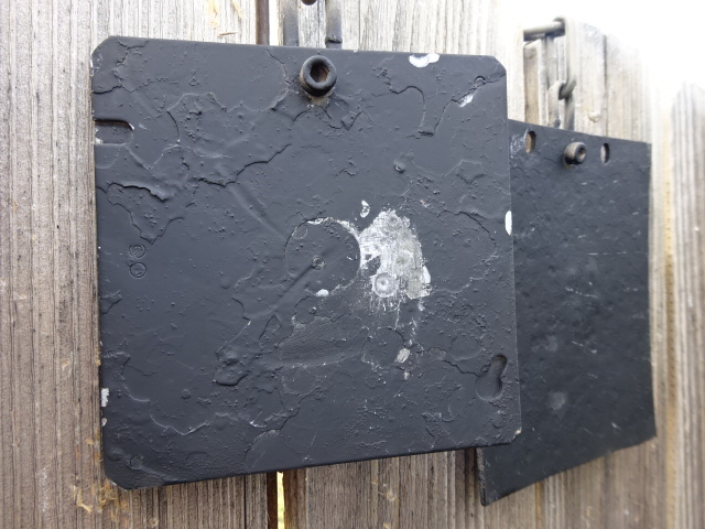

The first five shots after cleaning. Windy...standing offhand....15yds. First was the lowest left one, then aiming for that low hit mark.
Seasoned and ready to go.

Five quickie off hand shots in the wind after cleaning tells me all will be good. Adhered lead attracts more lead as the pellet passes over it. Same as when I shot soft lead .38's too fast FPS. No doubt in my opinion the accuracy would deteriorate over time if left to increase.
That was one week and 1000 shots worth of bore fouling. No cleaning during that time.

My D34's start leaving lead streaks within 100 shots. I use the above cleaning method every 1500 or so shots. I do see improved accuracy after cleaning....shots going to call with out questionable misses. I will bore scope for a look at 200-300 shots and report back with a picture.
I only clean mine once accuracy starts to fall off. After cleaning I'll run the bore scope through it and see if there is any smeared lead in there. If there is I'll clean it some more or leave Ballistol in the bore overnight to try and loosen it up more and then run some patchworm felt buttons and some coarse rough 7/8" patches through it. Generally I keep the velocity down to 910 fps or less so there isn't usually too much leading.
Each gun I have will have will get lead buildup at different intervals. The CZ barrels seem to need less cleaning and the LW barrels require more for the best accuracy. My Cricket can easily go a thousand rounds between cleaning, but my Matador will be lucky to get 400 rounds between cleaning.

There is still leading going on even with so few shots fired. Some in the choke area, but the first three inches of pellet travel have the worst deposits. A couple of light spots mid bore. The accuracy remains outstanding. I will make 1000 to 1200 shots fired my bore cleaning interval. Bear in mind this is 30X plus magnification and not a serious lead buildup issue.
