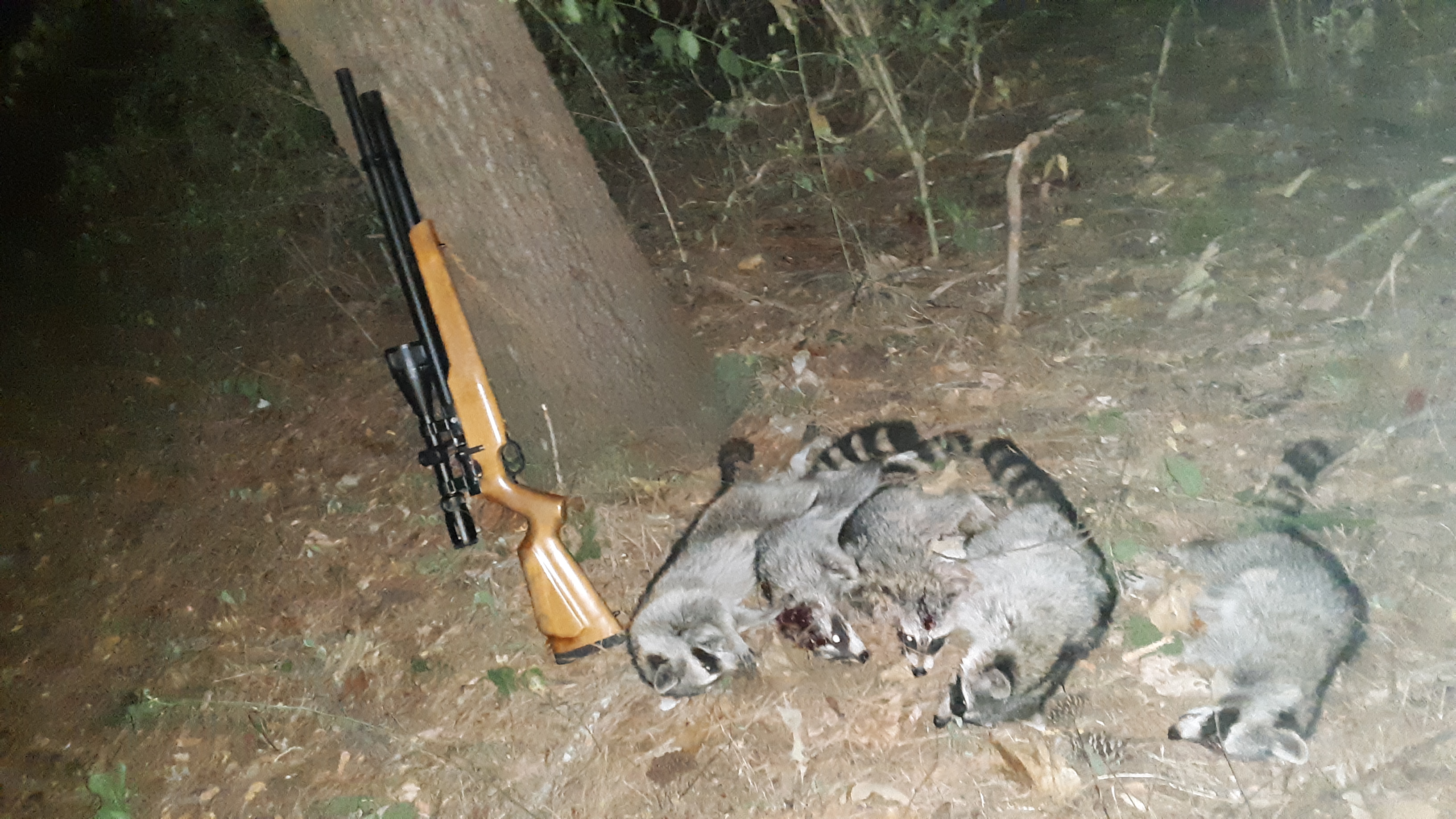

I always go for the head, heres another example of you don't play with polymags,
.22 cal. all these guys were in the same tree next to my chicken pen, they had gotten in one pen and killed two a few nights earlier, i think i killed the whole family.
