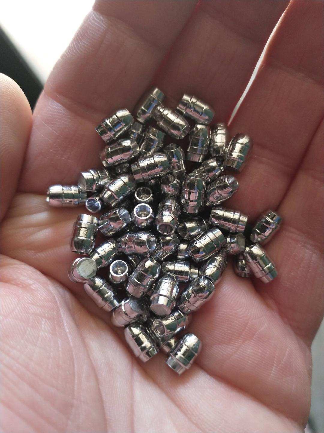

If you cast, this one is a winner. My Cayden shoots them really well at 100 yards.
