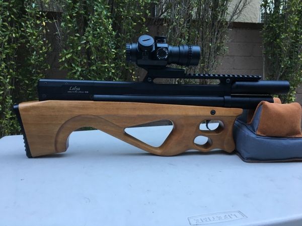

I recently bought a used .20 EDGun Lelya old version and have some blowback when I shoot. I’ve tried the screw at the rear as shown in the Ernest videos but in no screw position does it stop the slide from coming back a half centimeter and air blowing out the breech on a shot. Anyone have any ideas about this? Appreciate any advice. Thanks.

Same thing happened to me, I had a blowback when I first received it and adjusted the screw in the rear and no more blowback for months. A few months go by and same thing so I thought maybe the screw has backed off or something so a little loctite and some adjustment to the screw but I kept getting blowback. I ended up removing the sliding breech and pellet probe and found that the first o-ring closest to the tip of the pellet probe was cut, I replaced the o-ring and all was cool until my new o-ring was cut to. That’s when I did some research and found over on TalonTunes forum a guy posted about how he had the same issue and the culprit was a razor sharp breech entry, right where the pellet probe goes into the breech to seat the pellet, I followed his instructions and took a dremel and polished that sharp breech entry to a 45dg• angle and voila problem solved. The old Lelya has a few minor bugs but they can be resolved with a little TLC. I know it may take a little warming up too but if you can exercise patience and get comfortable with that little micro pup, she will deliver, mine is extremely accurate for its size. I replaced my factory reg with a Huma btw and am running it at 120bar for 32 shots at 770fps.

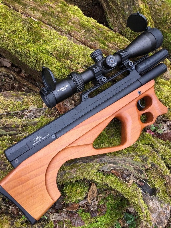

Figured out after trying to do the adjustment shown in Ernest’s video that the problem was both probe orings were missing. You can’t see where the orings fit on the probe until you disassemble that part of the gun. Not sure if they were missing when I bought the gun or blew out when shooting. The orings are very small 1x3mm. Shoots great now with no blowback after I installed the two orings.
