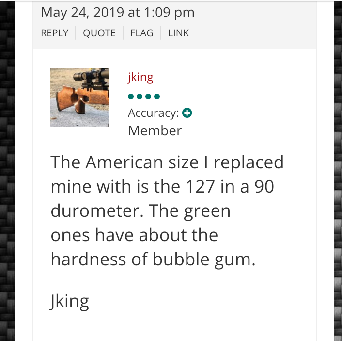

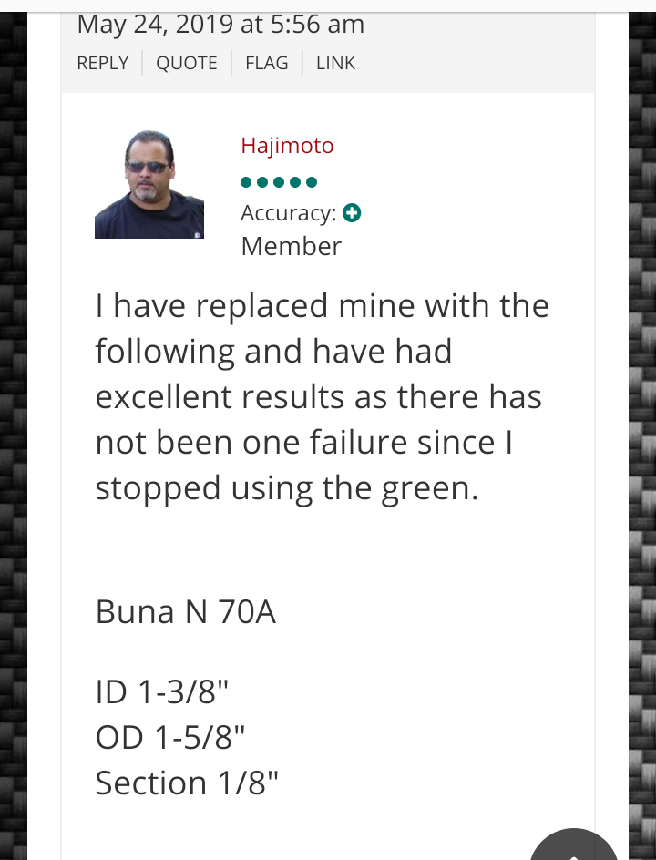

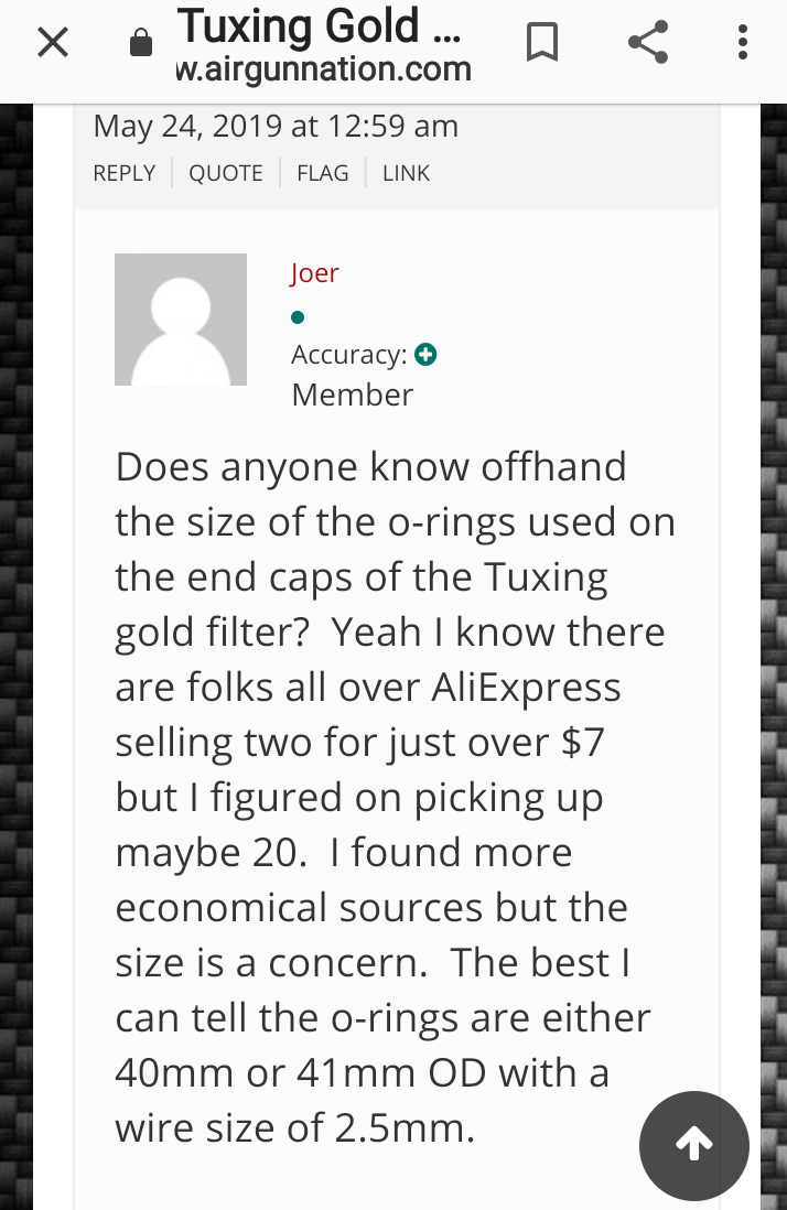

Hey guys, I need to appeal to the general knowledge base if AGN. My gold water filter from tuxting had an o-ring failure on the end cap. It's the largest diameter green o-ring. Y'all happen to know the size of that bad boy? I want to keep my tank and guns dry and clean and don't want to buy another 100.00 filter if I can just get the o-ring replaced.
