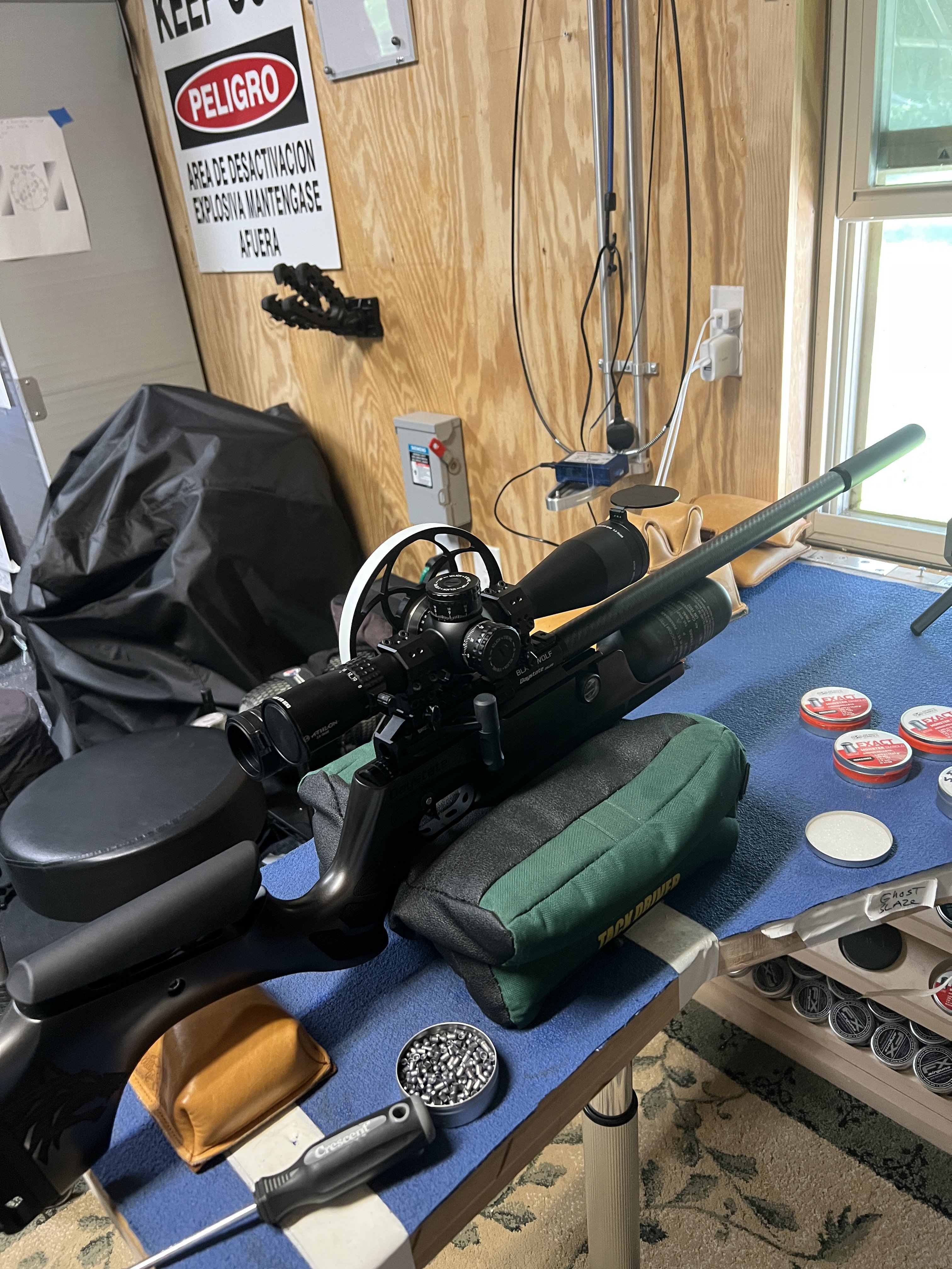

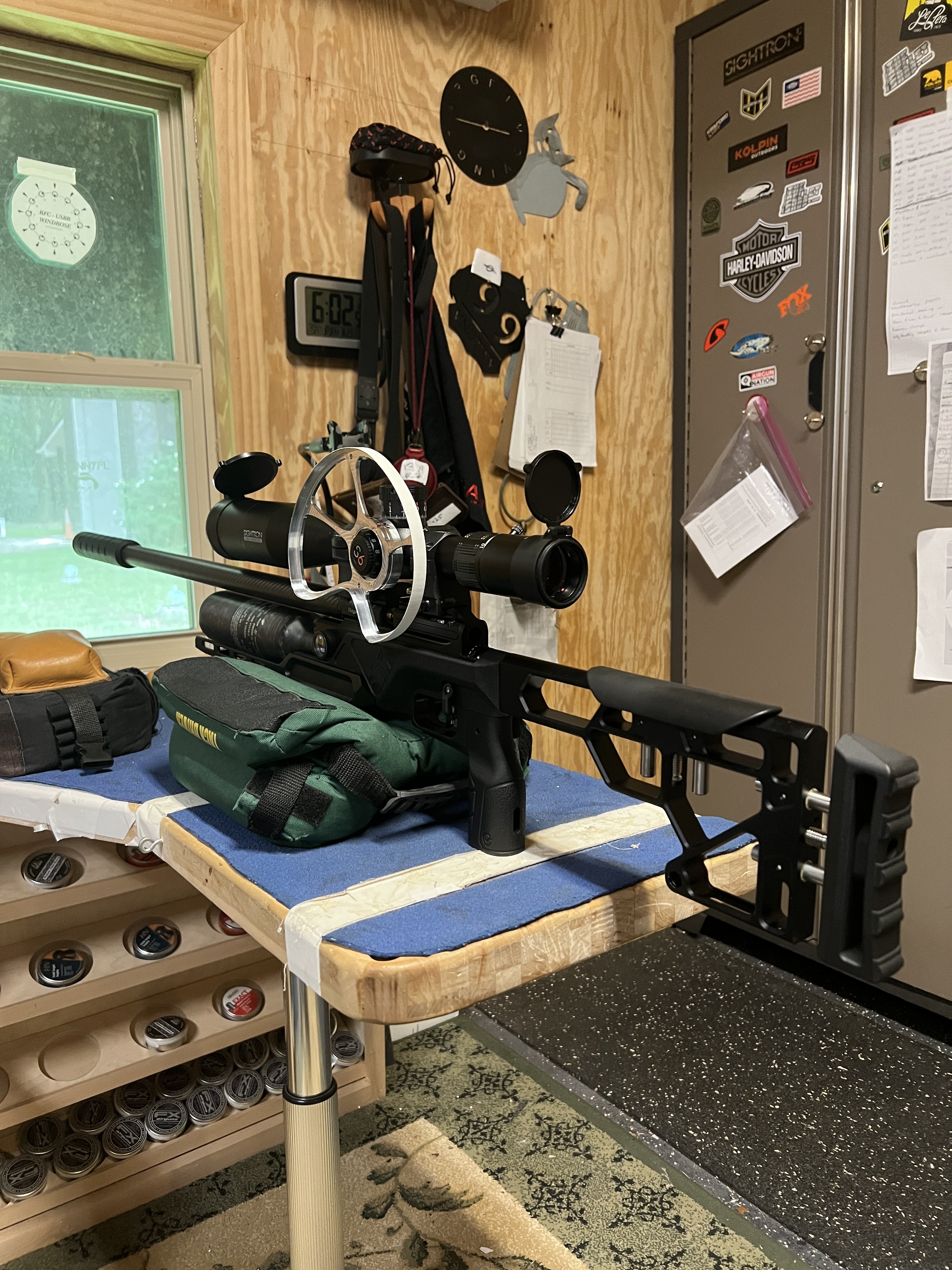

I got to spend another couple of hours with the Blackwolf today. AOA set the reg at 120 bar and had the power wheel at 6.
Norman has temporarily settled on a Athlon Heras SPR 6-24x56 mounted with Burris 1.25” 30mm signature rings.
This BW has a sub 12 non FAC transfer port and the low power white spring installed.

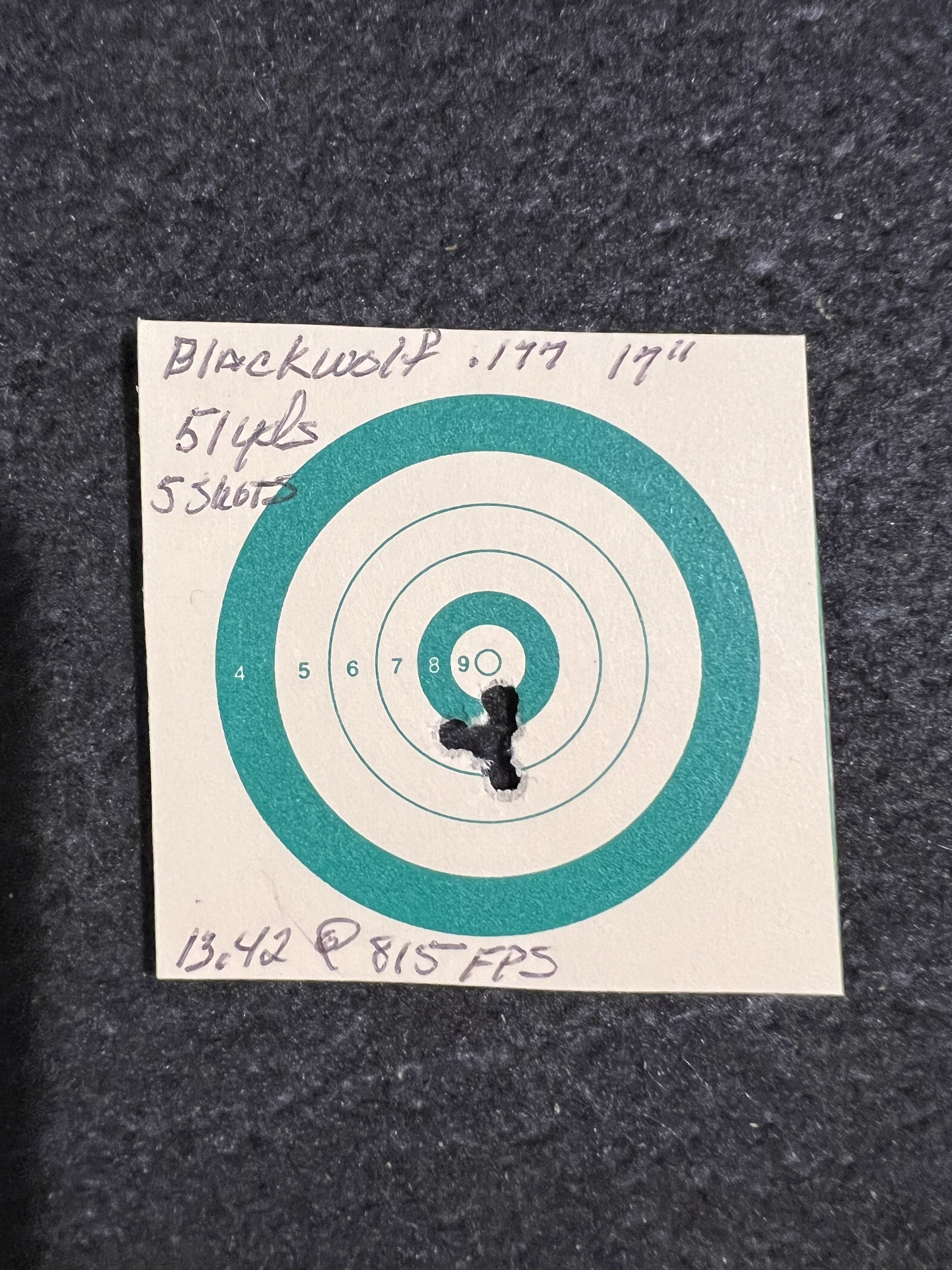

My Garmin chronograph indicated the 13.4’s were moving at 786 FP, too slow so I kept increasing the power wheel and at 16 I hit the HFT sweet spot for this pellet weight 815 FPS - I zeroed in at 27 yards using JSB 13.4 RD’s - perfect weather and I was drilling the same hole. AOA probably tuned for 10.3's at 880 and left power wheel on 6.
Afterward chrono work, I took a shot at 10 yards to get the holdover information I needed for strelock pro to determine center of scope to center of barrel. Shazam!
Using clicks on this Mrad scope every single shot was spot on from 10 to 55 yards and I knocked down 63 targets in a row - from the bench. That was a first for me! I’m betting Norman has a real winner here with his HFT Blackwolf.
