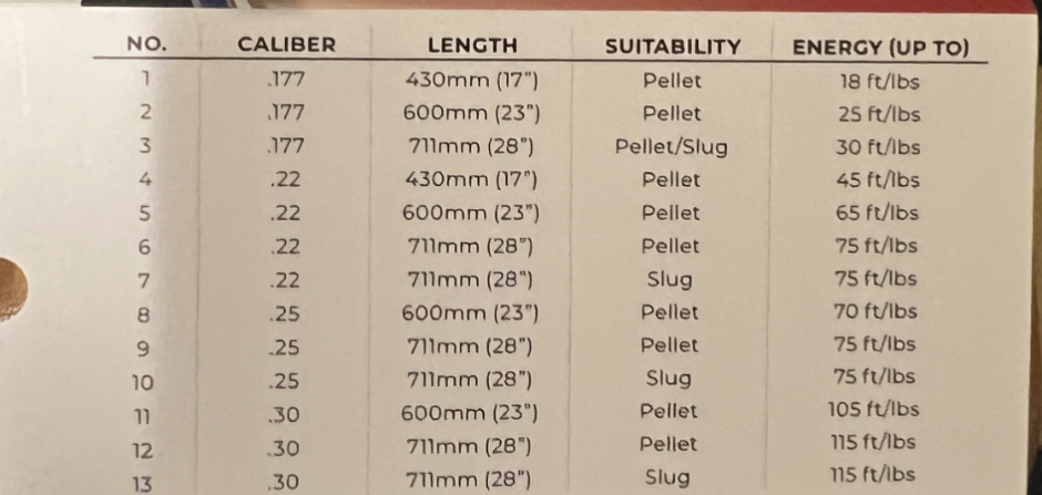

Just pulled the trigger on a Daystate Black Wolf with 28 inch barrel, anybody out there shooting slugs with this gun and what are you using?
I thought that to that 28” but whey make a slug barrel tooAlso, have you done any tuning yet? My BW (23") came to me with the regulator set to 150, but I'm having a lot more luck with it all the way down at 100
That is my next step, how do you let the air out of your gun?Slug barrels are 1-17 i think pellet barrels are 1-30. Turn your reg down to 100 bar and work up from there with your hammer wheel on max till you get to what you want for highest velocity then work around there for a fine tune
22 “28 barrelWhat caliber did you end up getting?

Not for quite some time, I've been told. I doubt anyone can say for sure though.When will they have barrels for the black wolf?
