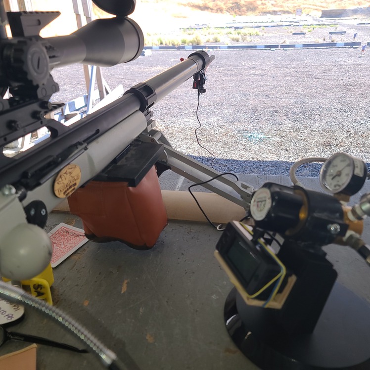

Here is my setup for the Texan .257 LSS, which as a bit of recoil. I shoot 85 grain slugs at 3100 psi.

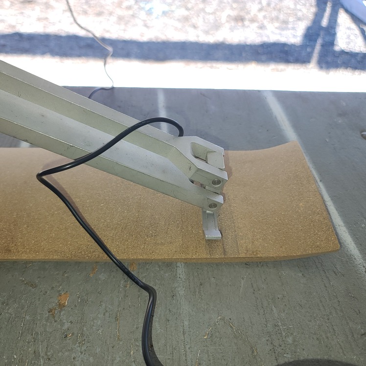

3/8 inch Cork strip matt for bipod skis.

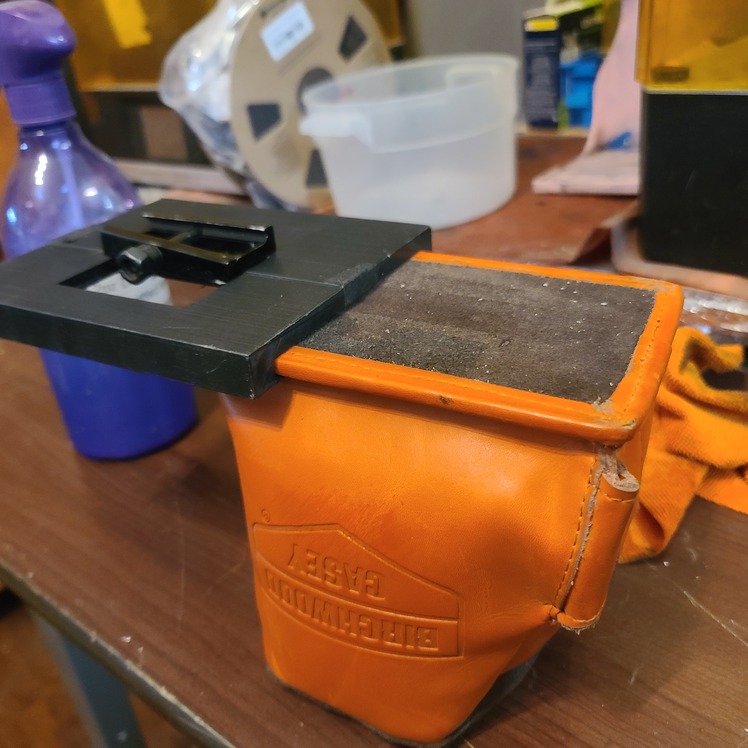

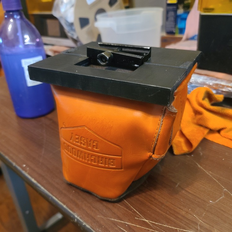

Custom modified 8 pound inverted shooting rest with 3d printed holder/picatinny adapter.
This setup works great to reduce bipod bounce 90 %
