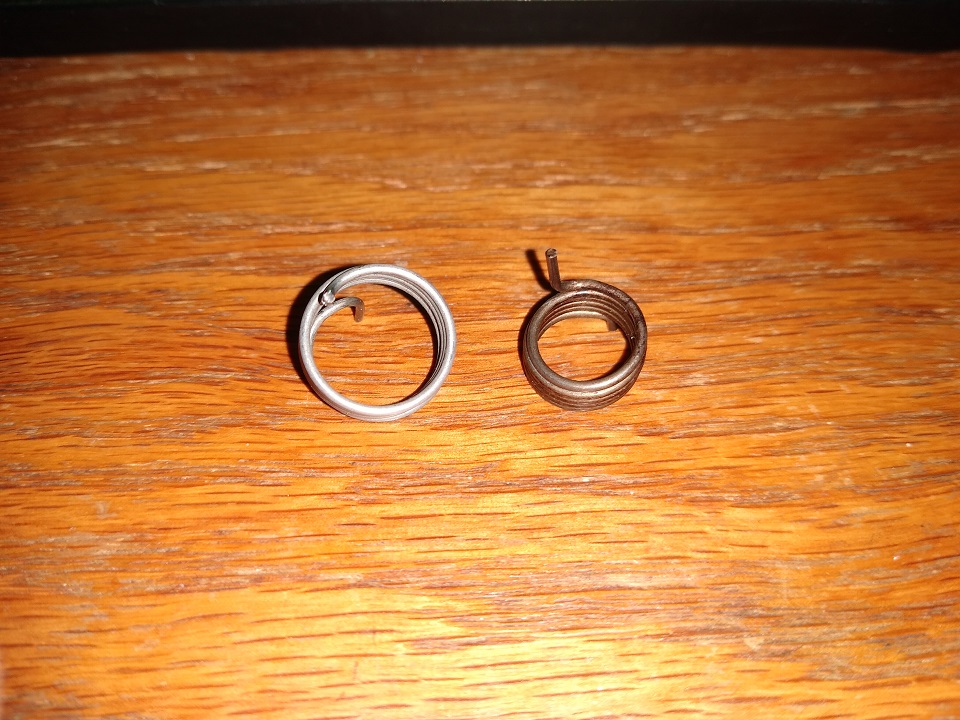

I got mine two days ago. The magazines are too hard to load. I've been loading just two bullets because it gets so hard to twist that I'm afraid the spring pegs will rip out of the plastic. It looks like the spring is wound with too small a diameter. The inside dia. is just barely bigger than the shaft it is wrapped around so when you turn the face plate the spring tightens on the central shaft. I will try making some springs with more clearance. Hopefully, AEA will remedy this problem. Also, mine was supposed to have a front bottle, that wasn't included maybe it ships later? Also, I haven't been able to figure out how to decock the gun so the hammer spring isn't compressed all the time. Pulling the trigger and letting the cocking handle forward doesn't work. Regards, Tom

Hey, the pictures work now. Regards, Tom
