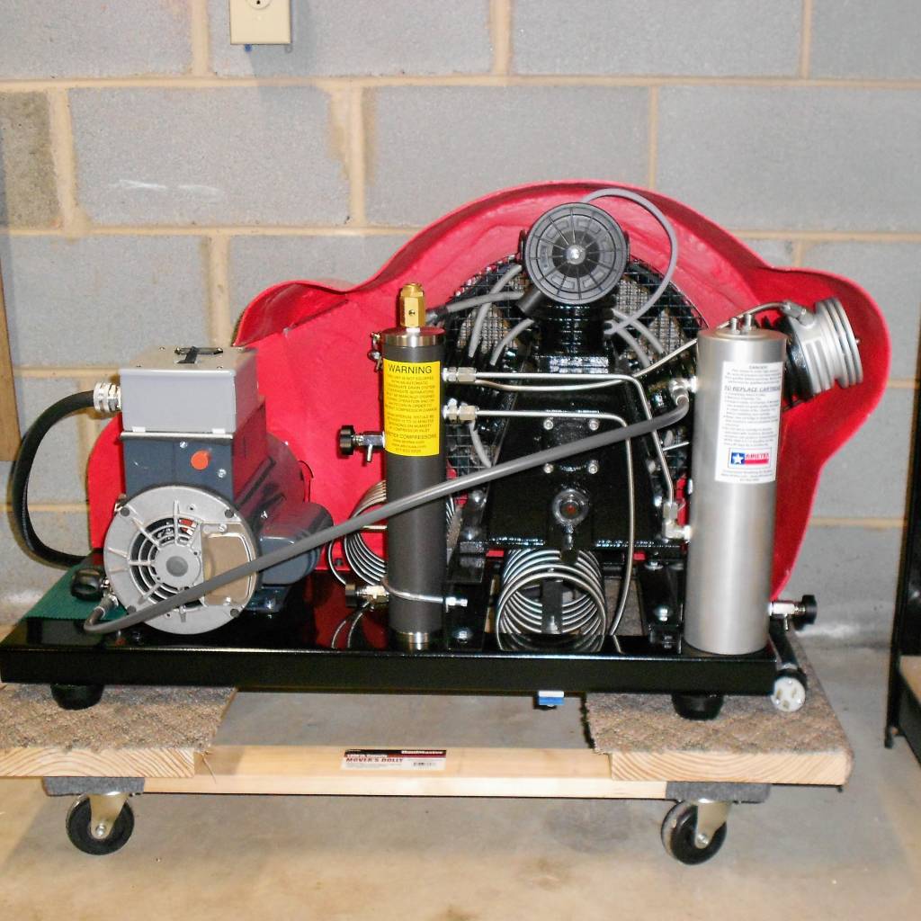

I shoot my pcp's almost every day and fill air tanks for about 6 other shooters. In 5 years I have racked up all of 18 hours and didn't need to buy any extras.......dryers, fittings.. I seldom need to run it for more than 7 to 10 minutes at a time for tank top offs.
